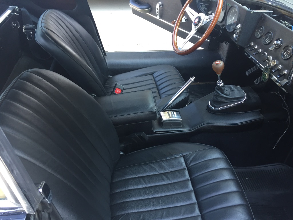

I'd have to agree with the above post. My '64 seats were replaced by my father years ago. The original seats offer little to no adjustments, and although they were correct for the car, they were just not very comfortable. Dad replaced them with '66 style seats. Much more comfortable and "user friendly". Unless you want to be 100% correct, stick with the seats you have.
Here is a pic of my seats.
