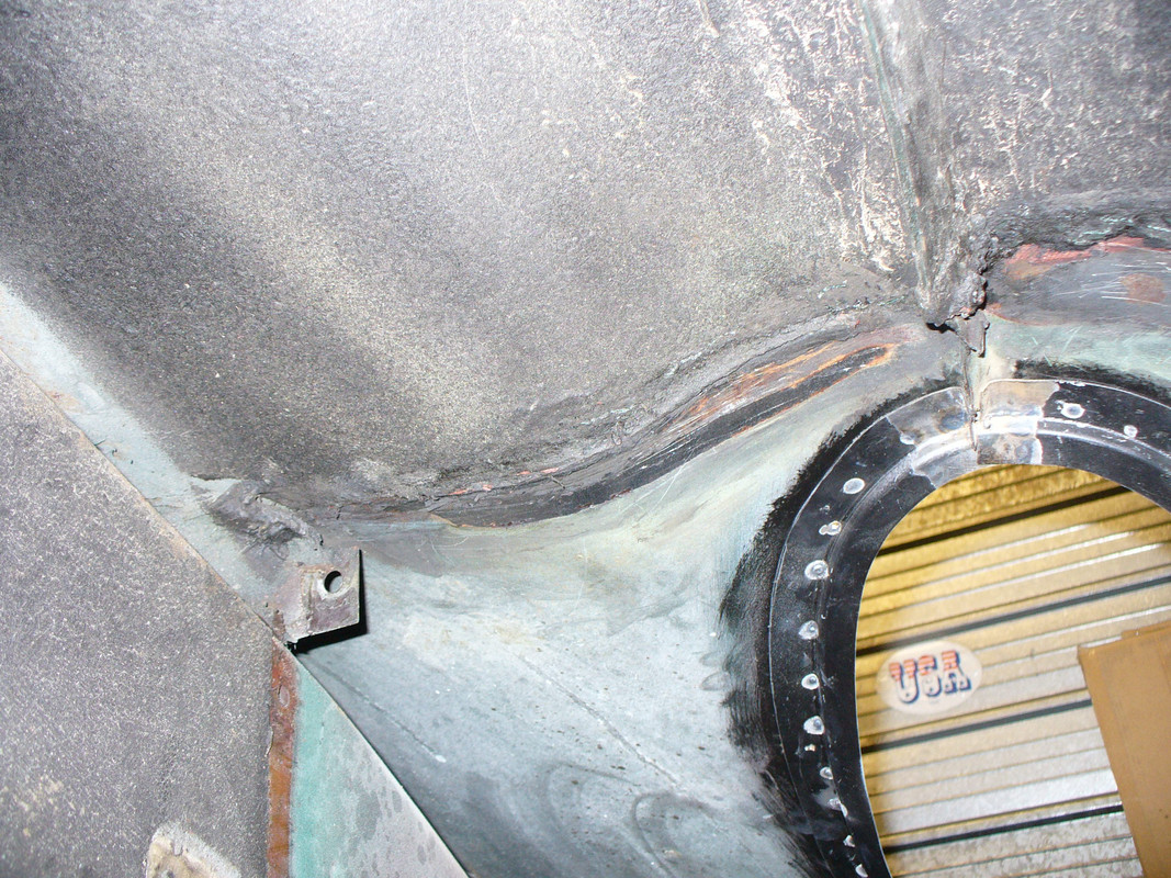

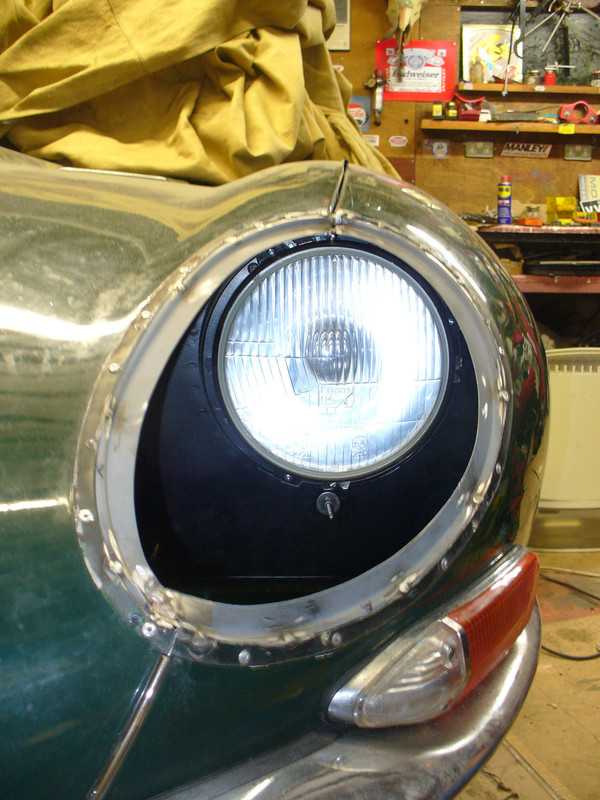

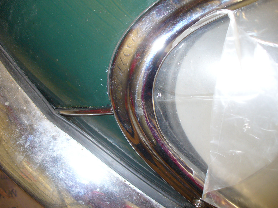

Updated post- Trial fit looks pretty good. and got away without damaging the surrounding paintwork.
I want to remove them for attaching the flanges but also want to tack the bottom lip of the 2 pieces together to stop water ingress but without closing the gap up. I may slide in a strip of metal to substitute for the fixing clips.
Thanks for the support and comments. Makes it a less solitary pastime

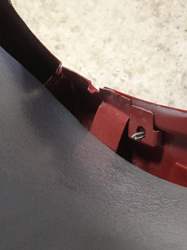

Not sure if this of any help. Took some pics yesterday that may be of interest . ( My part time job is restoring E-Types, currently working on four ) Appears to be a tab that just presses against the sugar scoop. There is no right angle lip under it. The scoop also seems to rest on the flange of the section you just cut out for the new chrome trim. This is the right side of a a 66 OTS

That is interesting. Do you find the same tab on all 4 cars? My car had no support bracket at all but had been through a front end accident and repair. I found a rectangular paint shadow on the sugar scoop in the same location as the L bracket shown in the picture I posted earlier. (Picture sent to me by a person with an pretty original 3.8). Possibly the support mechanism changed as production went on?

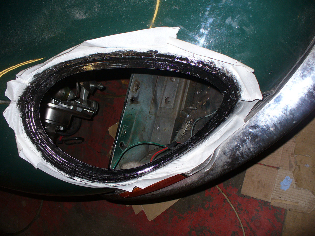

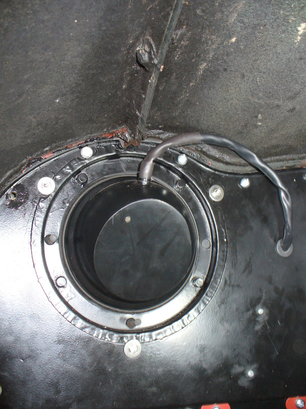

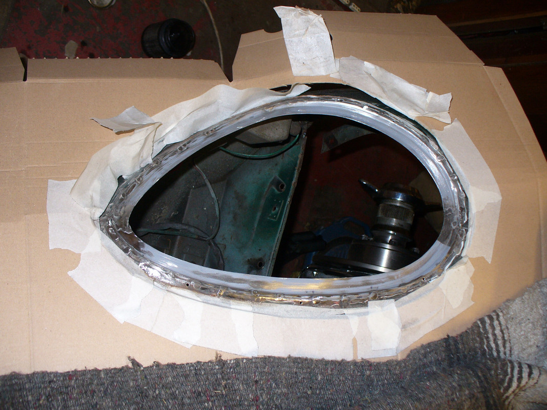

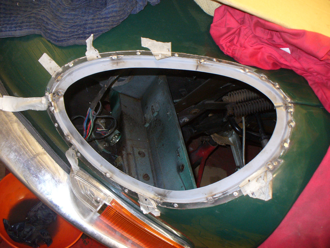

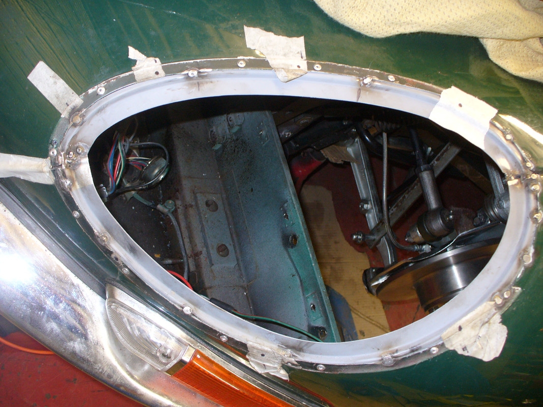

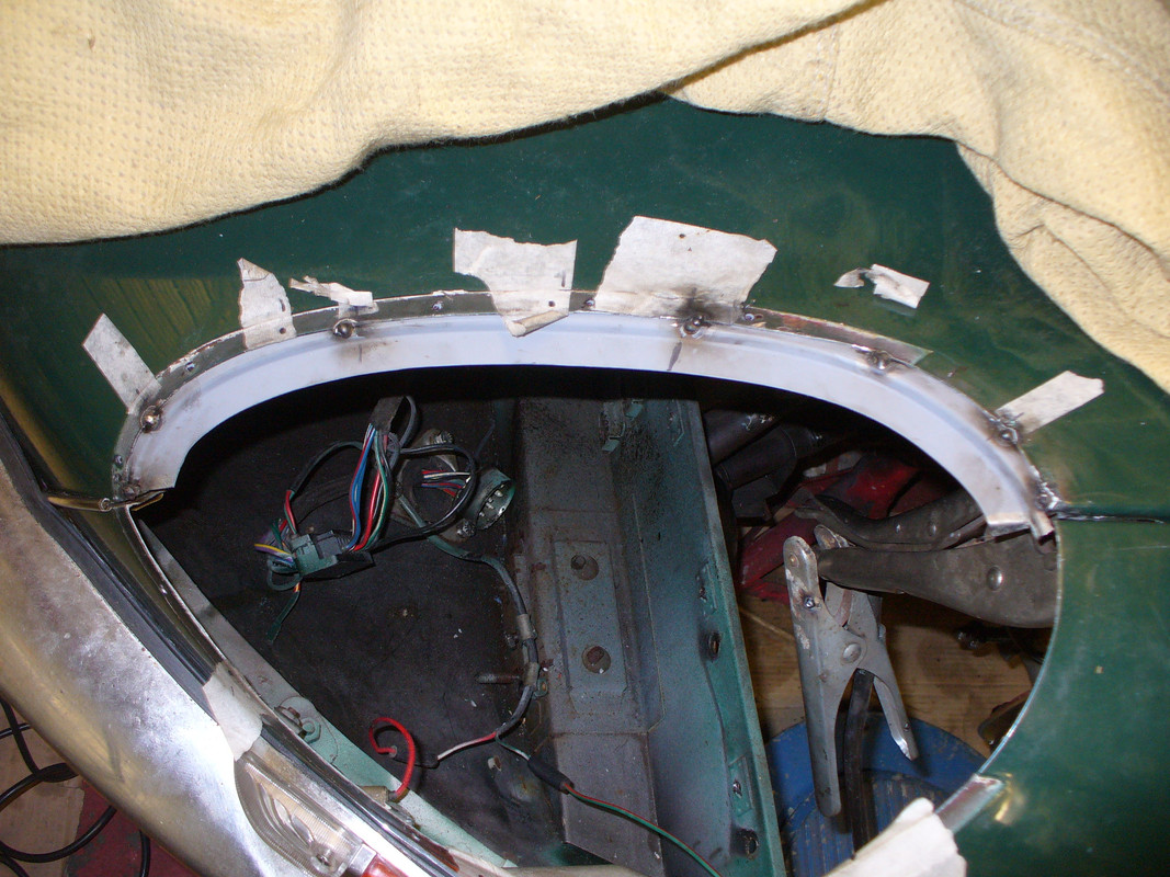

Updates on attaching the left side covered headlight flanges:
Mix of tacks and using the original rivet holes.
I was going to tack and then offer up the chrome surround before riveting but once the flanges were cut to fit and offered up there was pretty limited movement possible so just went for it.
I closed the gaps at the top and bottom hoping it will make them a bit more water tight. If the wing needed to come off its only 10 secs work with a cutting disc to slice them apart again.
Dressed down the welds. Checked the marks for the holes about 4 times then drilled them
The plexi is very flexible so no dramas tightening down the screws

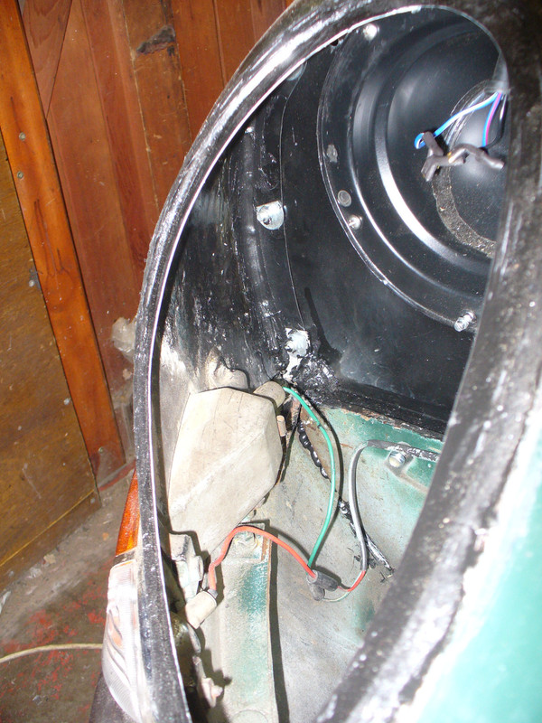

Trial fitted the headlight panel panel and wanted to fit the sugar scoop but timed out
I have fitted captive bolts to the panel for the sugar scoop (so I could move them around to get the best fit but I don't think there is enough clearance to slide the scoop in and clear the bolts.

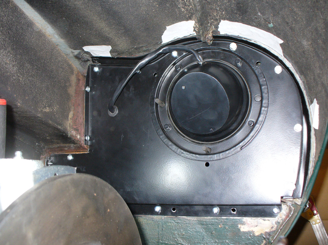

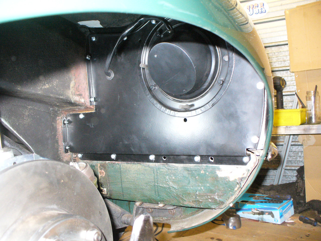

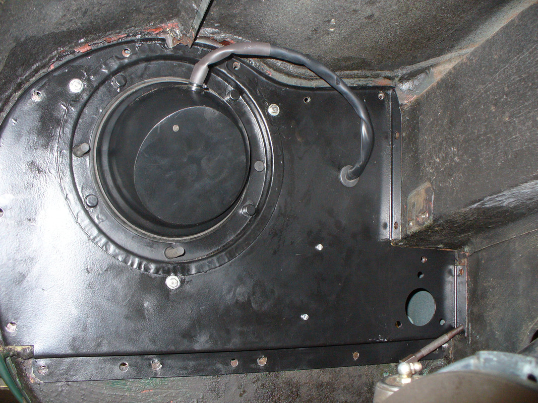

Offering up the headlight panel and trial fitting the sugar scoops.
Really struggling getting the scoops to fit with no gaps at the front.
The scoops have captive nuts welded on the three tabs. Just not working
I'll post images of the fixings later
All suggestions more than welcome.

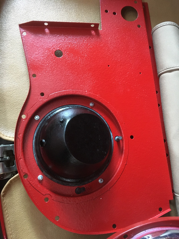

I have the conversion set but havent got to fitting it on the car !! I have attempted to fit [ bolt] the sugar scoops to the headlamp diaphragms using the welded captive nuts.
On both sides only two bolts really line up, and getting the third to line up is, either really really difficult [ and not really right]. and the other side the third hole doesnt really align at all ?? A mystery in the Quality dept perhaps ???
have you just checked for three hole aliagnment from scoop to diaphragm ?
doesnt the scoop to bonnet gap have a rubber sleeve or something that allows for a bit of tolerance in that interface ??

I have got it pretty close now. Down to about 1/2" gap at the very front. Sides now fine
I am using 10/32 bolts 1 1/4" long:
One each side of the back of the scoop fixed into captive nuts on the scoop
One bolt in the centre fixed to the headlight panel with a nylon insert nut so it can rotate and engage with the middle captive nut in the scoop.
This allows me to move the scoop back and forth on the centre bolt with a socket to close the gap at the front (sides are fine)
Now gone to 2" 10/32 bolts in the middle to hopefully close the remaining 1/2" gap.
I'll press on with this method and check out Chucks site if I am still getting issues.

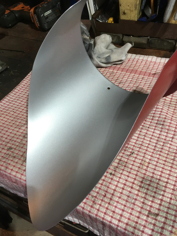

I am taking notes. Thanks for trouble shooting problems I will soon encounter and the great pics too. What paint did you use on the scoops?
Keith
Early 1967 S1 OTS, 1952 MG TD
eddiecross
Posts: 170
Location: Egham
#33 Re: Covered Headlight Conversion S1.25
Post by eddiecross » Wed Dec 15, 2021 10:53 pm
Hi there Keith,
I can't take any credit for that. Courtesy of a previous owner I picked them up from.

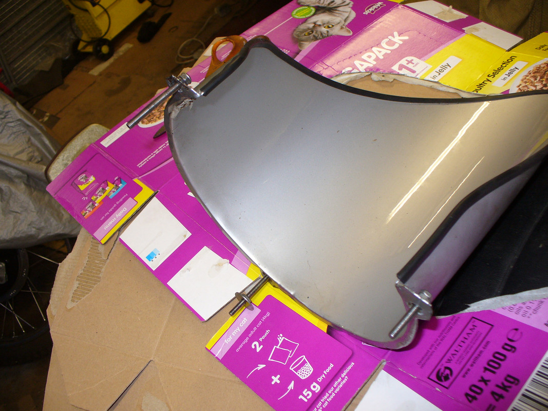

Now got the scoop in the correct position.
I attached 10/32 2" long bolts to the 3 fixings as there were already captive nuts fixed to the back of the scoop.
For the centre bolt, I added a nut and washer about 1" from the scoop flange to lock the scoop in place.
Landed it about right as there was previously a gap at the front- need a 2" bolt to get the scoop far enough forward.
Was then able to centre the scoop by tightening the other 2 bolts from behind the diaphram panel.
67 FHC

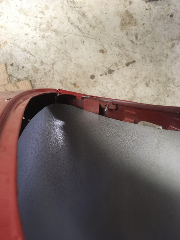

Here is where I am to date. Still waiting on parts, they appear to be " covid delayed"

#36 Re: Covered Headlight Conversion S1.25
Post by eddiecross » Thu Jan 20, 2022 8:49 pm
Hi there Keith,
Really simple in the end.
3x 10/32 2" long bolts in each of the 3 holes in the sugar scoop (which have captive nuts fixed to them) with the threads facing the headlight panel.
On the centre bolt I threaded a nut+penny washer about 3/4-1" away from the scoop (could use a spacer instead).
On the other two bolts I left without any spacers or nuts as you can put them in tension from side to side to centre the scoop.
Dropped in the scoop and I got lucky as the centre bolt spacing was bang on and the long threads made locating the three holes easier than with the shorter bolts.
The 1st couple of times fitting and removing the scoop is really tricky but by the 20th attempt you get the hang of it!

Align chrome bezel- bend to shape and mark outline and holes. The top 2 holes will probably have no metal to mark to- add a tab with masking tape.
Drill lower holes- use a smaller drill and screws than the final ones
Trim the new flanges to fit. I decided to join them at top and bottom so trimmed them so they overlapped. Top join helped close the wing gap
The top inner and outer flanges needed to be pulled out so the step was about 1/4" out at the top on mine.
This allowed drilling holes for the bezel that are on the outside of the step
Tack weld in a couple of places for trial fitting. Drill the 2 holes at the top. Again using smaller screws than final ones in case you need to move anything
As long as the bezel fits correctly and covers the rivet holes from the old headlamp scoop you should be ok.
I am using the plastic lenses which have plenty of give.
I used tack welds all round at about 2" centres with tape and soaked rags to protect the paint
