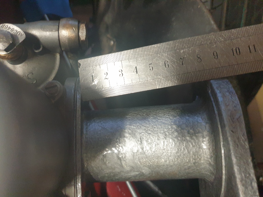

I am well into the restoration of my 1961 Flat Floor car and have come across the following
The bottom inlet hole in the air intake box on my 3.8L car is off center of the air filter canister by around 20mm. So it appears either the trumpet length is too long or, the inlet in the fibre-glass airbox is incorrected located
I am not sure if either the trumpet piece or the airbox item is original - so I guess it could be either in error and I need eliminate one of the two possibilities
Can I ask pls if someone with a 3.8L car can confirm the length of their trumpets. Pls note mine measure approx 80mm as per the pic attached
With the above information I hope to be able pin-point the problem to the trumpet length or dimensions of the airbox construction
Tony

Just checked mine, 80mm is corect and surprised to see that mine is also about 20mm off centre, but it doesn't seem to be a problem as the bellows like seal accommodates that easily.

thankyou for confirming the length of your trumpets -- is very interesting to note that your air intake is also 20mm off center -- is hard to imagine that Jaguar did not design this anomaly out overtime
I will order a new seal and assume this will accommodate the offset as you describe
( if I ever decide to address the offset I think I would move the inlet hole in the airbox 20mm closer to the trumpets as opposed to reducing the length of the trumpets )
Thanks again Randall and best regards for 2022

Thanks Carajas, do you have another name? On reflection one could possibly bend the bracket that attaches to the outer sill extension slightly outwards, that would tilt the top of the canaster away from the engine.
