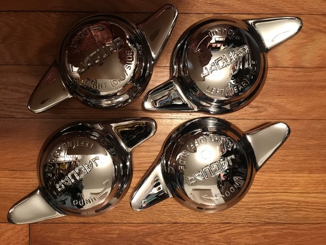

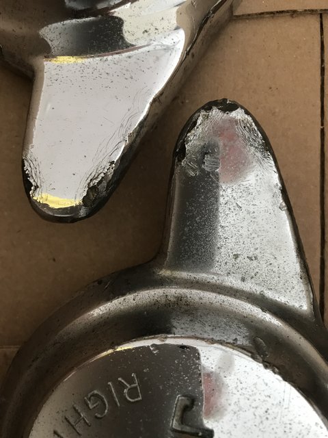

I recently had my set of original circa-1964 A-B spinners restored here in New Jersey for U.S. $80 each (not very helpful for those of you in Old Blighty, I know, but this may prove useful to the Yanks on this forum):
The name and address of the shop is:
MARA POLISHING & PLATING
105 W. PEDDIE ST.
NEWARK, NJ 07112
(973) 242-0800
maraplater105@verizon.net
They provided a quick turnaround and even gave me a price quote based on a detailed photo sent to them by email.
I was very happy with the results.
They also do aluminum polishing on things such as E-type cam covers.
Before:
After:
Alan
N.J.
