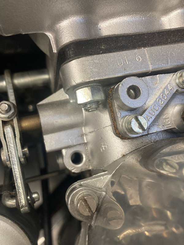

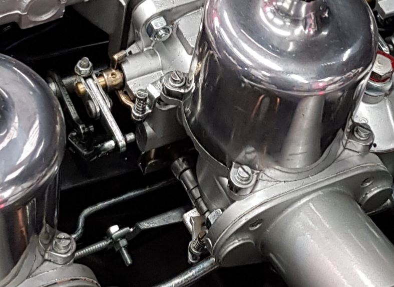

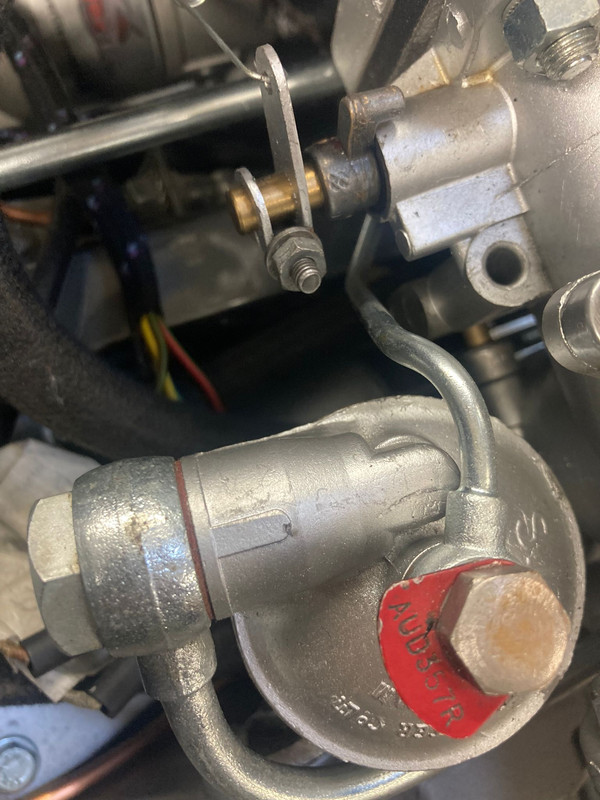

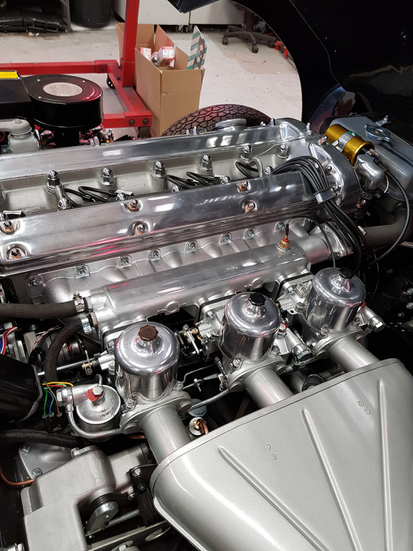

I discover today that the original etype carbs (I have in pics with their green tags) were swapped out (maybe to sell on who knows) for what appears to be XJ6 carburettors (the rear one has number AUD 357R) although maybe not all of them as one out of the 3 carbs has the fast idle adjuster the other two just the holes with no threads for the assembly (see image).
So the two main issues are; 1) the pots are taller, although I don't have any bonnet closing issues. 2) manual choke is only operating on one carb.
The parts for fast idle seem to be available although there is a question over the brass arm that attaches to the rod.
