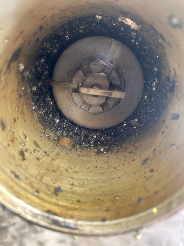

A FTP moment today.

Wow! That’s seen some serious heat!!

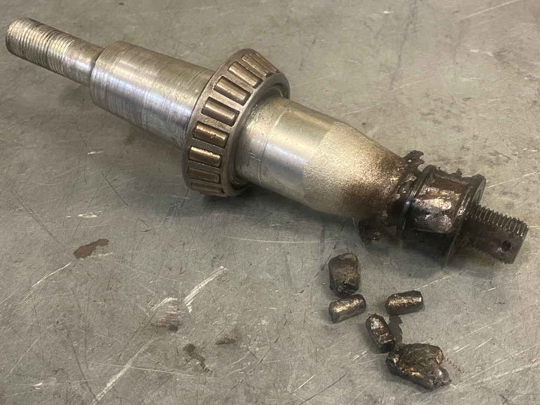

My car and fortunately I was driving it. No real noise, but noticed a vibration through the steering and then nasty grinding noises within a mile or so.
This car has only done 1200 miles since I did a ground up on it. Timkin bearing. I'm usually pretty generous with grease and I subscribe to your bearing tightness views as well.
It was an original stub axle and I wonder whether it was a bit worn and the bearing was able to spin and heat up, melt the grease and then run dry.
Anyway, new stub axle time.

Nothing wrong with standard setup used on every Jag until 1996. They only swapped to deep groove cartridge type ball bearings to cut servicing costs during warranty period and because tight tolerances were needed to prevent tram-lining once they started using 18” or bigger wheels. Many parts became ‘sealed for life’ but non-serviceable means expensive replacement and dealer fitting or special press and spanner tools for enthusiasts later.
Bearing spacers need careful shimming and are fine for rear hubs, or carrier lower fulcrums etc. with equal opposed bearings torqued tight. Easy to get wrong. Provided a correct D- hole washer is fitted over the D-section threads you have a stable front axle setup. The spacer system sold for fronts are for added stub axld stiffness I assume, but who here is going to claim they drive so hard they need stiffer axles like the two ton XJ?
Bearing fit is fine on the bigger inner race but is for looseness, not over tightness..

Follow up on this.
I replaced the stub axle and put in Timken bearings. Carefully set up so that the hubs spin freely (took out brake pads) and had a tiny but noticeable amount of rock on the disc.
I replaced the driver's side bearings as well. What was in there looked OK but was "no name" brand. I set it up the same as the LH.
Will see how it goes.
I'm not sure what went wrong, but I'm leaning towards user error.
When I built the car I built the front suspension and brakes on the bench and then (much later) mounted them onto the body when I got it. I don't recall checking the bearings again although I must have split pinned them at some time. I suspect I did them up too tight at assembly and didn't rectify this later.
