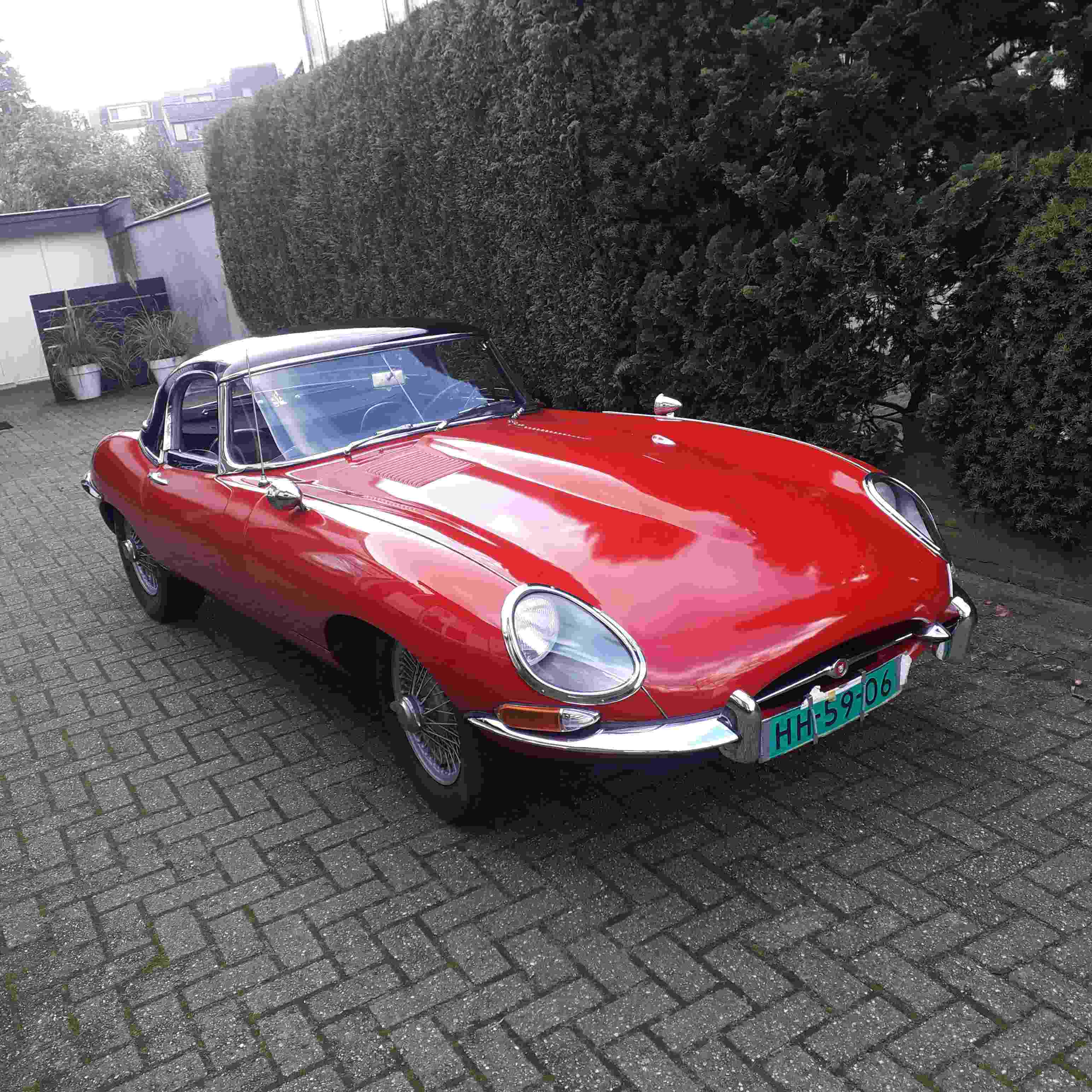

I just doubled down, adding to my stabble this early OTS that will join my 64 3.8 FHC (which is still being restored).
This OTS was manufactured and dispatched in Oct 61.
So, without being an OBL, it's still a very early car with welded louvres and stamped number bonnet, flat floor and straight rear bulkhead of course, and many other distinctive features such as "double" boot hinges, three-post throttle linkage, etc.
I still have to identify all these peculiarities.
More importantly for me, it looks to be a very well preserved matching numbers car, albeit with unconfirmed history and unknown first owner (as per the Jaguar Heritage certificate), with apparently (looking at the insurance receipts) only one single owner in dry California from at least 1967 until 2017 when he passed away.
Bought then and recommissioned by a NL E-Type's dealer for his personal use until he accepted to sell it to me.
The car seems to be nearly unmolested, having apparently kept all its original body panels and looking totally rust free.
The body was resprayed probably in the 90's (paint still holding very well), all body seals are new, and some elements of the interior trim (leather of the seats, carpets) look so good that they have probably been also refurbished in the past, while some others like the tired flat dash top obviously look original.
Very nice patina overall!
Mechanically speaking, the car was still in great original condition to start from, and was recommissionned extensively by the seller, in particular: new fuel tank, rebuilt carbs, ignition and electricity, overhauling of braking, clutch, steering and cooling systems, filters, hoses, belts and rubbers.
The engine compressions are good and the car rides now smoothly with no visible issues.
The only significant departures from the original equipment look to be the replacement of the original electical generator by a modern look-alike alternator with an associated conversion to negative ground, and the loss of some original components and replacement by non original parts, notably the radiator and filler tank, the bonnet frame, the original Dunlop callipers, and the plugs conduit.
As a bonus, a complete factory hardop (including all the original chromes and latches) was part of the deal, although with some fitting issues maybe due to S2 toggles instead of S1's (I'l make a specific thread on that issue).
I hope to register that nice OTS soon to enjoy driving it when Spring comes.

#3 Re: 61 OTS in the stable
Very nice Serge
.....Steve
- Posts: 3848
#4 Re: 61 OTS in the stable
Well done Serge, do tell us more about the car as you discover new details. More importantly, enjoy driving the car.
#5 Re: 61 OTS in the stable
Nice car.
Barrie
Barrie
#6 Re: 61 OTS in the stable
Beautiful car! You’re a very lucky guy to acquire such a rare and important car.

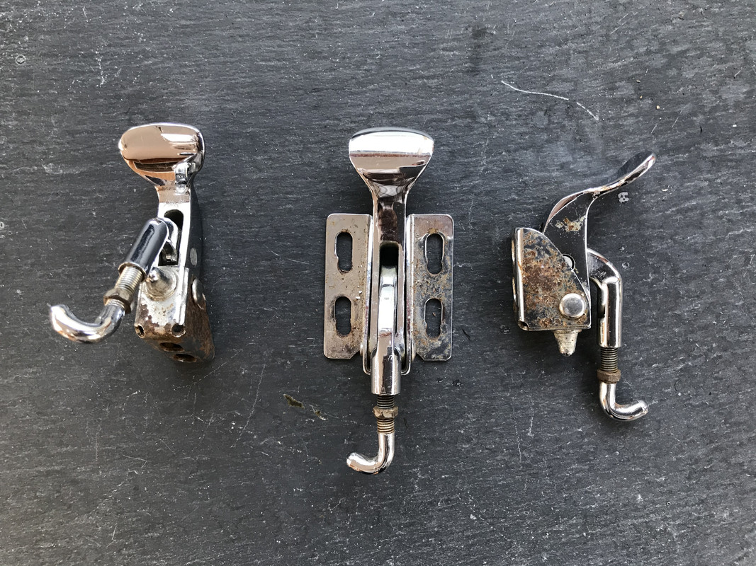

If you decide to replace those Series 2 toggles with proper Series 1 toggles I have a set of originals off a ‘64 OTS…they need a rechrome but they’re yours for $100 plus shipping from the USA.

#7 Re: 61 OTS in the stable
Alan, thank you for your offer.
I had just posted a description of my issue on a thread of Jaglovers as that issue seemed to be described, albeit not fully clear to me:
https://forums.jag-lovers.com/t/another ... /416757/62
Please have a look.
Do you think that the different design of the toggles is the reason of why I can't properly fit the hardtop?
If so I am interested and I will liaise with you by MP

#8 Re: 61 OTS in the stable
Bravo Serge, well done!
OTS require quite some fiddling for the optimal fit of soft and hard tops. There are many adjustments to play with, you need a long breath...
Also, the seals shape/quality/positioning play a very important role.
As for the toggles, my experience showed both models work.
