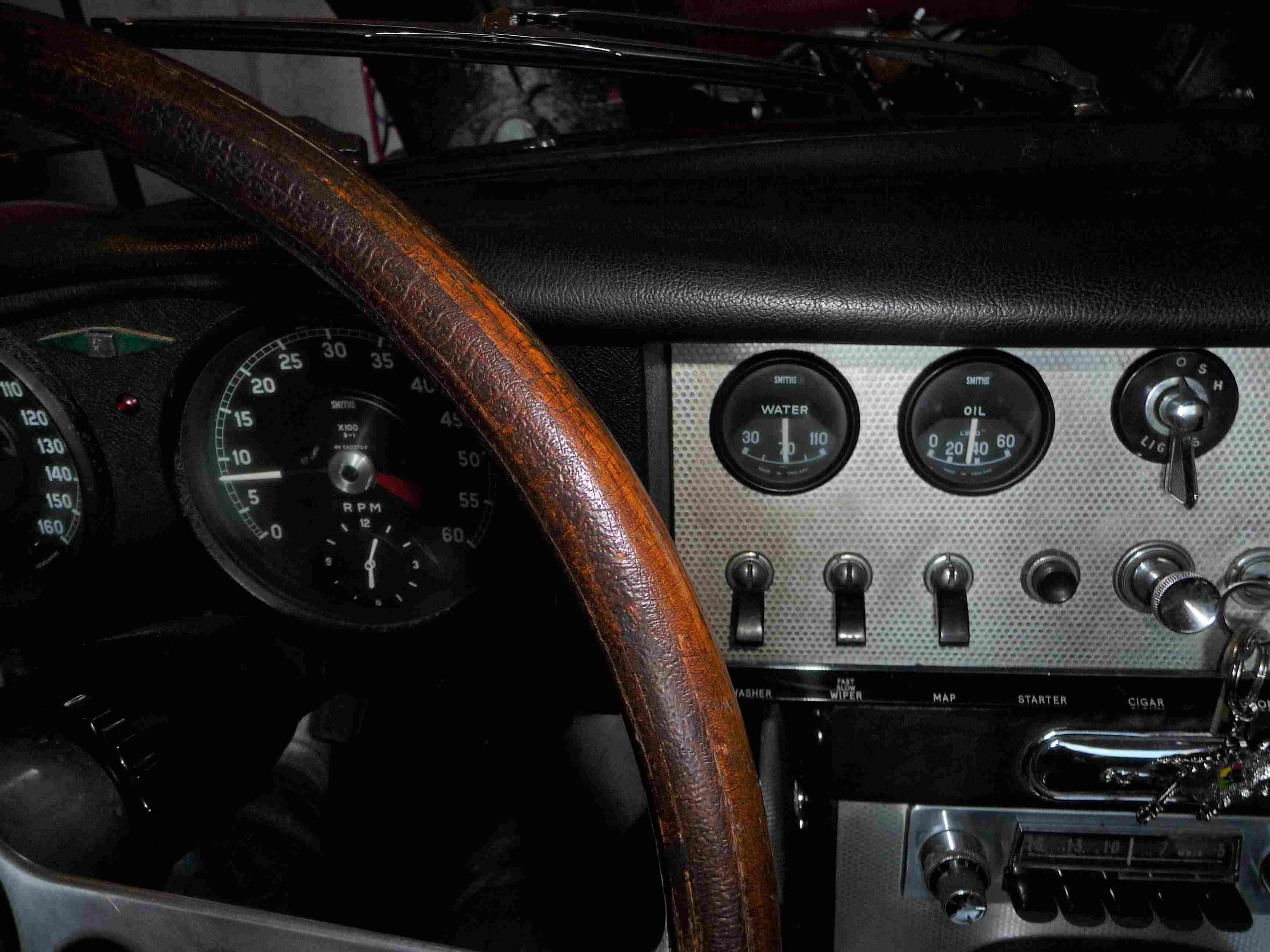

Did a static test of the engine to check my oil pressure issue.
The gauge indication on cold start rises to about 35 psi at idle (about 800 rpm).
When water has warmed to about 70°C, there is no significant decrease in the oil pressure as shown by the gauge:
P1240719 (2).jpg (244.15 KiB) Viewed 9189 times
I know that with such a short test, it's still far from having warmed the oil (I could not continue my test, an upset lady came to tell me that I was making noise...).
But it seems to me at least that the engine does not suffer from worn crankshaft bearings.
Next time I will make a road test again.
If the pressure reading decreases again, it will be time for the sending unit replacement.

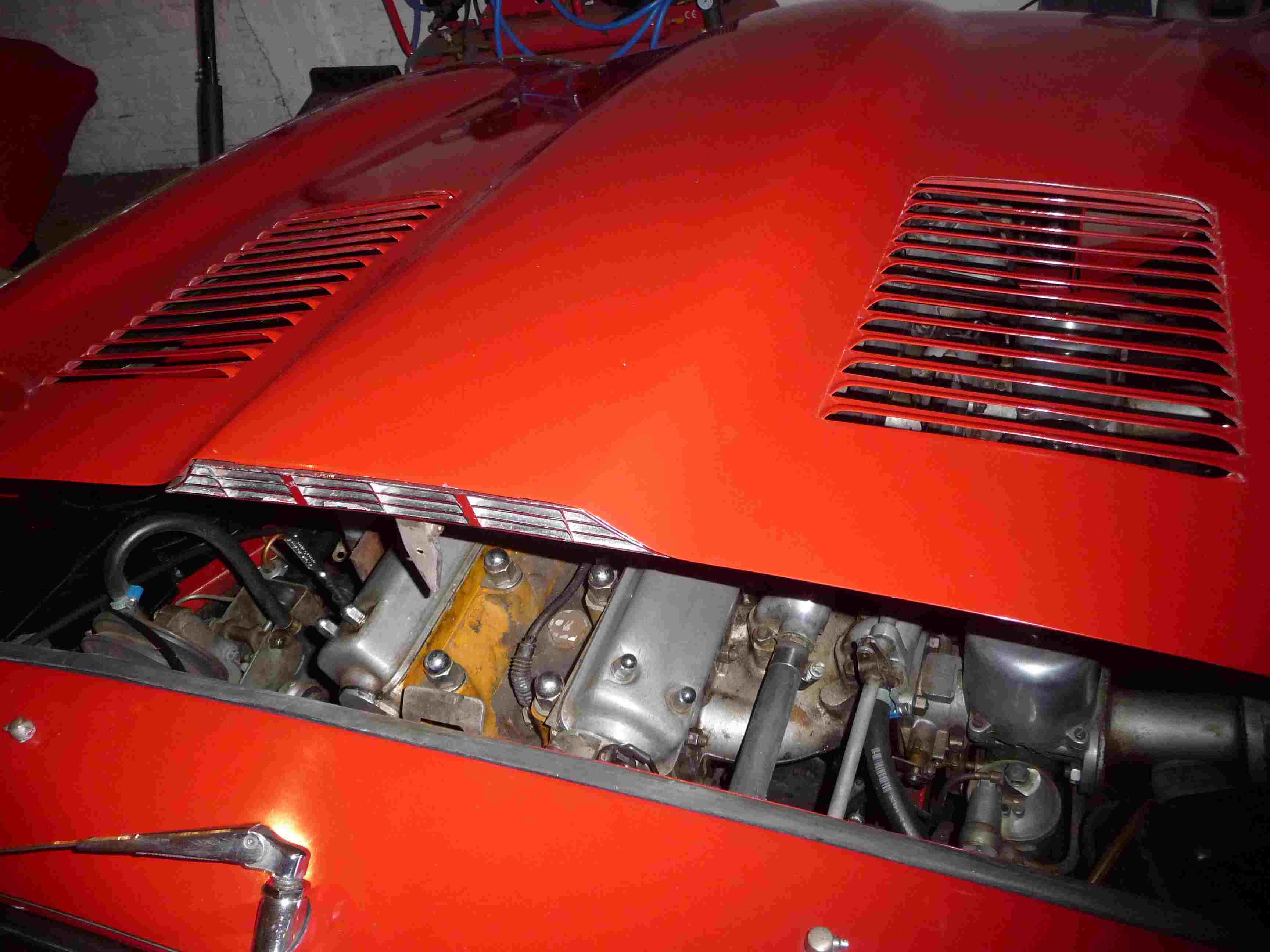

In the meantime, a few shots of additional specific features of this early car, starting with the bonnet
Smaller bonnet mouth:
P1240526 (3)_LI.jpg (238.26 KiB) Viewed 9189 times
Stamped body number on the bonnet:

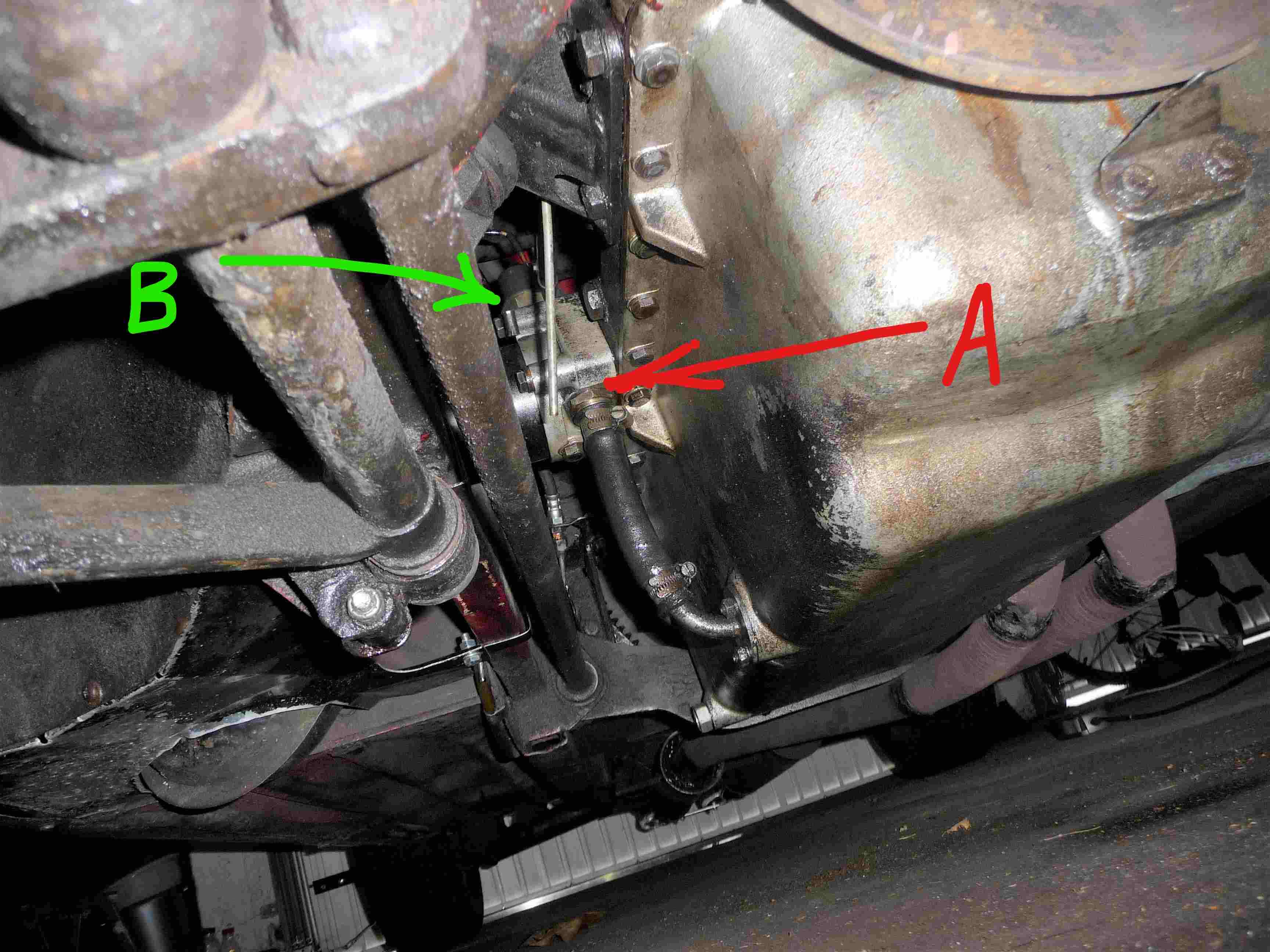

I have made other drive tests and the lowering of oil pressure when engine hot is confirmed: around 20 psi when running and 5 psi at idle.
For the time being, I see the following possibilities:
- a defective OP sender unit (but why only when oil is hot?);
- a leaking pressure release valve on the oil filter housing (increasing with hot, thinned, oil);
- an oil leak (gasket? crack?) internal to the filter housing;
- a tired oil pump that could not ensure flow/pressure of a thinning oil; or
- tired bearings in the crankshaft assembly with a limited wedge pressure with hot oil (worst case scenario).
My intent is to proceed step by step, from the easiest to the hardest.
First would be to check the pressure release valve, see if there might be a debris (or a tired return spring) that would keep the valve slightly open with then an increasing direct oil flow back to the sump when the oil is thinning, hence decreasing the OP.
I understand that I should disassembly the valve from the oil filter housing (A, in the picture) after having removed the return hose to the sump.
Could that be done in-situ, without removing the oil filter housing from the block? (seems that it is a 27 mm spanner but I have no lift and access is limited...)
P1240480 (2)_LI.jpg (217.95 KiB) Viewed 8867 times
If nothing wrong regarding the valve, next step would be to check the OP with a mechanical OP gauge or with another electrical sender unit after having removed the current sender unit (B, in the picture).
Again is the unscrewing easy in-situ after having removed the air filter and should I replace any seal there?
Thanks for your advices.

Hi Serge...in my opinion your first and easiest test is to connect a mechanicsl guage and see what you actual pressure is.....befor you start taking things apart..Steve
#20 Re: 61 OTS in the stable
Posted: Fri Mar 11, 2022 12:08 pm
by paydase
Thank you Steve.
If I do not remove the sender unit, where is the most convenient place to connect a mechanical gauge?
