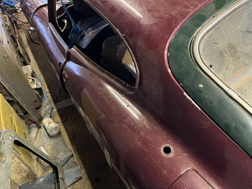

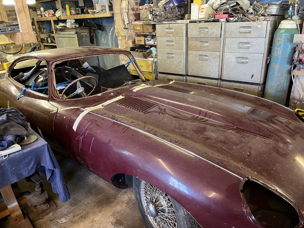

I have just been given the opportunity to purchase a 3.8 FHC which has been stored in a garage for the last 30 odd years. It won't surprise anyone that it will need a complete body and mechanical rebuild.

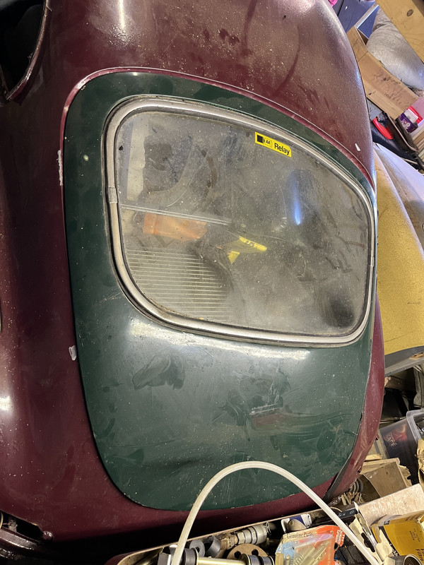

It has been fitted with a replacement bonnet and tailgate. The car has been off the road ever since the previous(now deceased owner) drove it off the road and through a stone wall. The original mangled bonnet is hanging from the rafters.
The bodywork is solid and does not appear to be to rusty. The picture frames look in reasonable nick and all the engine ancillaries are present
The interior, glass and chrome work have all been removed ready for a planned restoration that sadly never happened. It's missing it's underbonnet commissioning plate and there wasn't enough room to check inside.
The original bonnet still has the reg number which dates it before the start of the 'A' suffix plate. So pre August 1963.
My question is assuming that all parts are still present what should I offer. It belongs to a friends family so I want to give them a fair price if I decide to buy it. I thought around £30k

Thanks for the replies. My friend who is also a neighbour is going to dig out all the details including the V5. The car has been in his wife's family for three generations possibly back to when it was new. It belongs to a family of lawyers so I doubt it's dodgy but caveat emptor as they say.
I intend to thoroughly inspect the car before going any further, which includes blowing the tyres up and rolling it out of the garage. I wasn't able to check if the gearbox is still the original Moss unit since the interior is full of dismantled parts.
I intend to make a list of missing parts and tick them off as I find them.
Good point about the frames Christopher, they seem straight but I'll have to take some measurements to see if they are buckled in any way. Worst case scenario would be replacements.
I suspect they may already have been replaced. However the passenger door seems to have an alignment problem but that may be because it's a replacement due to the accident.
The garage is large enough to hold six or seven cars. Other residents include an MGA bodyshell, Armstrong Siddeley saloon, Austin Seven Chummy and various BSA motorbikes-a real Aladdin's cave. My neighbour has already bagged an Austin Seven boat tail special. I also have first dibs on the oxy-acetylene and a large 200l capacity compressor.

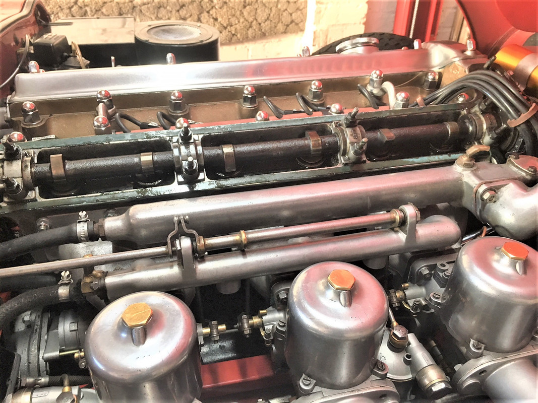

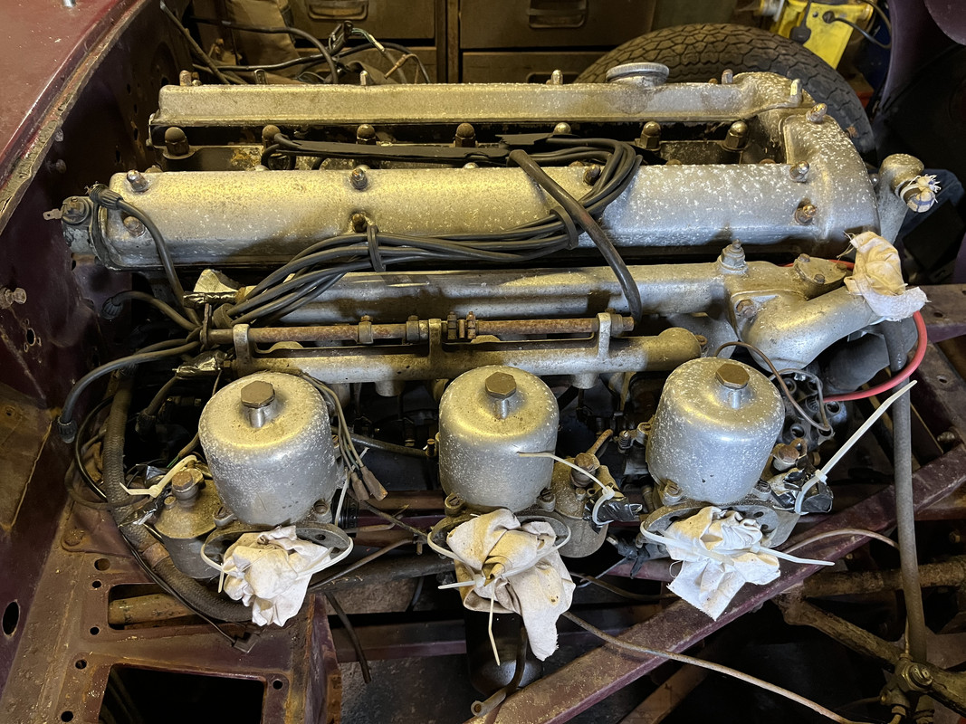

It has the early carb linkage assembly and therewith is a Flatfloor if original. Even an early one....
If so, the car is worth more than 30k depending on matching no, VIN/car no., originality of other deteils and parts...

#17 Re: S1 3.8 FHC
Post by tinworm » Sun Apr 24, 2022 11:38 am
Early linkage - throttle arms are bolted rather than welded - so a '61 feature similar to XK150 linkage (but not the same)

Barrie
I have an OTS flat floor built in November 1961 and the linkage mount is different from this car's:-
Does this mean it was built between March and November 1961 then?
If true then the cross hatched alloy dash should not be on this car.

Post by tinworm » Sun Apr 24, 2022 8:13 pm
Hello Alan from engine R2933 I believe - was the change to the simplified linkage (from the multipiece type) At the same time the air balance casting was changed to accommodate ( 2 lugs instead of 3)
