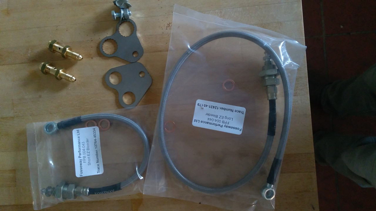

Hi here is a photo of the Fosseway kit I installed yesterday on the IRS for my 1971 Series 3 E Type. Same kit as for the Series 1 cars. I’ve kept the original Girling calipers on this one.

I am following this thread as I purchased a Fosseway remote bleed kit last year and had reservations about fitting it so have been putting it off. Due to access with IRS in place, there is mention of releasing the dampers for access. Is this straight forward? As once I start the job I will need to complete it. Also going to replace the 20year old rubber flexi with a stainless braided flexi at the same time. I thought I would entrust my local garage to fit it as they have an the advantage of a ramp. But they are not interested as not standard parts I can only assume.
The issue with sealing on a cast unmachined surface i.e the top of the caliper has now been addressed with the Fosseway kit as it includes the brass adaptors and 2 copper washers for the banjos, also it does have easy bleeds on the ends. See photo of kit contents and instructions.

Thanks. Nice pictures. That answers the question on the the slave cylinder fitting.
Fosseway looks like the only kit that has the benefit of sealing on the bleed valve seat as per original and the ease of the banjo connection combined.
Looks like the best kit between SNG, Moss, Terrys to me. I’ll be in contaact with them.
