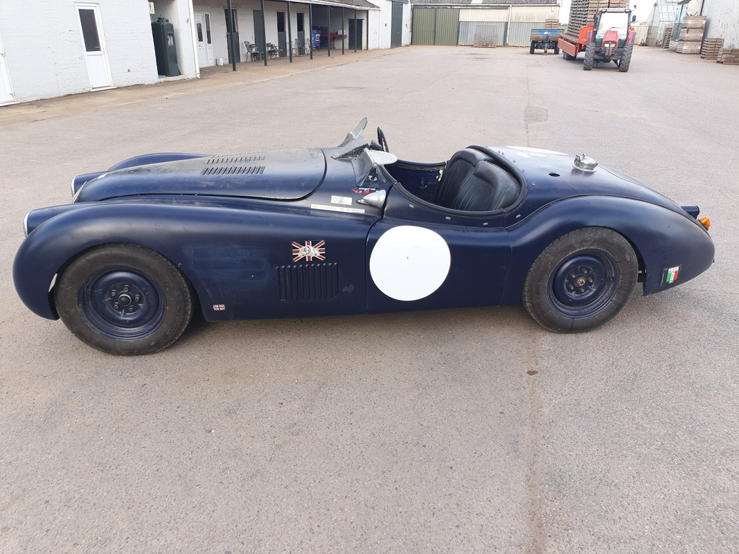

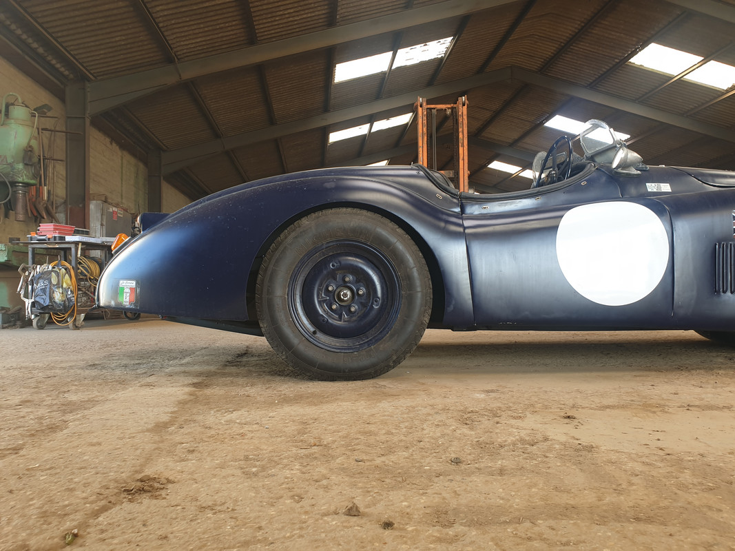

I can't comment on the Pirellis but, I have 205/70 Blockleys on mine, and have for four or five years. They are V or W rated and suit my rims (6 inch, as I recall). I don't have any issues with use and they don't tramline plus the steering effort is not unduly high. I used to have 185 tyres on original width wheels but prefer the wider wheels and tyres combination - I've switched between configurations about every five years and think I'm settled on these after 20 years. I understand that Blockley offer a refund if the tyres are not as good as they claim.
I've run different tyres on my car's from R5s on my XK120 (now sold) to Avon's, Pirellis and other types. The Blockley tyres are easy to live with, have good feel and grip plus, I feel, suit my S1 well. I liked the R5 setup on my 120 but they were awful when cold - I have never used them on the E as they used to be H rated - anyway, they are not the tyre size you are considering.
I wouldn't fit 205 on 5 inch wheels as they balloon too much and would probably lead to unpredictable handling.
