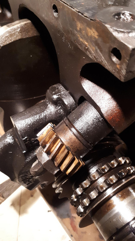

I was lucky to be able to buy an early 3.8 E type engine (matching cylinder block, cylinder head, flywheel etc.) with smooth sump. Engine is in good condition but will be overhauled anyway, dismantling nearly done but facing problems with removal of distributor drive gear. Lock washer tapped back but unable to release the nut.
Assume standard "right" thread.
I don't want to apply to much force as I am afraid that I am overlooking something.....
All tips and advice welcome !!

Standard thread.....buy typically Very tight.....you may need a long bar and the courage to use it.....worth rigging a way to hold the other end of the shaft ....or an oxy torch on the nut.....Steve

Put a ring spanner on the nut.
Secure the square section with a spanner. I have welded an oil pump connector to a foot long piece of bar to hold this.
Undo it.
It shouldn't present too much of a problem.

Once I "blocked" the gear shaft it was just two taps with a relative heavy bronze bar on the spanner to release the nut. Crankshaft came out for inspection and seems to be in good shape.
