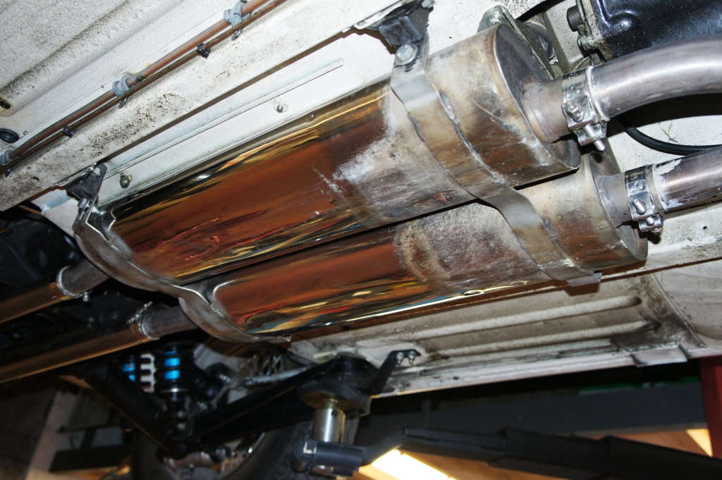

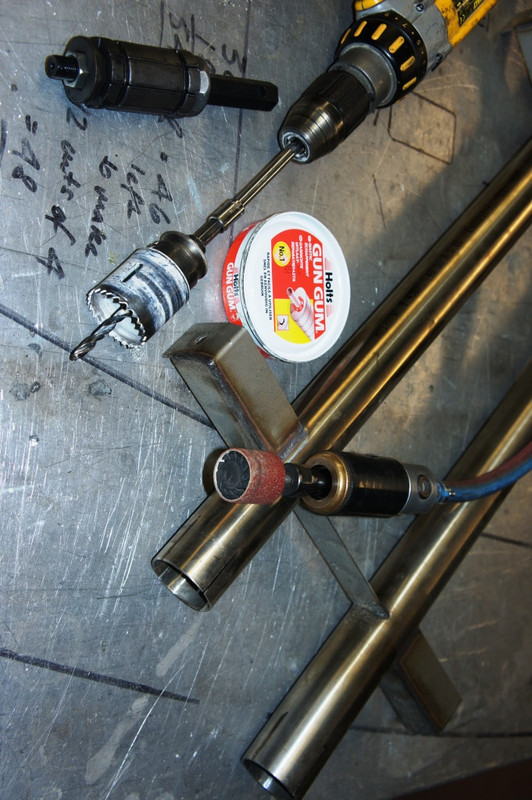

but no amount of searching throws up the the post I made maybe 10+ years ago about trying straight-through pipes, and then reverting to modifying the original silencers, so here are the pictures again.
I did make some straight-through pipes (see above) to replace the original Bell centre silencers, but as I said at the time it was undriveably noisy.
(I think it's a Bell system - can anyone confirm the identity ? bear in mind it is circa 1990.)

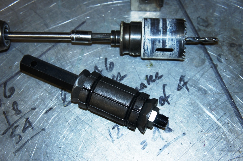

So I examined the silencers and established that there was a promising diaphragm "wall" at the front end, just at the end of the entry passage.
Armed with a Bosch hole-cutter (can't remember the size but easily available) and a suitable extension (ashamed to see now that it was just a socket-drive) I managed to pop a hole through said diaphragm, which was a single thickness stainless baffle, resulting in you being able to see straight through the silencer from start to finish.
I feared this would equate to "straight-through" and make too much of a racket, but in point of fact the sound is every bit as what we call "feutré" (from feutre = felt, as in hat-material) or discreet as before, most of the time, but gives just the right edge to the sound when you cane it a bit.
Above all it does not detract from the cruising experience.
It's got to be the best free-modification I ever undertook on the car.
Question ; I've got stainless resonators, do I conclude from the above discussions that Moss are the best source of chromed-steel resonators, rather than Jaguar ? The Moss price now looks like £600 a pair, and are said to be Genuine Jaguar.
