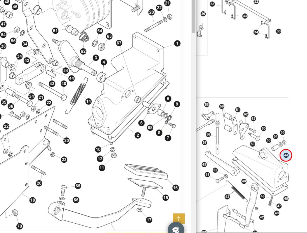

Remember I have not taken this car apart and never worked on an E-Type before. :helpsign:
All parts are blasted and painted and wear parts replaced, so...
1. What goes in first, accelerator housing with steering rack, or brake-clutch housing? Or does it not matter?
2. Accelerator housing, I would install it with steering rack already through hole?
3. My biggest puzzle, and a local guy has kinda tried to explain it to me, but I didn't understand it :-). Just looking at it, I would guess to install pedals and axis (#3) before assembly with #18 plate, and then put it all on car. But how do I ensure that the brake pedal (when at rest) is at the right height from the firewall? Axis #3 has to be exact in the correct angle compared to pedal, and the teeth/splines do not enable movement without pulling the axis #3 out first? Or? If I had taken this car apart, I would (hopefully) have marked the axis and pedal so I could see how to install...
What am I missing? Is there a solid procedure for this? Or is it trial and error? And what's perfect brake pedal height, how is it measured?

You should be able to assemble the whole thing minus the pedal pads and install it from above.
You can adjust the splined brake pedal with the assembly installed by undoing the pinch bolt and opening the splines with a big screwdriver or a chisel while lying in the footwell.
From (distant) memory, the position of the clutch pedal is controlled by the master cylinder push rod.
The only way you could adjust it is to either alter the rod length or shim the master cylinder.
It's been a while since I installed a 3.8 pedal box but I don't remember having any problems.

Thanks Andrew. I would worry about opening up the splines, that I would break it in two?

It's steel so It's pretty tough; I haven't broken one yet.
Have a trial run with it on the bench.
