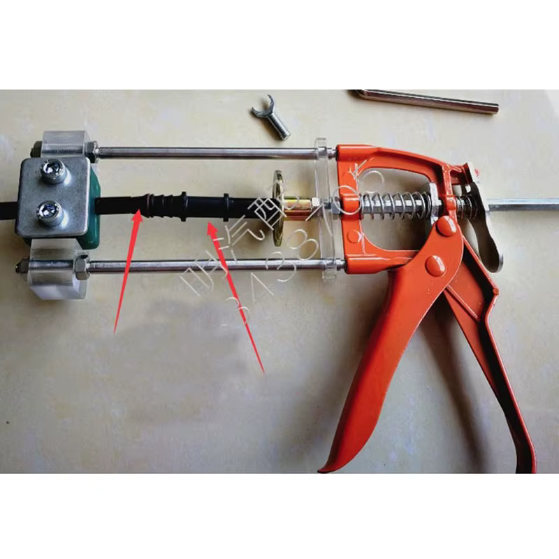

In case it's helpful - when I made up replacements for my fuel lines, I pressed the barbed fitting into the tube without heat. Having seen the method online, I used a standard caulking gun, with part of an old flaring tool to clamp the pipe, and squeezed the fittings in by pulling the trigger. Worked a treat.
Of course, I didn't take any pictures of my system, but it seems you can actually buy a tool that does the same thing, if you don't enjoy the Heath Robinson approach
