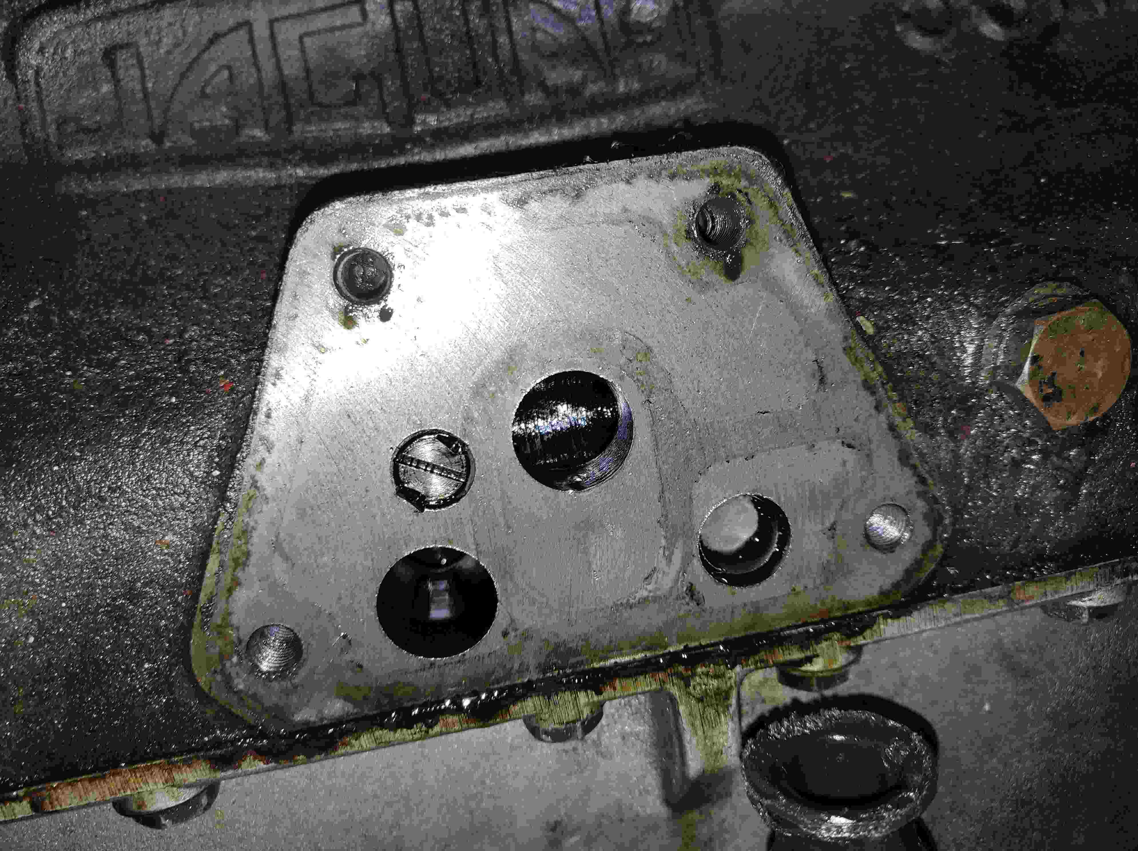

The trace of the filter housing seal can be seen on the block. The holes correspond to the usual configuration:

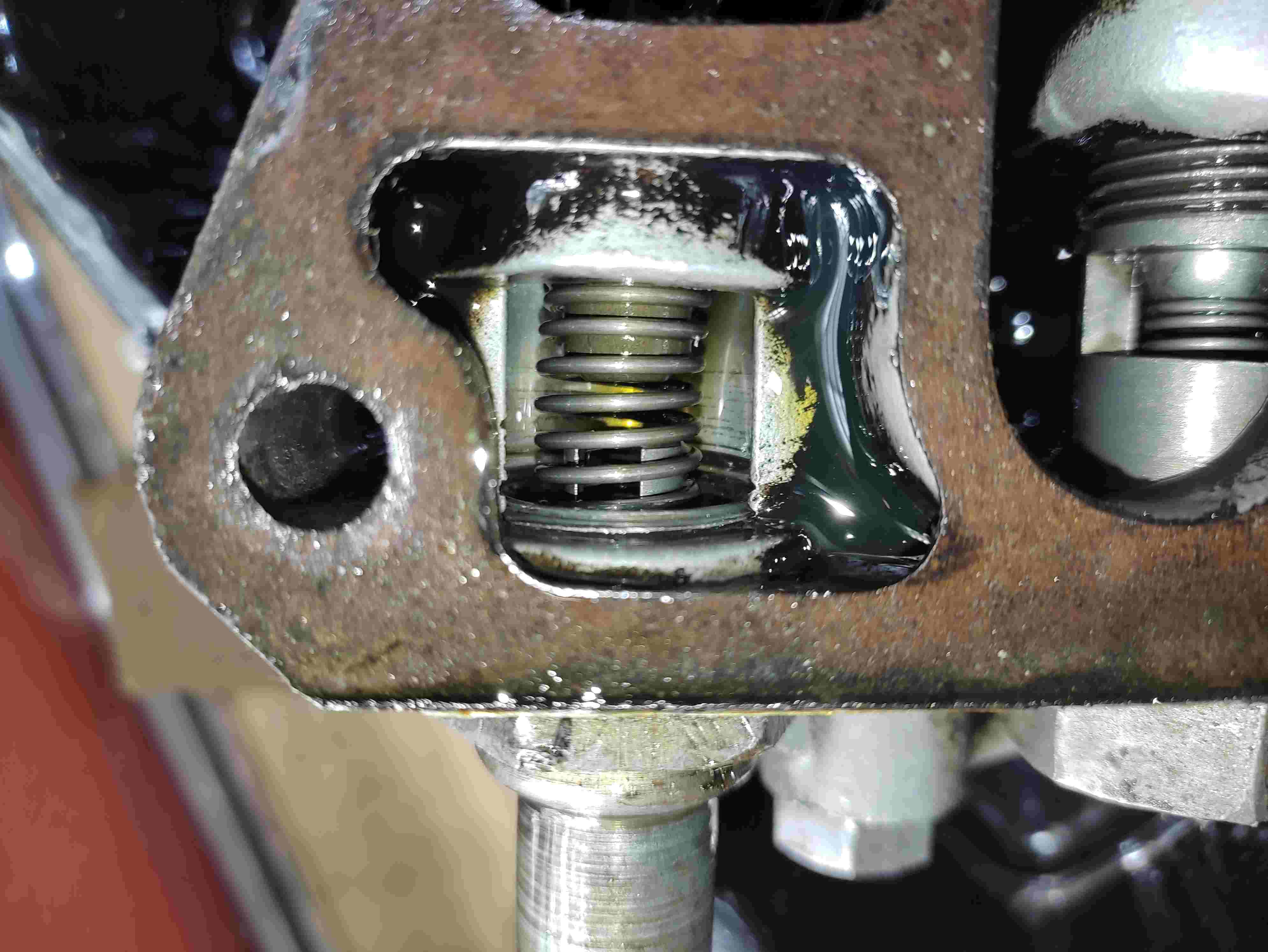

On the other side, the seal remained stuck to the filter housing.

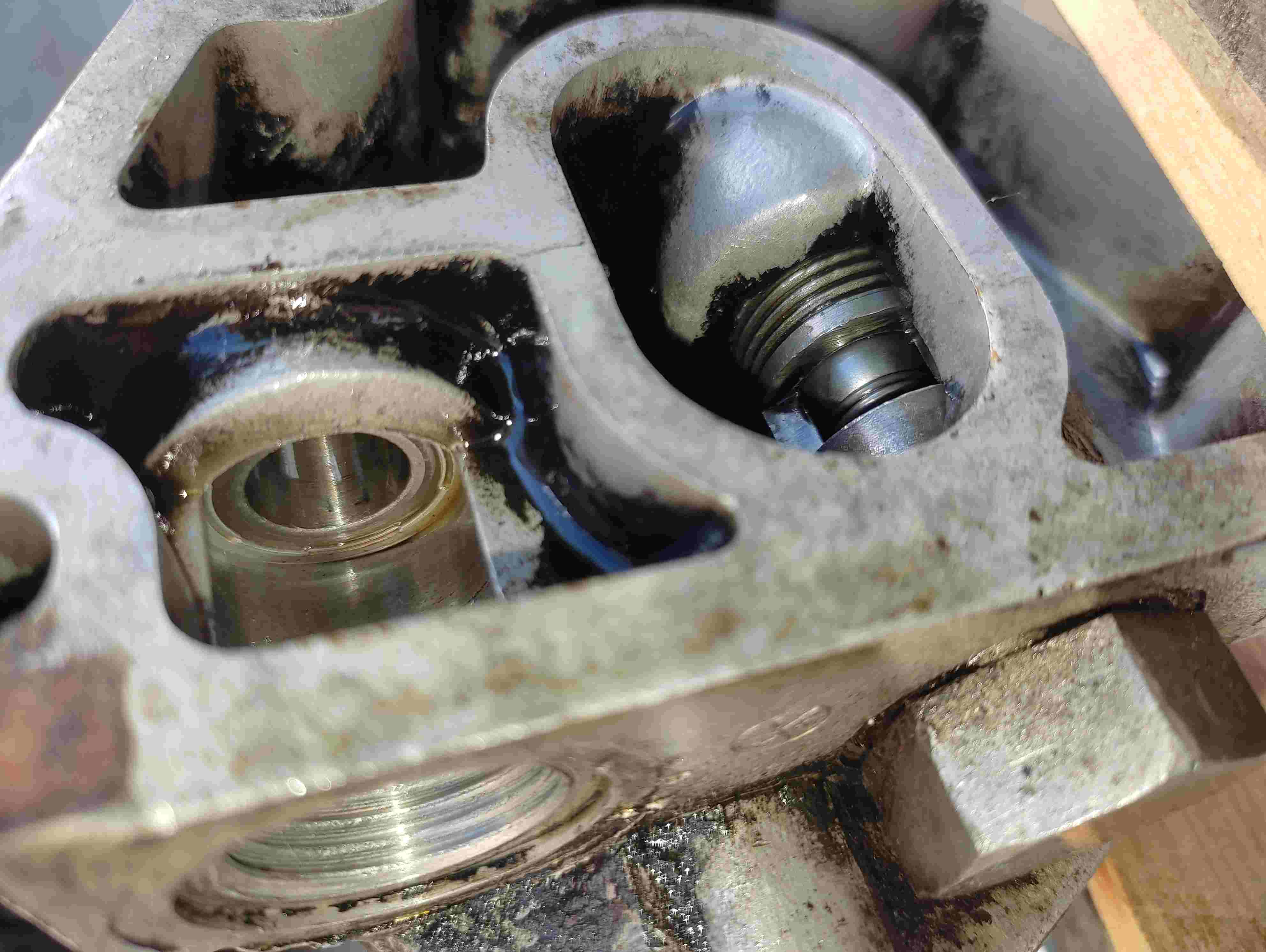

A close view shows the assembly of the OPRV inside the casing:
IMG_20220827_110128 (2).jpg (223.05 KiB) Viewed 11793 times
One can observe that the spring seems to be "leaning" a bit on the top right, not fully straight, as if it were slightly bent.

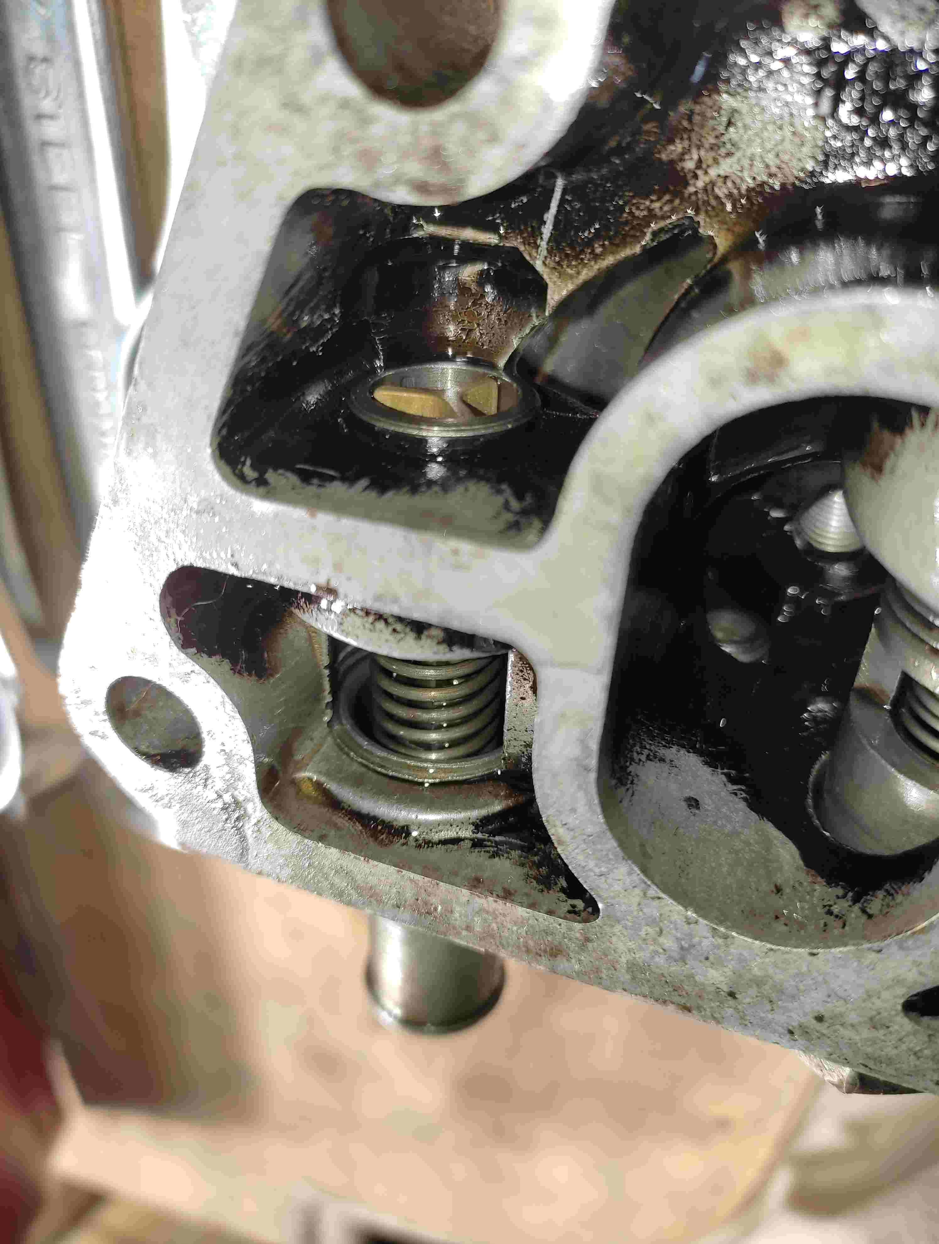

Another view from above shows the top of the brass valve:
IMG_20220827_112605 (2).jpg (220.36 KiB) Viewed 11793 times

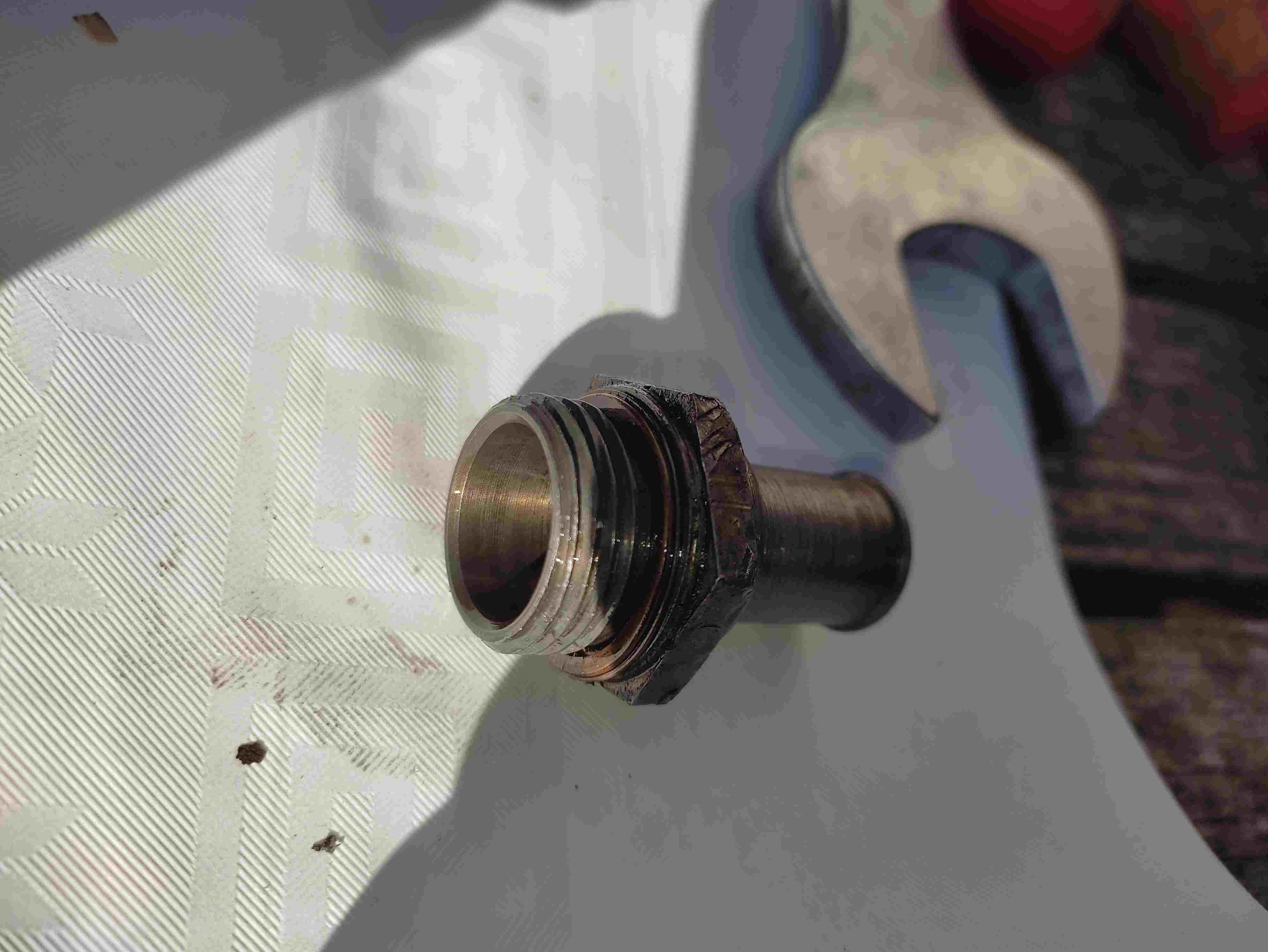

Looking closely, it seems that there are slight markings on the inside of the bore, between the fins of the valve. Maybe an artefact...

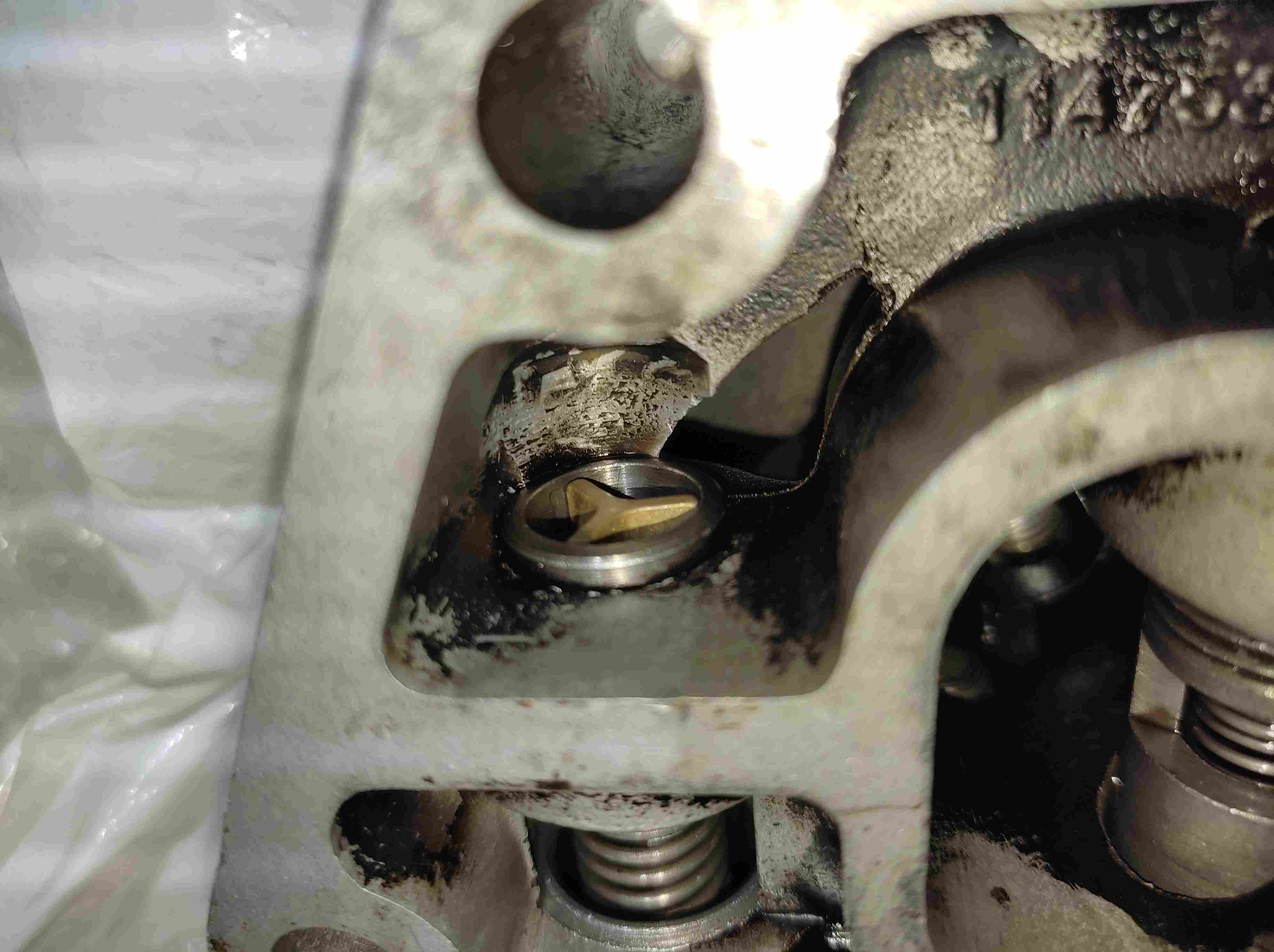

The view from below shows the seat upon which comes the base of the valve:
IMG_20220828_171625 (2).jpg (220.12 KiB) Viewed 11793 times
No visible damage at first sight.

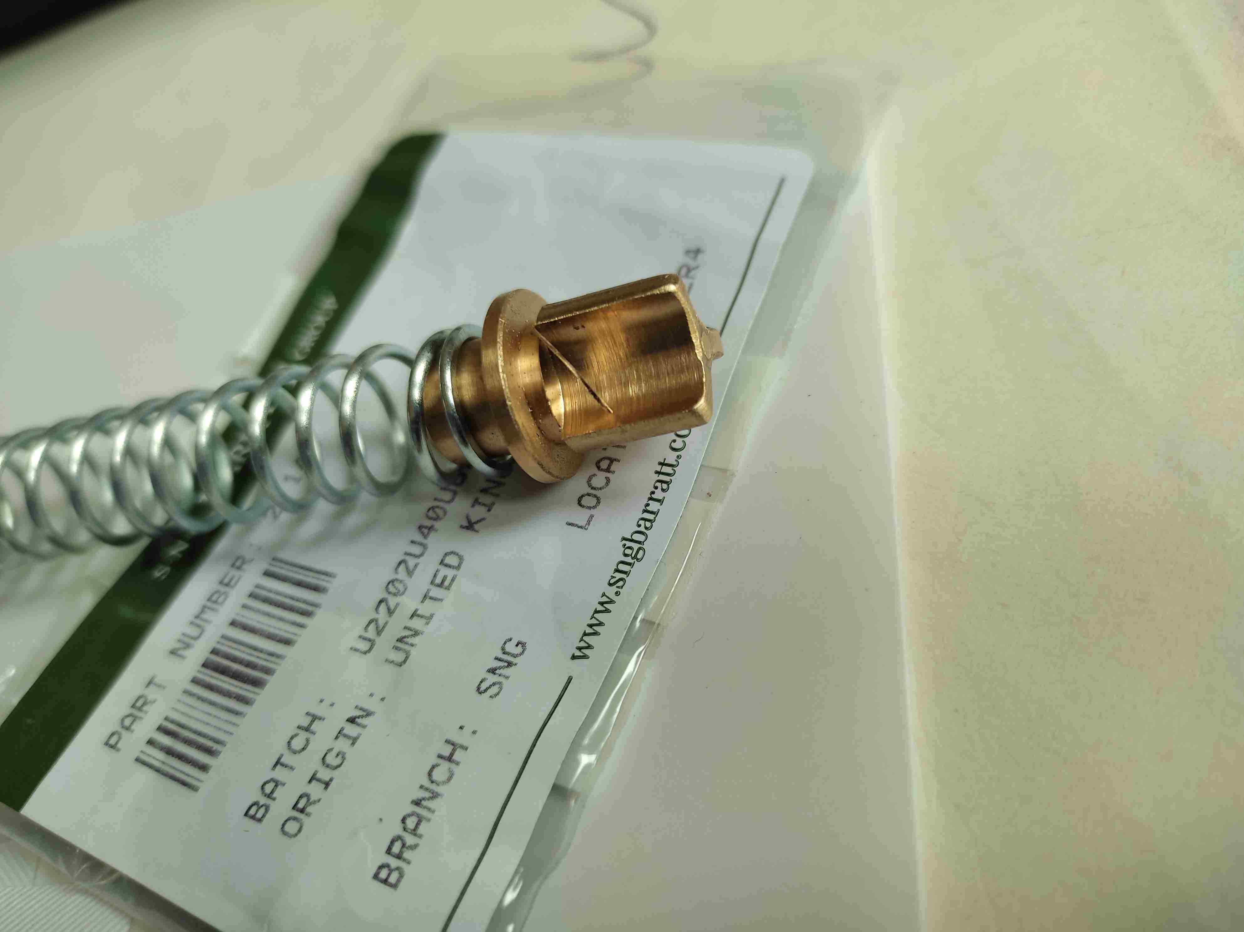

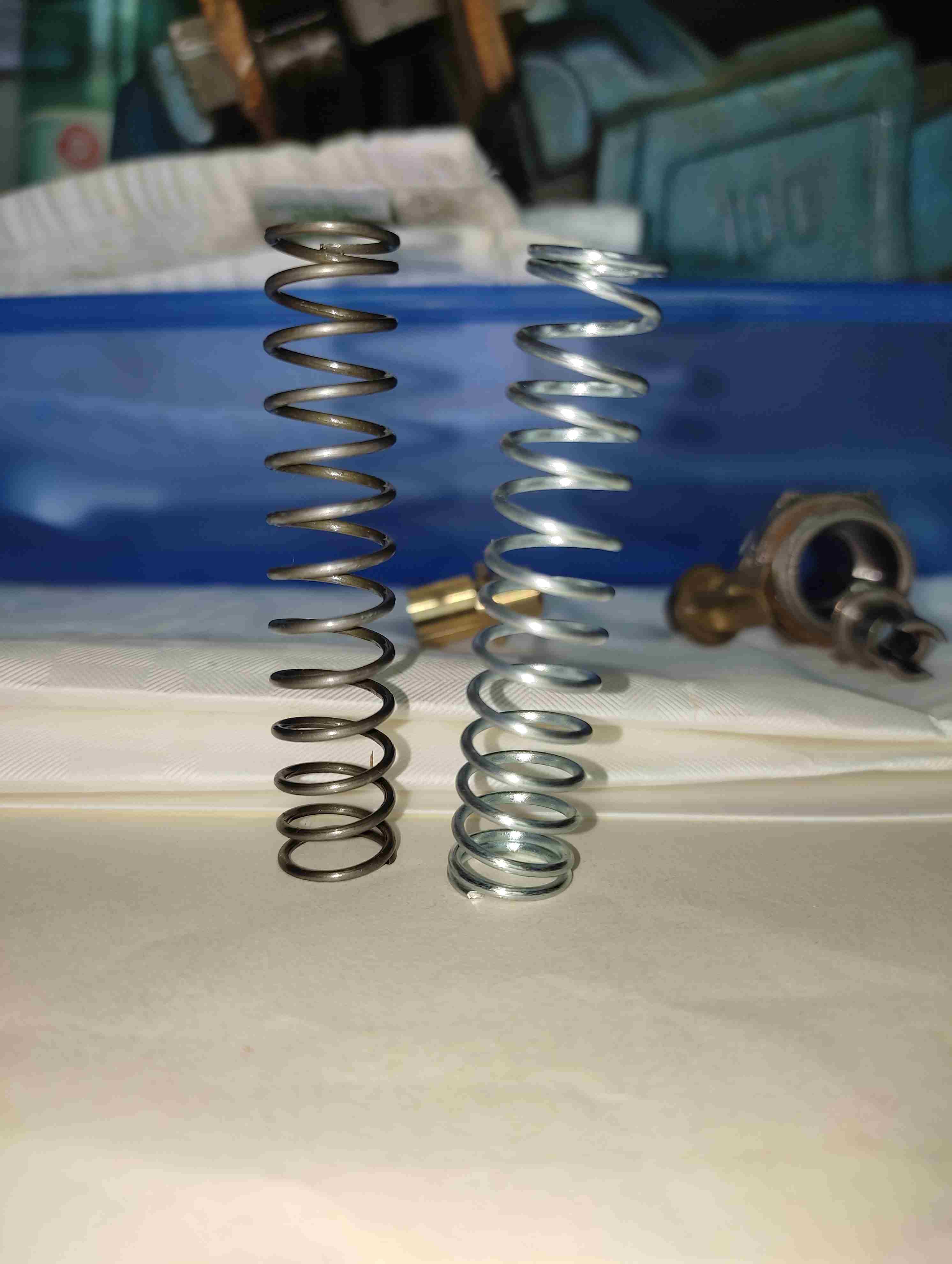

For security, in case of a defective OPRV, I sourced a replacement valve and spring:
IMG_20220829_155306 (2).jpg (170.71 KiB) Viewed 11791 times

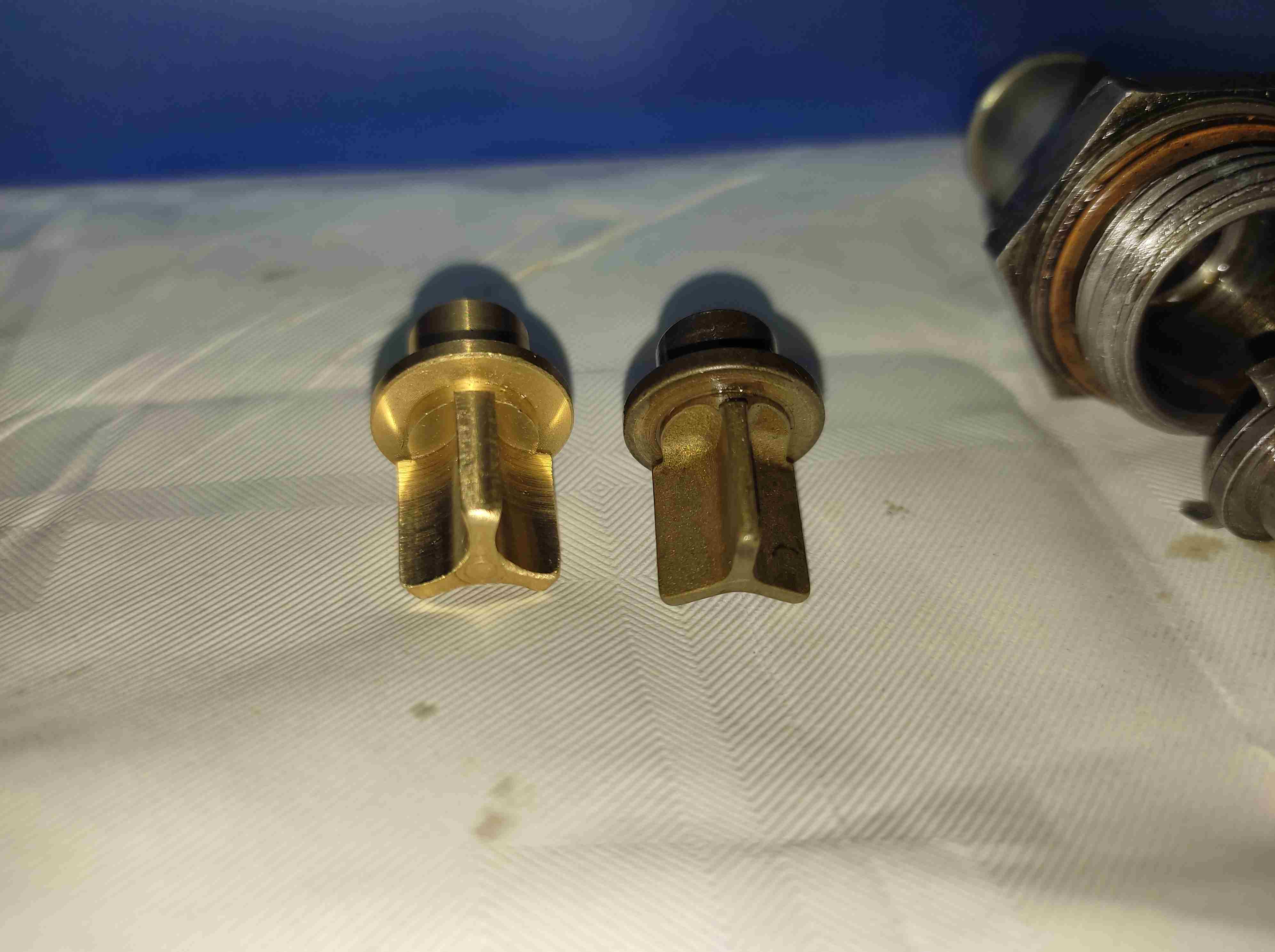

When compared to the OEM, one can notice diffrences in the quality of the pieces.
The finish of the new valve looks coarse compared to the OEM piece:
IMG_20220829_160659 (2).jpg (223.42 KiB) Viewed 11791 times
Similarly, the new spring has ends that are not finely tapered as the OEM one, leading to an oblique stand when raised on its base while the OEM one sits quite vertically:
IMG_20220829_161002 (2).jpg (179.05 KiB) Viewed 11791 times

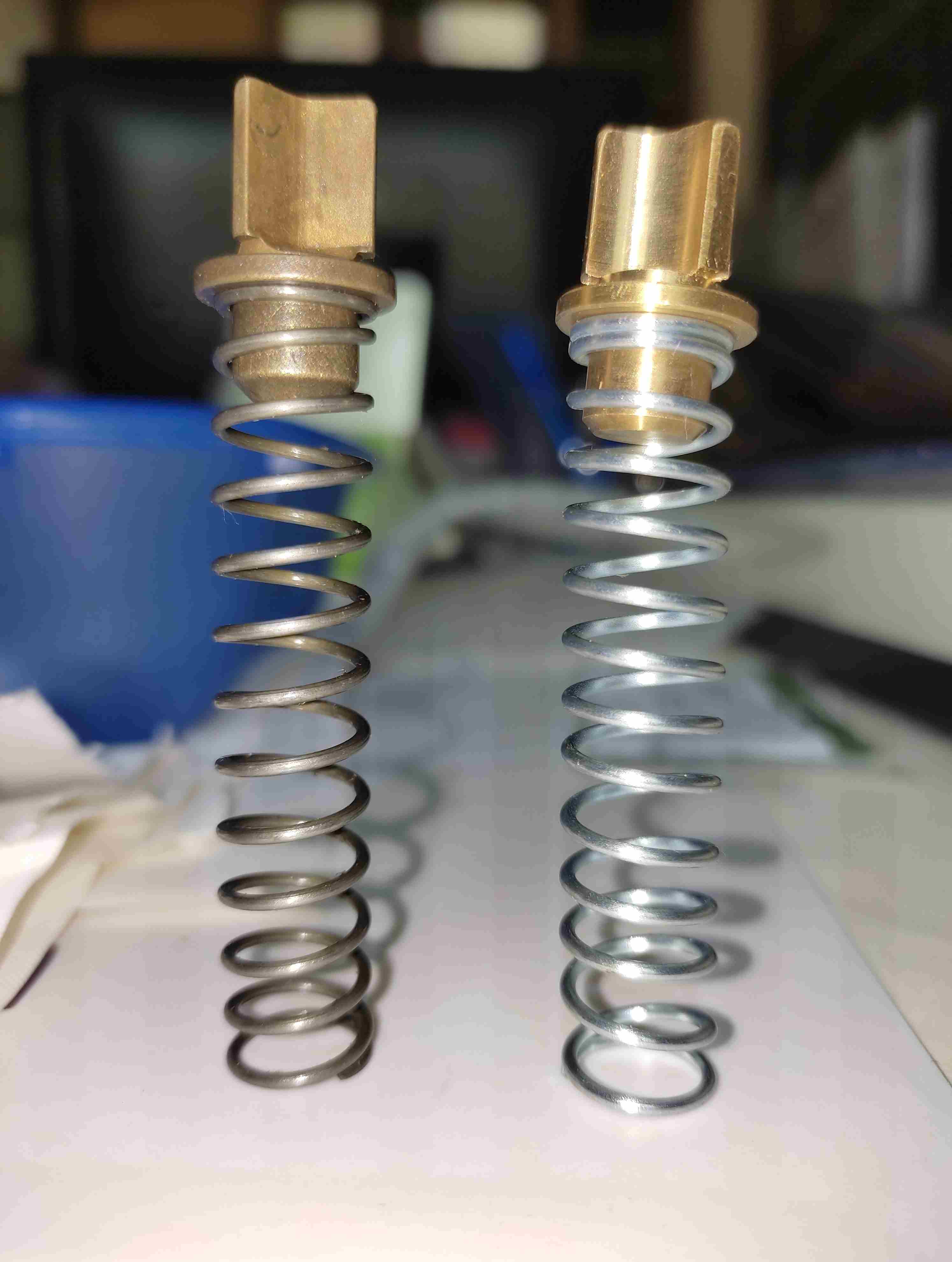

The visible difference when the valve is put of top of the spring may have an impact on the proper seating and pushing of the assembly inside the closed filter housing:
IMG_20220829_162900 (2).jpg (190.62 KiB) Viewed 11790 times
Obviously, if the OEM pieces are not defective, it looks to me better to keep them...

From my careful inspection of the OEM valve, it does not show any defect on its seat or on its fins that may hamper a proper seating or a good sliding in the bore.
Moving it manually inside the bore did not show any resistance either.
The new valve does not seem to be better. On the contrary, its coarser machining does not inspire confidence.
Wrt springs, although there is a small length difference, their mechanical resistance upon compression looks similar (albeit only tested manually).
When inserting and bolting it inside the casing, the OEM spring still shows a good mechanical strength. I have not measured it but it looks to me consistent with the force to be resisted at 6 psi (or 0.4 kg/cm2) that should be about 0.5 kg (the square area of the bore is about 1.2 cm2).
Here again, I feel more confident to reuse the OEM spring because of its straighter standing and maybe more even pressure distribution with its tapered ends when the spring will be compressed.

Regarding the quality of the reproduction parts, I concur with you about the low quality.
You correctly saw a piece of swarf that I had to detach from the valve!
Regarding the bore aspect, I am not sure it is as bad as it looks in the picture, but yes there are marks.

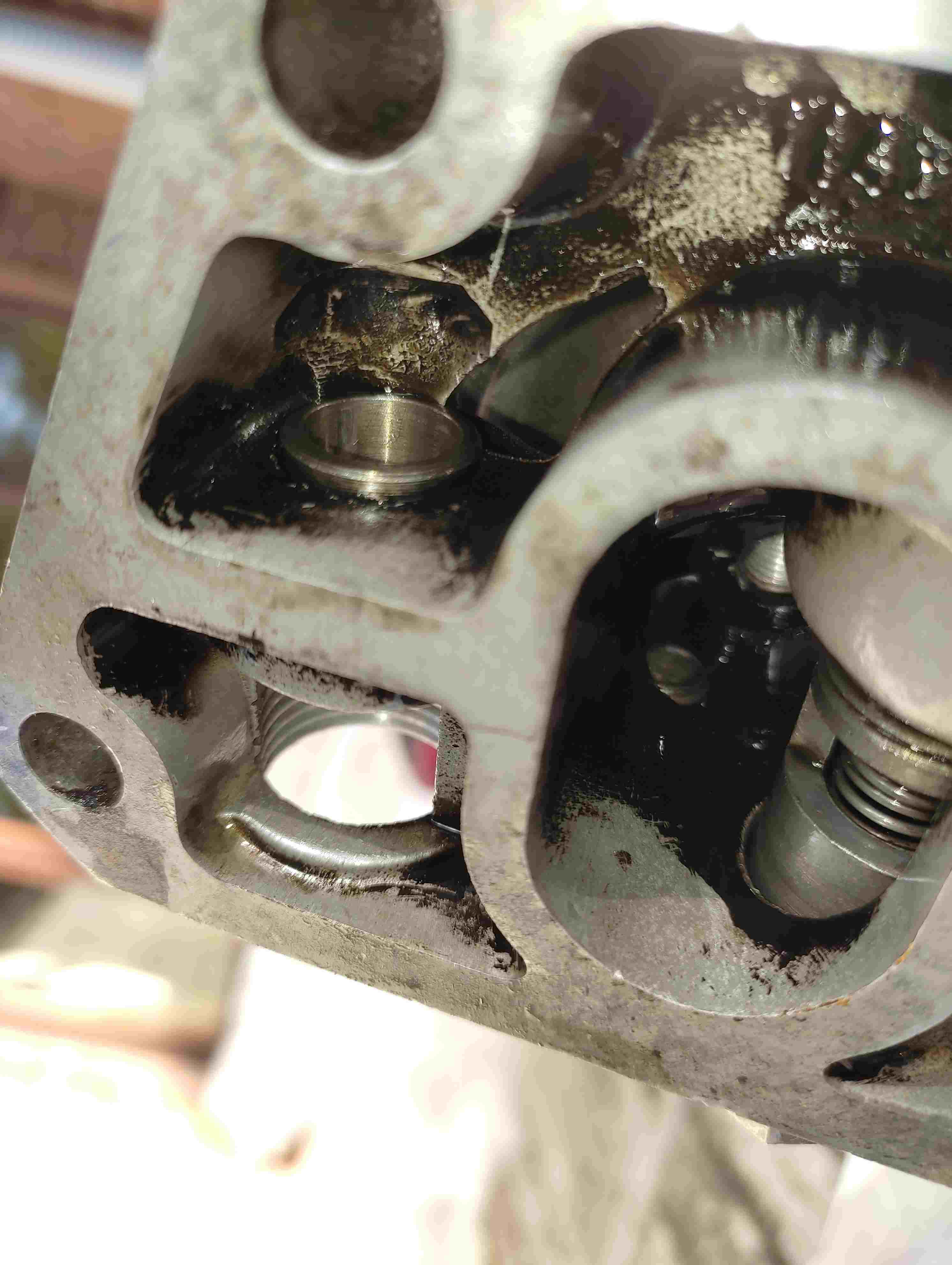

Here are two other pictures, one with the top of the bore without the valve:
IMG_20220828_171556 (2).jpg (207.44 KiB) Viewed 11638 times
and another one with the OPRV reassembled (in a different position compared to when disassembled):
IMG_20220830_105037 (2).jpg (201.99 KiB) Viewed 11638 times
I have checked that the valve can easily rotate in the bore when seated without the spring (not when compressed by the spring though, there is too much force).
I hope that those marks do not keep the valve stuck in open position.
Actually there is a small dimensional tolerance between the fins of the valve and the bore, allowing in principle such movements until the valve is seated.
I will make a reassembly, test the oil pressure, and report.
