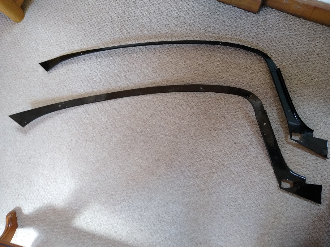

I am looking for the foam padding that goes on the crash padding assemblies on the cantrails on my early(ish) 3.8 FHC. It has the type that run to the rear hatch, rather than the later ones that wrap around the rear quarterlight.
Can anybody suggest a source for these please? I have spoken to BAS, who supplied my trim kit, but they say they don't supply them.
I have the metal carriers all painted up and ready to go and I have the vinyl, I just need the foam to go between them.
I don't have the original foams to be able to replicate them and I don't remember ever having seen them so if anybody can provide pictures then that would be a big help too. Picture of the metal carriers below.

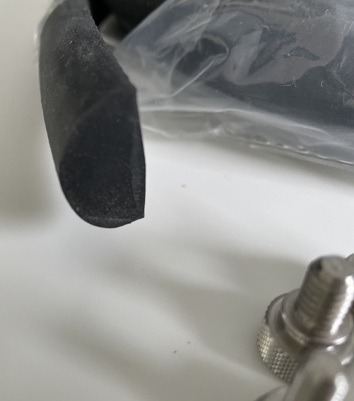

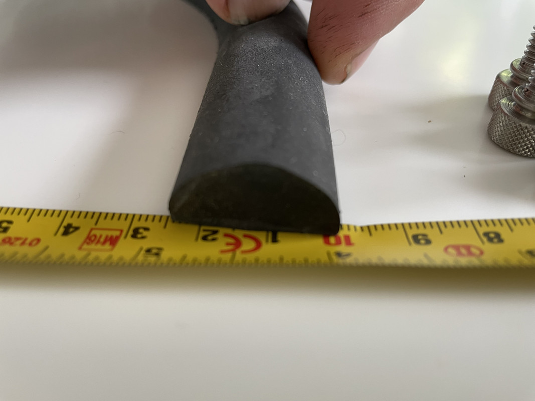

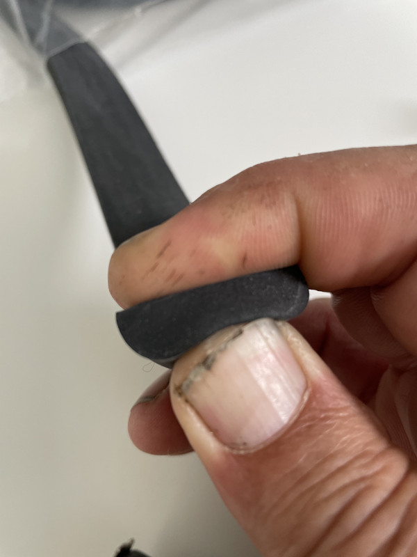

Post by TGN » Tue Sep 06, 2022 8:16 pm
This is what BAS are supplying its relatively easy to squash to 50%
