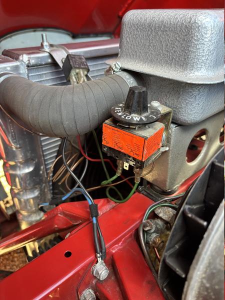

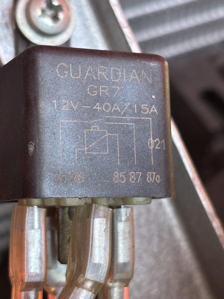

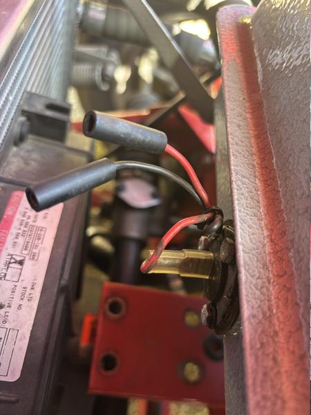

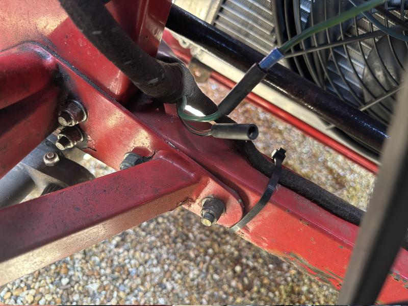

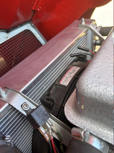

Quick follow up in case it 'leads' anywhere (hahaha). I updated my sig - thanks for mentioning it. The horns work so I think they are not the source but thanks for the suggestion. I now think it can't be the LED headlights as I can't see how the wire would get outside the car. I looked at the wiring diagram but no clues from that. Had a good look under the hood and I see that there is a Guardian GR7 12v 40A relay that has five terminals. After doing a bit of googling I think that two are for power +ve and -ve. One has a green wire connected to the NC terminal on my Kenlowe fan thermostat; the other GR7 relay terminal is connected to the fan itself. The fifth relay terminal is free. The NO terminal on the Kenlow fan thermostat is occupied by another green wire that comes up from the wiring loom clamped to the front strut near the radiator. Where that green wire feeds from the main loom there is also a red black wire ending in an empty black connector. (Two similar empty black connectors are attached to wires coming from my coolant header tank Otter switch). I tried the blue male of my mystery wire in the black connectors but it does not fit - seems just too large. Is it sensible to think that my mystery wire connected to the fifth terminal on the GR7 12V 40A relay and went into one of the black connectors? Just asking on the off chance. Any thoughts welcome. Photos attached of the foregoing in case they aid understanding. Thanks for reading in any event! After this it's off to the garage!
