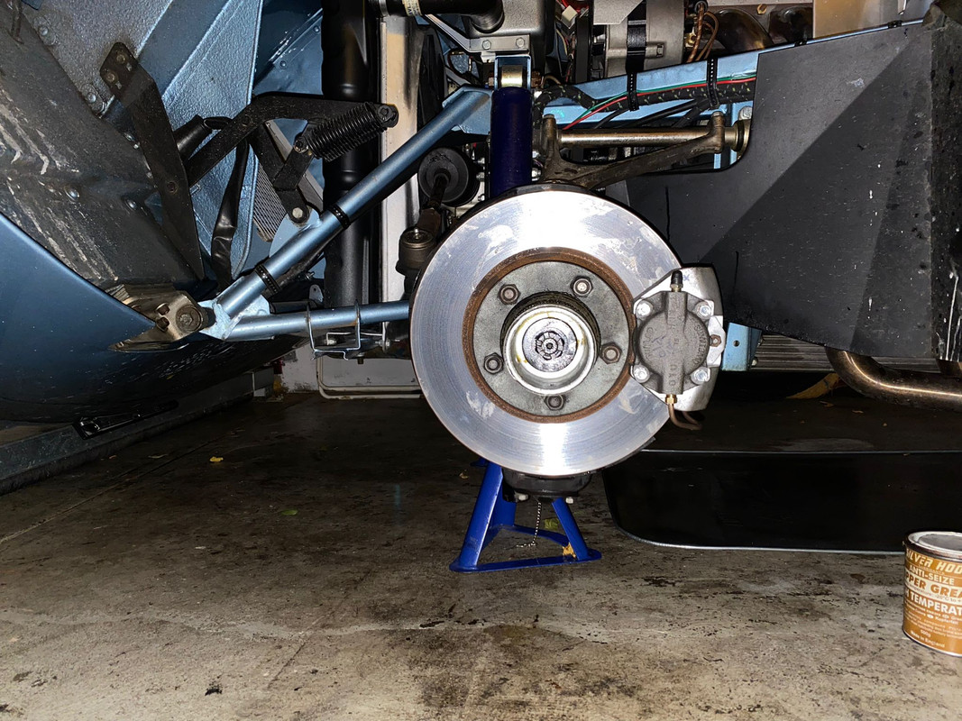

I have installed the original setup as I do notice an initial bite compared to the Coopercrafts. I am definitely locking the rears before the front which is both dangerous and suggests another problem. Could the slave or master cylinder be at fault?
1965 S1 4.2 OTS. Opalescent silver blue. 1E 10786

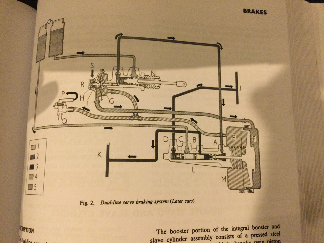

Looking in the service manual there are 2 ways to connect the servo; for “early “ S1 4.2 cars the rears connect to the first circuit connection with “later” cars connecting first the front circuit. I have currently the early setup, but have had advice to switch to the later setup as per the diagram below
Anyone have experience with this?
