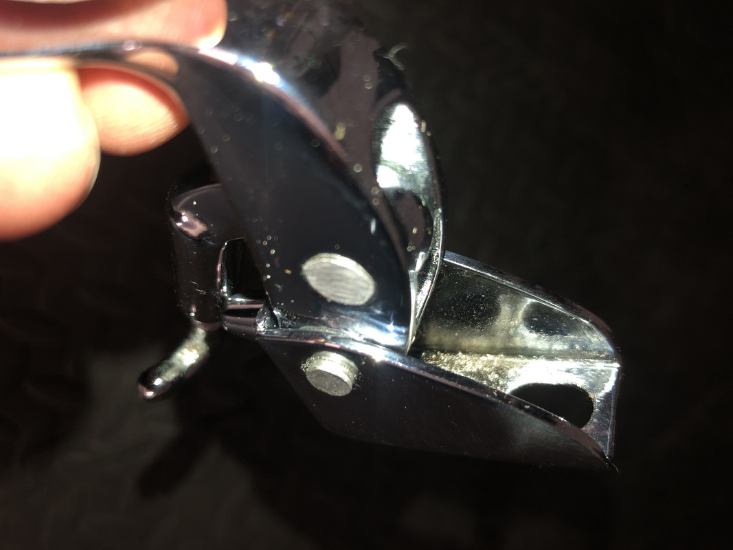

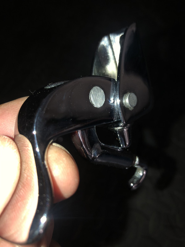

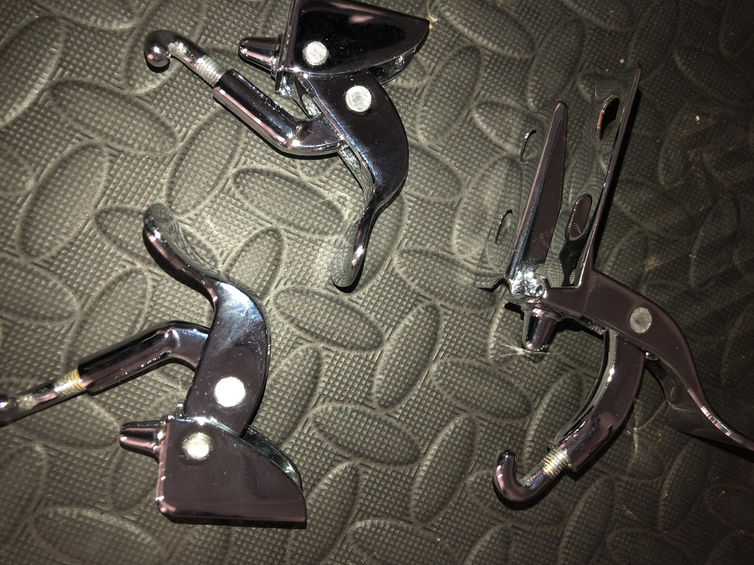

I have done this
I bought some (v cheap) Pan head solid rivets made of aluminium of the correct diameter.
I machined some for the rivets needing to be countersunk( you could just get countersunk for these)
I simply peened the ends over to locate them and stop them slipping out
Robbie
See attached photos

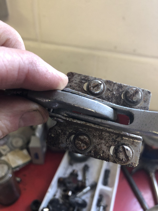

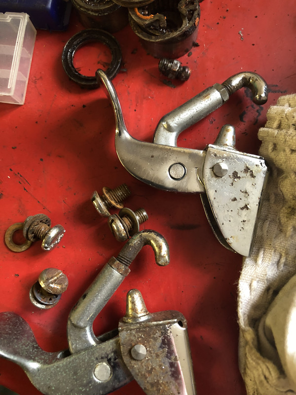

More before shots

Only the "internal" ones need to be countersunk and just the correct length before "peening"... friend machined them for me
The maine fulcrum ones are left with a pinhead one side and peened the other
Not a difficult job.
for the flush peening i drilled a very slightly larger hole in a thin piece of copper sheet . Placed it over the very slightly proud rivet to protect the chrome from the hammer, then gently peened the end over to spread it to fit
Very happy with results
