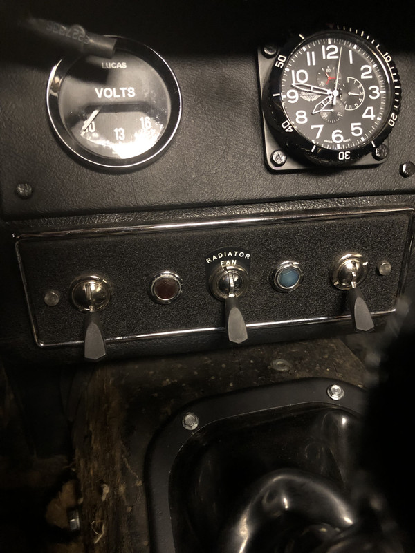

#4 Re: Proper Interior Location for Cooling Fan Switch?
Post by mtnjag » Fri Dec 02, 2022 2:45 pm
I mounted a fan temp sensor over-ride switch on the under dash trim on left under dash. Similar position to the odo reset but on other side of column.Simple black stock toggle to the relay. Easy to reach, plenty of space. No bracket, no label, just a hole in the trim piece with a black toggle, plenty of room up there.
You don’t need to see something like that, you know it’s there.
LHD car.
If you want a label, this one and others are on Ebay to fit the Lucas switch. I put a warning light next to the manual over-ride rad fan switch. This is the radio blank in my Sprite radio console.
Layne
