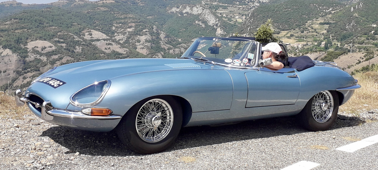

Believe it or not but I have done both!! --- 2.88 rear Dif and a new Tremec T5 box.
Fortunately the cylinder head was gas flowed by Peter Lander some years ago which gives the car great lowdown torque and smoothness.
It is like going back to a 4 speed box with an overdrive for motorways etc.
I do a lot of touring in my E (S.Africa twice, N America 3 times and virtually all over Europe) and it makes the driving experience very relaxing.
