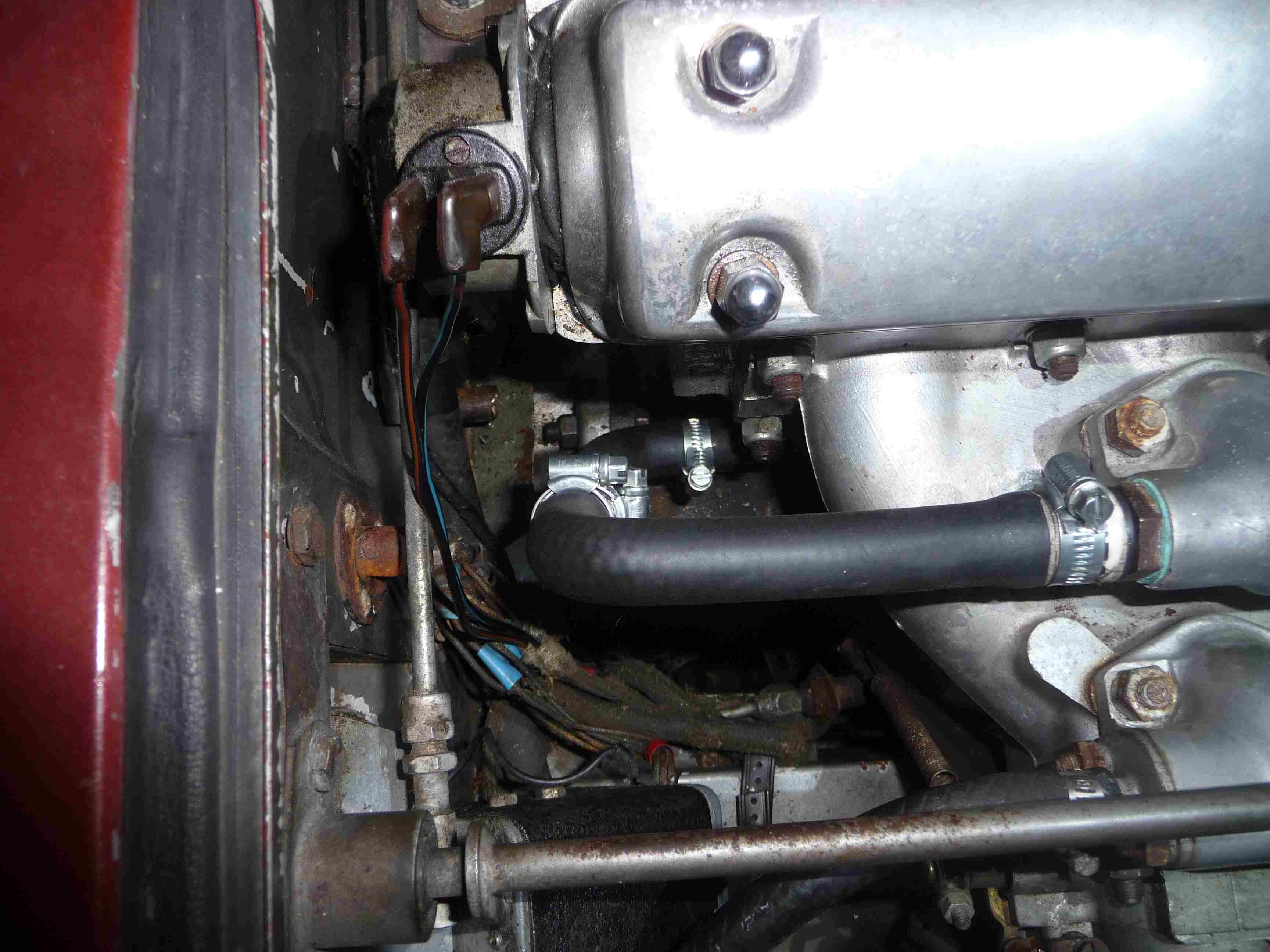

Now, here's a question for everyone, well TWO actually.
I've never been comfortable with the un-swaged ends of these heater pipes on the bulkhead ; Jaguar made the fittings on the heater itself with swaged-ends, to stop the hoses pulling off, but the bulkhead pipes are just straight, presumably to reduce the size of the holes and anchorages on the bulkhead.
If there had been room for the tools, I'd have been tempted to swell the orifice with a swaging cone, just to give it a bit more of a mechanical grip once the Jubilee clip is in place, even if meant the next guy needs to cut and change the heater pipes to get them out.
Do these hoses ever pop off ?
Question two, is the alignment of that top hose always as uncomfortable as mine appears to be ? I cut the pipe as far as I dare on the heater end, but still it's not visually satisfying and looks like a design cock-up, by about a half-inch.
PS Who made all the neat stainless fittings, like those pipe-escutcheons, on my car ? Guess same guy who did the SS throttle linkage, the SS main hood pivot anchorages, maybe the SS hydraulic bottle brackets. Anybody know the source ? It would have been circa 1989. A very talented chap, anyway.
#18 Re: Heater Transfer Pipe Replacement
Posted: Sun Sep 17, 2023 3:38 pm
by Allrand
Hi Rory, yes those heater pipes are awkward. I'm surprised your pipes out of the heater are swaged, mine aren't & popped off. I soldered on some brass plumbing ferrules but haven't reconnected them yet, I've left the heater bypassed.
#19 Re: Heater Transfer Pipe Replacement
Posted: Sun Sep 17, 2023 4:00 pm
by rfs1957
Not the best shot, but had this from pre-restoration.
Am off to see an air-conditioning mate tomorrow, these things are called spin-swagers, designed for copper-pipe junctions, I reckon I can get the beginnings of a lip on the pesky bulkhead pipe stubs.
I may yet be glad of those stronger 4mm rivets ...........
#20 Re: Heater Transfer Pipe Replacement
Posted: Sun Sep 17, 2023 4:32 pm
by paydase
Mines also unswaged on the heater box.
Maybe the stiff turn (and strain) on the hoses in that tight space was supposed to help in not popping off?
