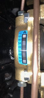

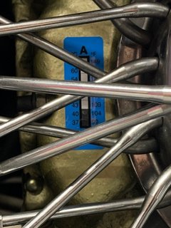

When refurbishing the rear axle and brakes, I took the opportunity to put thermal tell-tale strips on the pots (and on the fronts). I based the teperature range of the strips on my daily driver - BMW 330i. Front brakes (upgraded to Girling calipers) read about 40 Deg.C, and the rears about 60 Deg.C Some of the rear pots went off the scale, so I'll have to fit the next strip range and re-evaluate. Not too concerned about the higher rear temperatures since they're a different design to the fronts, and aren't very well ventilated. Worth keeping an eye on though:

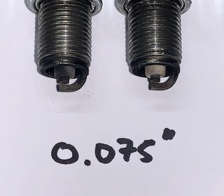

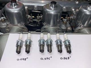

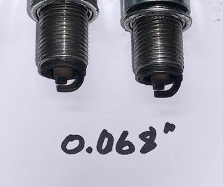

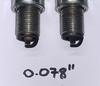

I've been messing about with the carbs and mixture of the past days (as per another thread). I got the CO to read 5.0 on the Gastester yesterday evening, and did a cursory check with a colourtune. All looked OK. It ran fine for the most part, but after a long downhill, followed by a pause at traffic lights, I got a temporary bad misfire, which eventually cleared under acceleration. It was a bit scary though. I got the impression it was plug related, but don't know. There is some popping on over-run, but I did notice condensate dripping from the exhaust joints, so they might need sealing. On returing home, I checked the CO again, and it was reading 8 on both exhausts. I don't put much faith in the readings since I see the Gunson's Gastester of a bit of a toy.
Anyway, I also checked the jet-bridge depths, and plug colours:

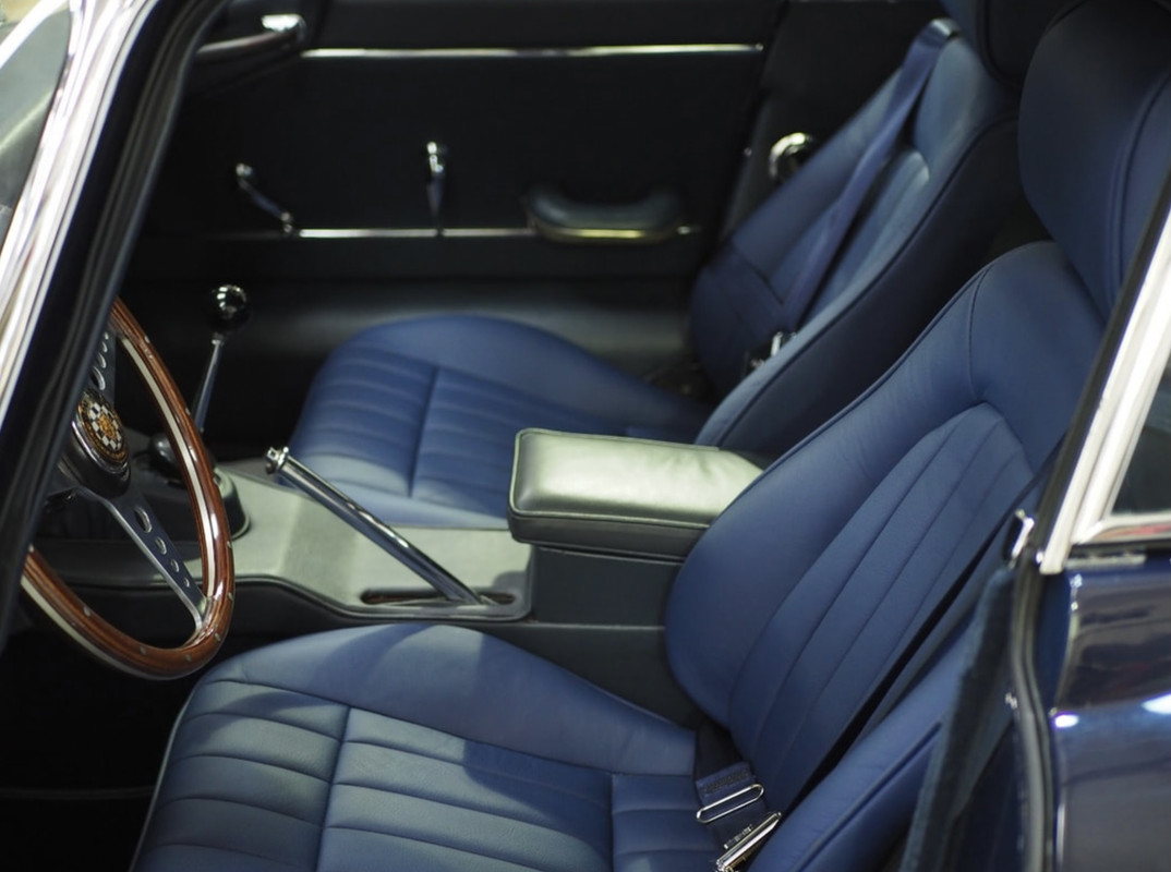

The seats are too high, despite having their rail spacers removed. They are also too upright. I'm planning on fitting spacers under the front mushrooms, and somehow reducing the foam thickness. When I rebuilt the seats 20 years ago they had new foams and diaphragms. I estimate I can get about 2" more headroom with these modifications, although I'm not looking forward to un-stapling the squab covers...

I'd be interested in any comments on the above in terms of how you find your car, and also the brake temperatures and any opinnions on plug colour/mixture. I know it's tricky to interprest plugs with modern fuels (in this cae Shell V-Power).
