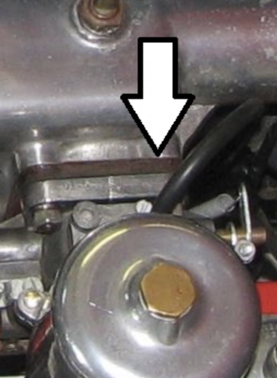

Just trying to make sure all is correct, is the vacuum to advance the ignition pulled from SU No3?
#2 Re: Ignition vacuum
My 62 it's from the front carb above the distributor

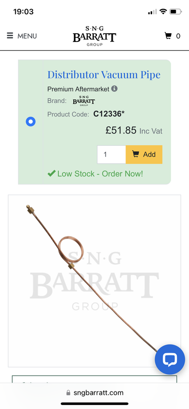

Lovely, thanks yes I have that only that at some point in the car's past the copper tube was cut around an inch and a half past the bend from the carb and a fabric braided rubber hose was fitted. I guess I will get the proper one some day.
On the other hand at £51.85 its a bit of a liberty.

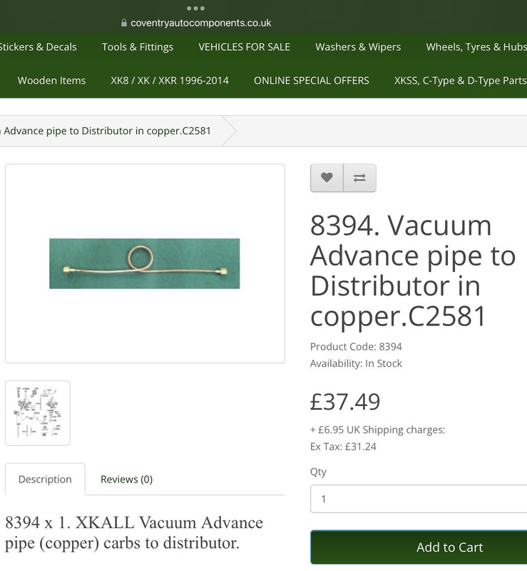

My '64 has the rubber connecting pipe to the carb. Seems earlier cars had the screw down fitting on a coiled pipe as shown in the top pic, similar to my old Mk7.
