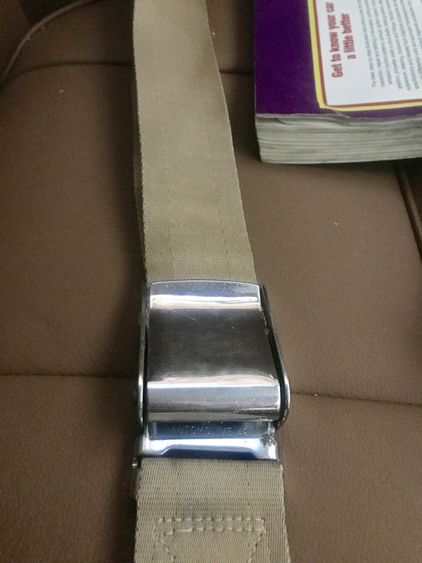

AFTER-MARKET SEAT BELTS
Several suppliers offered seat belts for fitment after the E-Type had been purchased. This was fuelled by the 1964 US legislation mandating all new cars had to be fitted with seat belts seat belts which galvanised owners into purchasing them.
Hickok
1909 Hickok Manufacturing Corp., launched by S. Rae Hickok, as a small downtown jewellery shop. The business evolved into making monogrammed metal belt buckles, belts and other accessories for men in plants in Rochester and throughout Western New York.
1948 S. Rae Hickock died, his son Raymond took over as Chairman of Hickok Manufacturing at the age of 28.
1949 the company had $20 million in sales and 2,500 employees. A keen business sense and a flair for publicity helped Hickok’s success. He expanded the company’s product base beyond belts and belt buckles to include suspenders, garters and sportswear for men and boys.
1955 Hickok Manufacturing developed an early automotive safety belt
1961 Hickok purchased Philadelphia’s Pioneer Industries Inc., the second-largest manufacturer of men’s accessories.
1963 Hickok agreed to supply seat belts to American Safety Equipment Corp.
1968 Hickok legal issues forced the company out of the seat belt business.
1970 declines in the firm’s menswear lines weakened the company, leaving it in need of a buyer. A locally owned holding company, P.J. Parker Inc., bought Hickok.
1971 Tandy Corp., later known as RadioShack Corp., acquired Hickok.
Hickok Mfg. Co. manufactured car safety belts and in 1963 allowed them to be marketed by American Safety Equipment Corp. but still stamped with the Hickok logo. Many USA E-Type's were fitted with after market Hickok seat belts having the Jaguar ‘wings’ logo pressed into the buckle. It has been assumed these were official Jaguar endorsed items helped by some creative packaging on the part of Hickok!
Hickok belts were never installed by the factory nor could they be ordered with the car. They were strictly aftermarket, and only installed by US dealers at owner’s request. Legal disputes in the 1960s forced the company out of the seat belt business for good. This is echo’d on Porsche, Mercedes and VW forums as Hickok produced logo'd buckles for several marques.
Trivia: Raymond Hickok was a great-great nephew of the legendary Wild Bill Hickok.
Ray Brown Automotive
Ray Brown is a Hot Rod legend in the US and started offering seat belts in 1962 . Within three years Ray became one of the largest seat belt manufacturers in the world, employing over 150 workers across two, daily, shifts. RBA belts were never installed by the factory nor could they be ordered with the car.
Richard (rswaffie) adds:
My Nov 63 fhc, was purchased in Jan 64 and delivered to California where aftermarket belts (Ray Brown) were fitted. They were still in place when I bought it in 2016 and came up very nicely after some polishing. They had a 1964 date on them.
