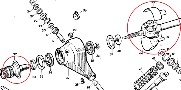

#3 Re: Scraping Sound from rear wheel s1 fhc
Two possibilities:
1. The joint cover protecting the outer journals (44) is loose and is rubbing
2. The water thrower on the rear hub assembly (30) is loose

#6 Re: Scraping Sound from rear wheel s1 fhc
If the water thrower comes loose (which is not very likely), you should be able to reach behind the wheel and feel for its movement. It's right at the outside end of the aluminum casting, and right up against the rear of the wheel hub.
More likely is the cover over the outer U-joint, which is just thin metal and can become bent, and therefore scrape the inside of the aluminum casting, due to road debris. If so, you should be able to scraping marks in the aluminum.
