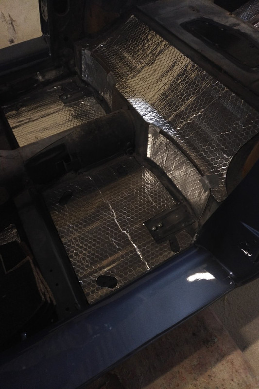

Hi, time to do the first things to the painted car :-)

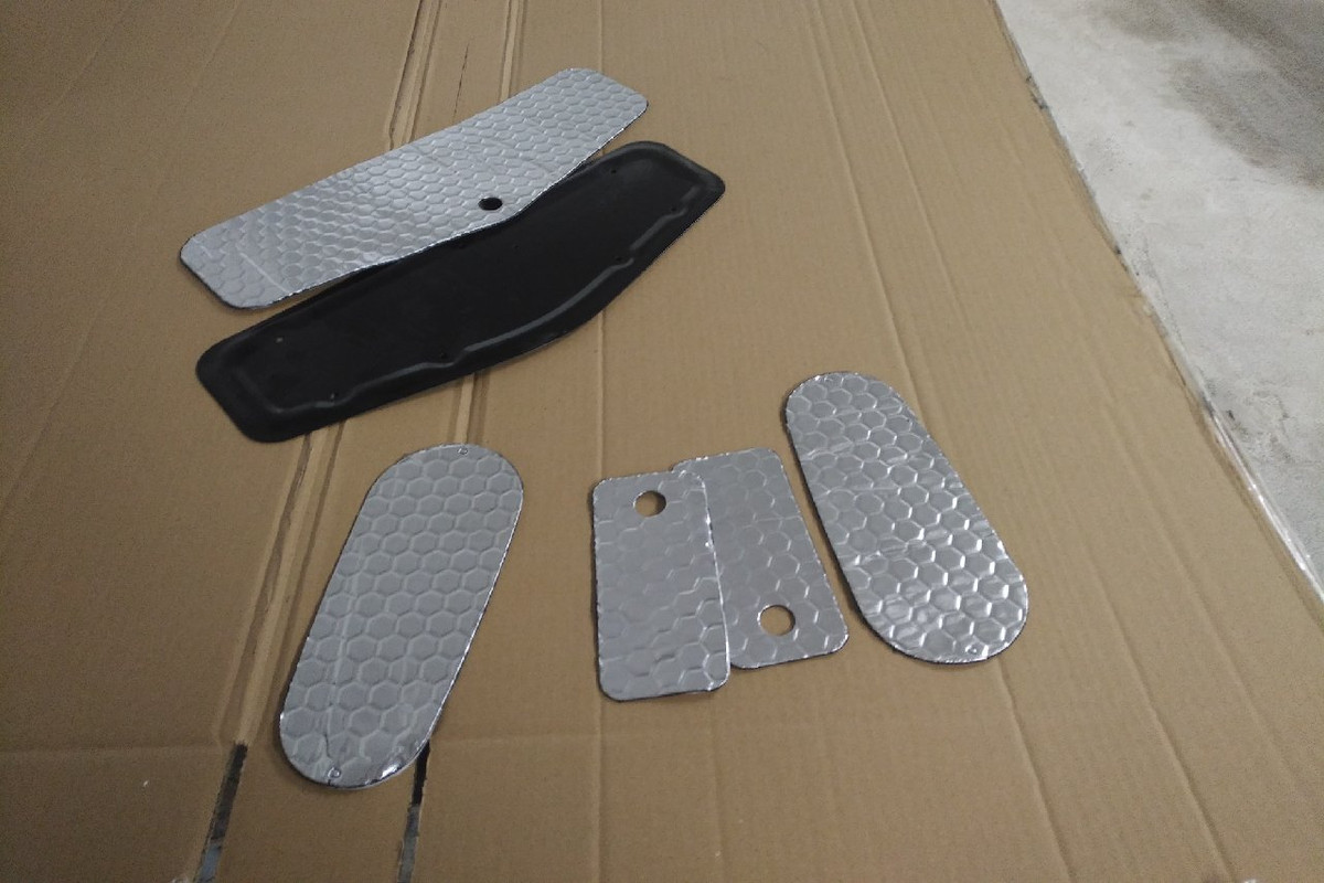

First picture. The two small square ones, where do they go? I would guess in the square indents above the rear axle. What's it actually for, the hole in the indent and the hole in the isolation pads indicate something that can be removed, but it can't?

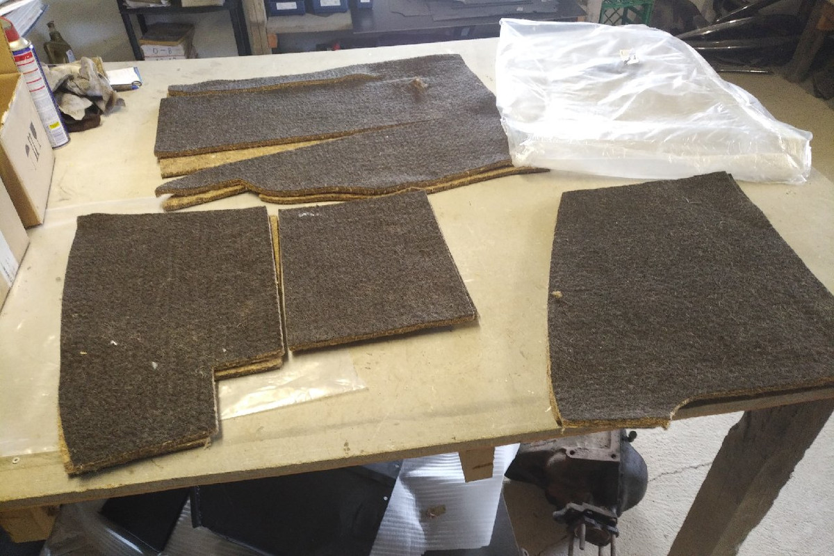

Picture two, the parts at the rear of the table are clearly for footwells. But the three parts nearest the camera, where do they go? I had expected one square part that would fit the almost square area under the seat, picture three? The set is part# JE38F/SP, so should be ok?

2 picture left - transmission cover sides, the square cutouts fit over the cross member behind the trans.
The centre 2 squares go against the fire walls at the front of the footwells. I think the right side pieces are for the side kick panels between the A-post & bulkhead below the dash, but I cant figure the curved edges.

Oh, just realised the pieces on the right go against the sides of the transmission cover below the dash.
