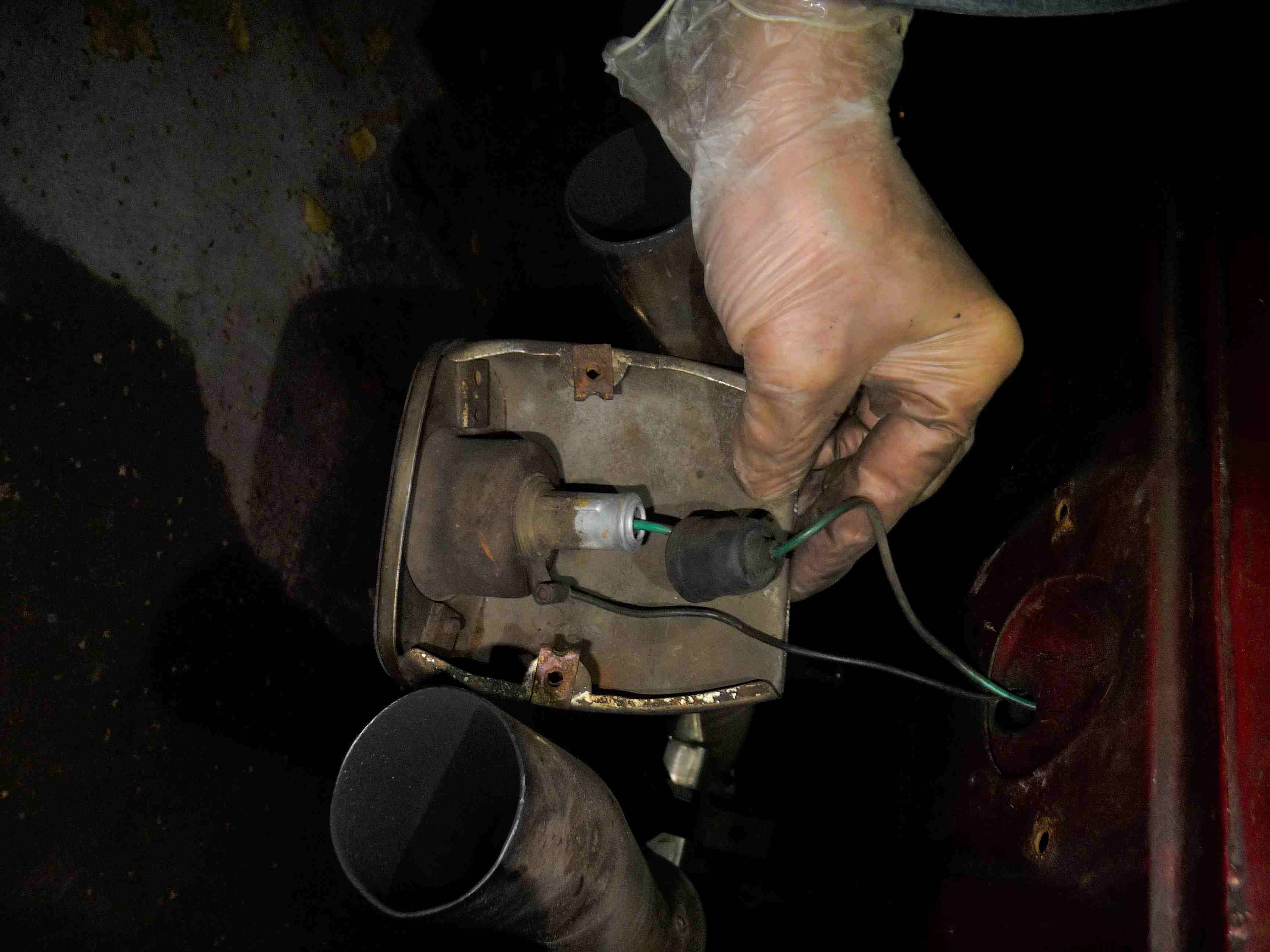

If it can help, here is the picture I took of the connection when I dismantled the rear light trim for repainting my 3.8 FHC:
P1200315 (2).jpg (225.22 KiB) Viewed 3790 times
Serge

Can be either of the side looms; some Autosparks looms have them on both sides.

#6 Re: Reversing light wire coming from?
Post by Allrand » Wed Aug 30, 2023 10:11 am
:yeahthat: my harness from Martin Robey has it on both sides.
