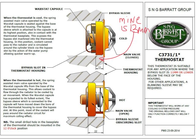

I did a bit of background reading and purchased C3731/1* from SNGB (their recommended option), the other choice was C3731/1W.
As I understand it it’s important the sleeve doesn’t block the by-pass channel when cold, and the depth of the channel from the base of the housing needs to be 11mm +.

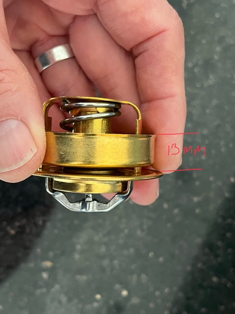

The sleeve on the thermostat I’ve received sits a few mm down from the face of the housing so the sleeve extends 13-13.5mm down from the face.
So the question is, have i got the right thermostat or is the by pass channel likely to be covered by the sleeve when the water is cold? It’s probably going to be hard for anyone to say for sure, but if it doesn’t look right I want to take this up with SNGB before i flush the old coolant out.

The C.3731/1 is the correct one. Check out this definitive article on E-Type thermostats and hopefully it will answer your question:
3.8: https://www.coolcatcorp.com/thermostats ... ifold.html
4.2: https://www.coolcatcorp.com/thermostats ... ifold.html

Darryl...your thermostat dosnt look closed....it has a gap thus giving you 13mm if completely closed it would be more like 11mm.... Steve

That’s what I think Steve, with no gap between the sleeve and the face it would be more like 11mm. I’ll give SNGB a ring tomorrow and see what they say 👍

Thanks for the heads up. I’m currently waiting for SNGB to get back to me on the sleeve dimensions issue (13mm v 11mm). I will find out in a week’s time which thermostat I'm currently running and be able to take a view on whether to fit the new SNGB one or not. I have the same problem as Swindler with the temperature gauge reading low.
