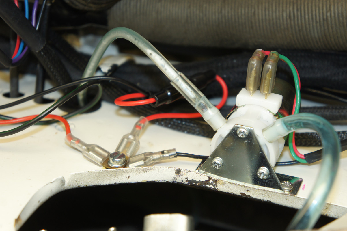

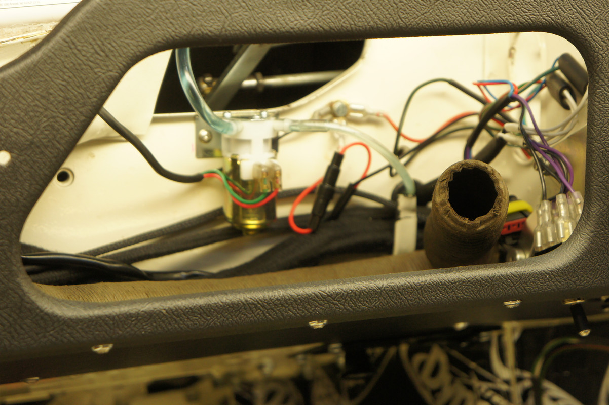

Is the pump actually visible with the plastic 4.2 version ?
I ask simply because I would challenge anyone to spot that my glass 3.8 type no longer uses the original pump.
I use a Mini pump fitted just above and behind the glove box, sucking through the original tube and foot, such that - I think - it is impossible to know that the original is no longer present.
It just requires dummy wiring to the old connectors, and a bit of harness tweaking under the dash.
Cheap, cheerful, invisible.
Will look for pictures if anyone is interested.

The only nifty bit is soft-soldering a take-off onto the brass tube at the top, and connecting it to the original delivery port.
I sourced mine here.
https://www.minispares.com/product/Clas ... o%20search
