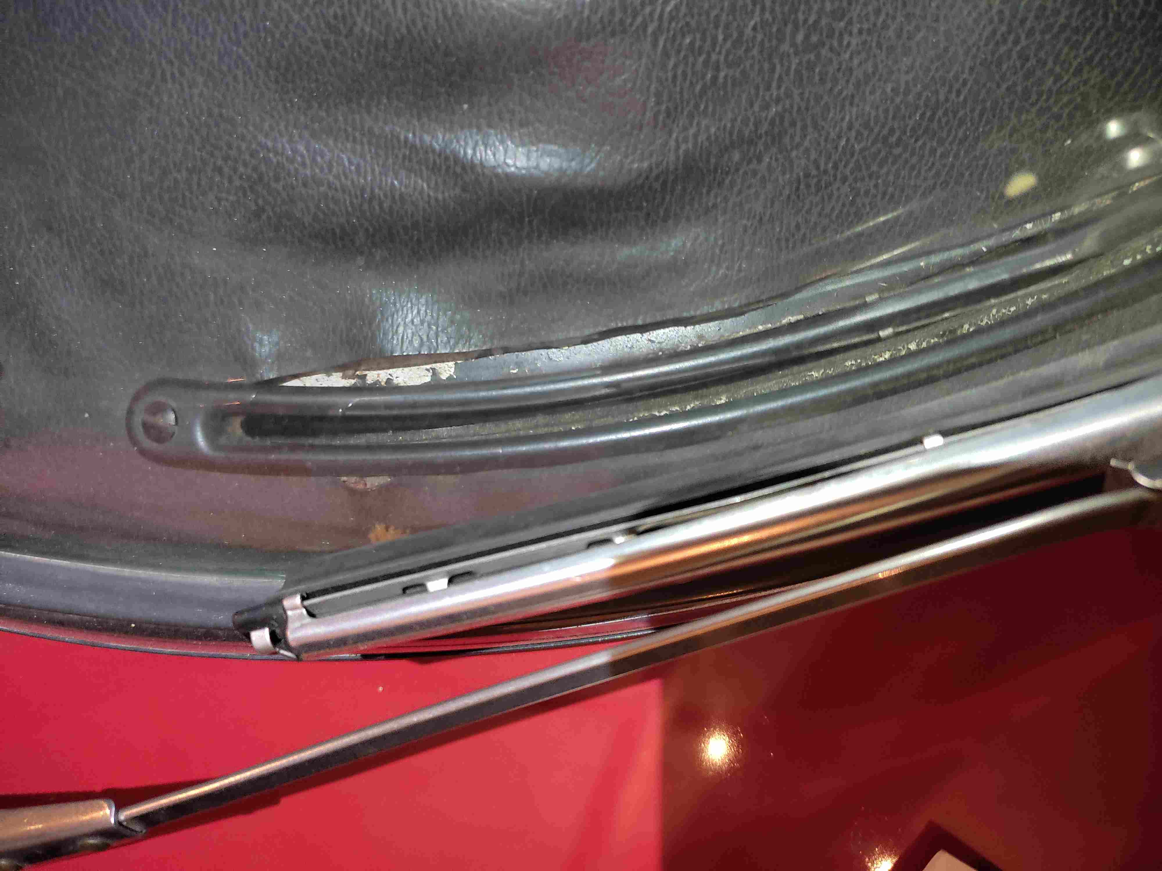

August 1961, should be an OBL?
On my October 61, the original flat dash top is also quite worn with numerous wrinkles.
What makes it distinct from later dash tops is, I think, the sharper edges because of no foam, visible here under on the lowering side, left of speedo:

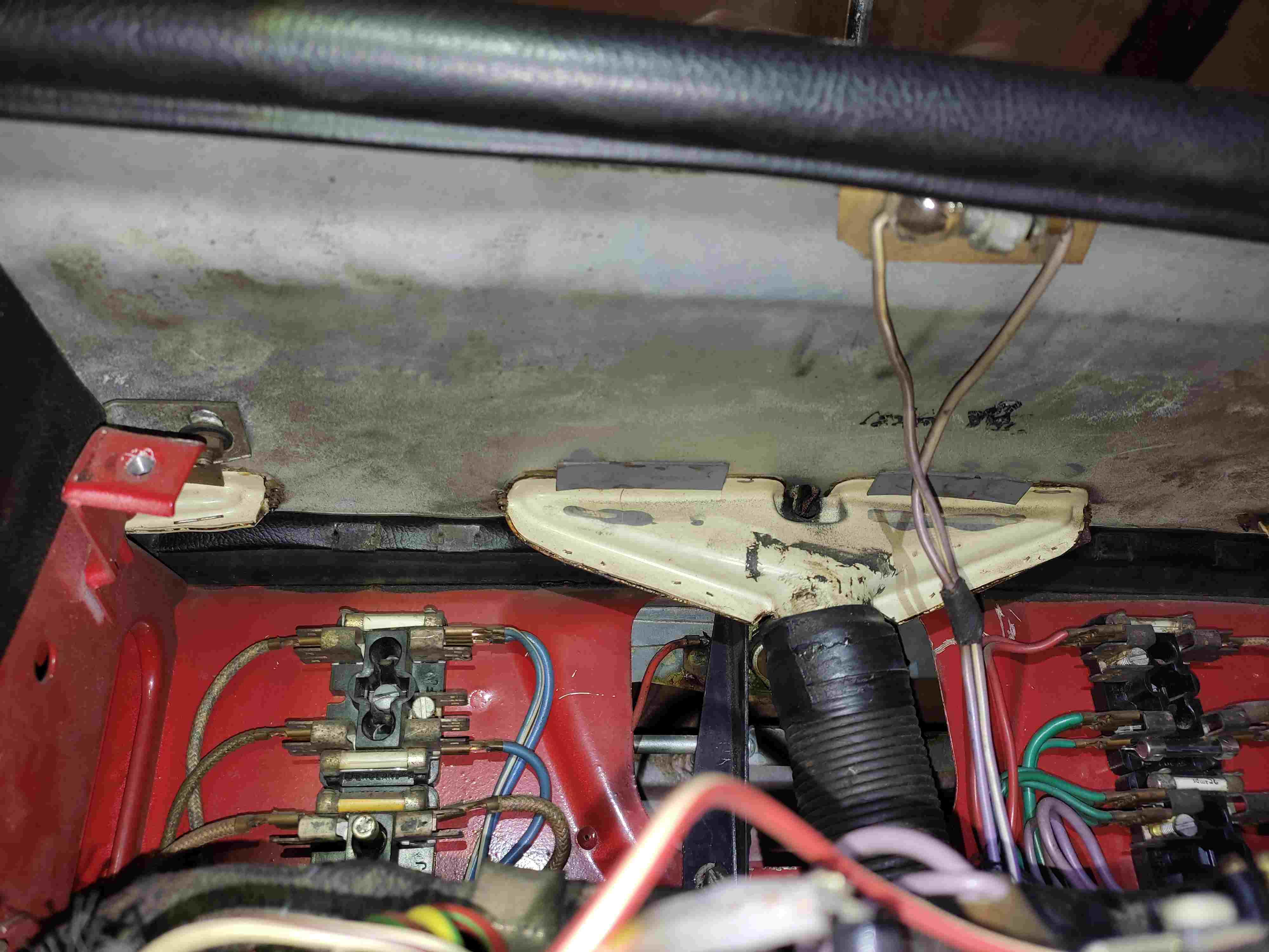

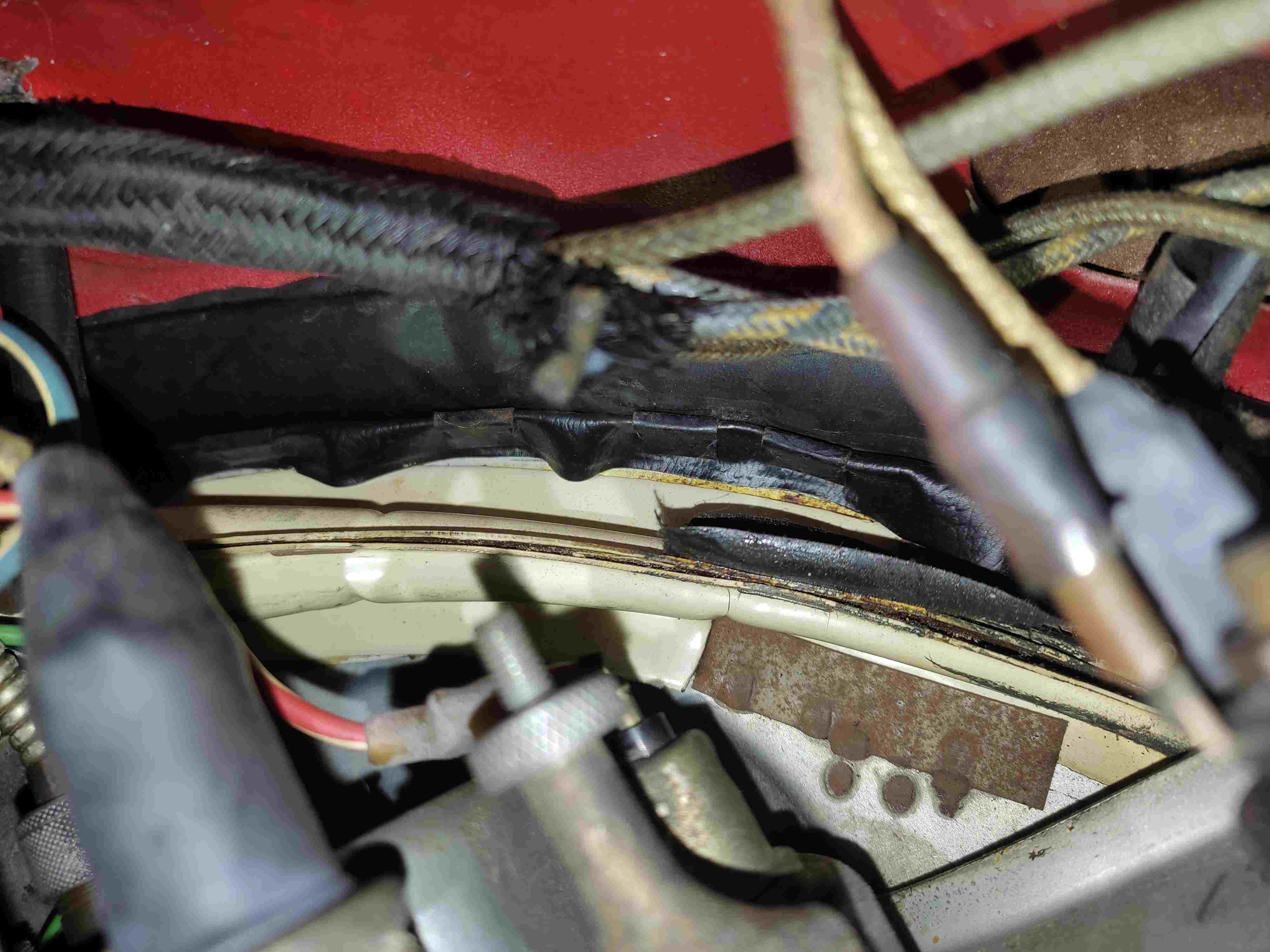

Tony,
I couldn't say what is under the vinyl in the centre section or in general if any.
The material is in bad shape:
You can also see here under a view under the dash, in the area of the speedo, where the fixing of the vinyl to the dash plate is made with clips:
I have still to see how I can either repair it with a heat gun and glue (unlikely but I can still have hopes...) or if I will replace it (not my preferred option as I wish keeping the original material).
