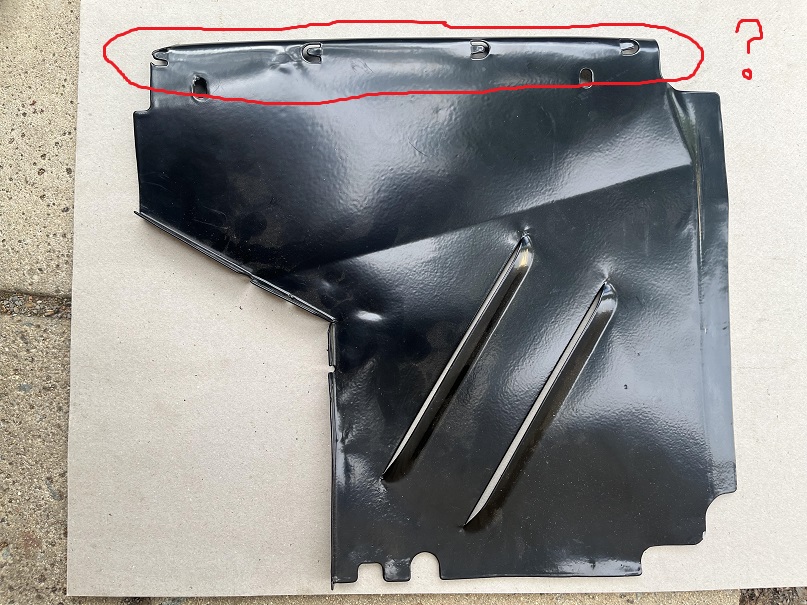

Hi all, just a quick one to ask whether something should be attached to the LHS stoneguard ? Should there be a strip of felt or rubber, noting it is quite close to the exhaust pipe. Any suggestions would be appreciated.

Hi Glenn,

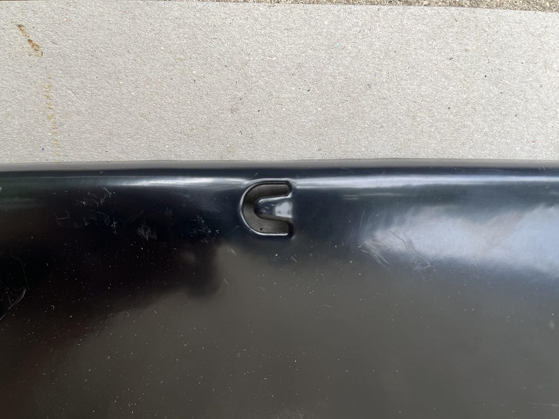

On my E Type it's a piece of flat belt with 2 or max 3 pleats
You make holes to engage the "hooks"
The same as this one but thicker
Hope it's help you
Mich

Thanks Mich,
Yes that’s a help & punching holes makes sense for the fastening.
