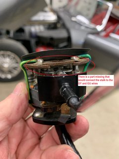

Hopefully someone can assist me in my quest...
There is a part missing from my original switch that would operate the dash indicators. Would someone have any pictures of the missing part as i hope to reproduce it and get my switch back in operation.
I made the error of purchasing a new switch which does not fit the die cast housing, so I am hoping to repair the old switch...

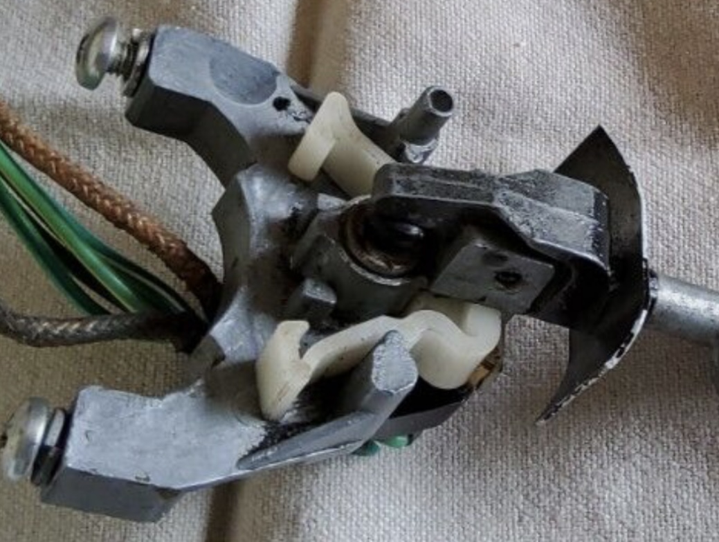

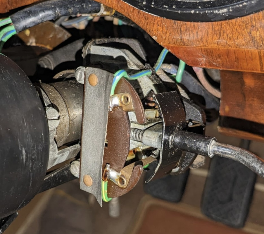

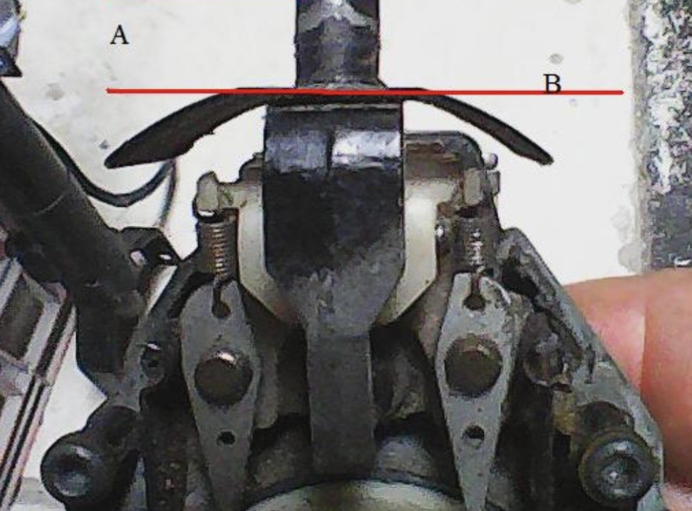

It looks like the nylon piece and springs may be missing:

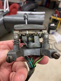

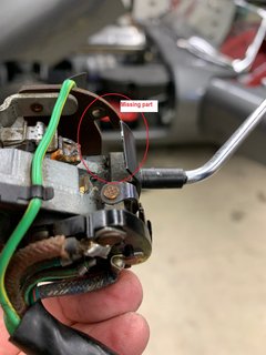

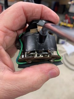

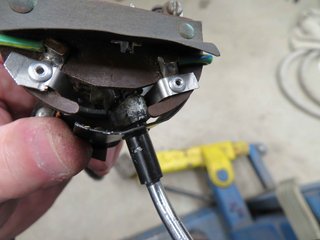

A couple of extra pictures of mine:
Not sure what is missing...

Mike,
I’ve just found an S Type stalk image that looks very similar to your original stalk?

by mxke » Thu Dec 14, 2023 10:47 pm
That is it! So it looks like two brass "wings" belong on the upper switch...

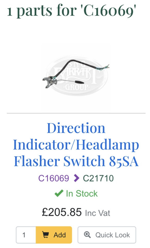

by caveman » Thu Dec 14, 2023 10:52 pm
According to SNGB UK site, one has been superseded by other:

by mxke » Thu Dec 14, 2023 10:57 pm
Correct.
Unfortunately, this one does not fit into the die cast housing that goes over top...

Post
by mxke » Sun Dec 17, 2023 12:28 am
Fashioned a couple of "wings" out of stainless steel. I now have ground for the dash indicator wires, so the should work now.
