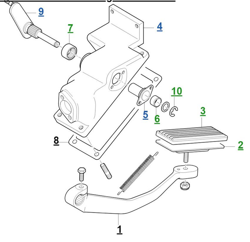

Remember I bought this car disassembled, and have never assembled an E-Type before. I can look at the Plate for it, which makes it easier to guess what goes where, and then think I can assemble.
But my main issue is that most of the special grommets and washers and pins and pivot pins etc. are missing. Is there a kit available? Or is my best bet to buy a used similar and take from that? Or?

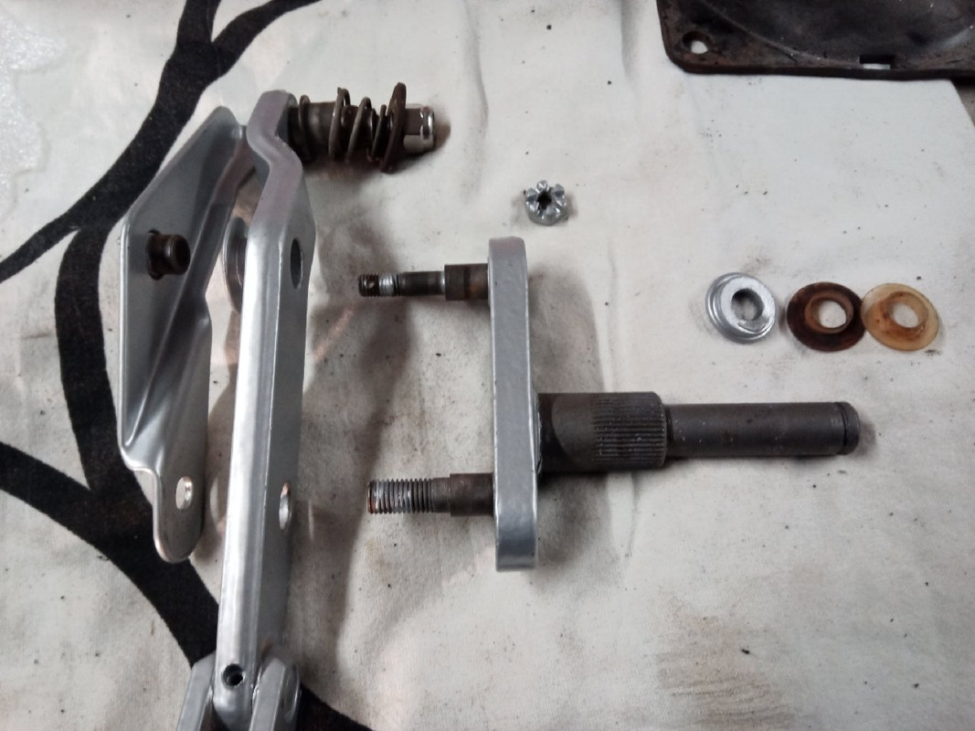

Found some parts, so most is assembled now. But the (on Plate 26) 9, 11 and 17, how are they to go together? The only thing I can see from the plate that I don't have is 13, C17239 Rubber Buffer?
The two nylon bushes, go on lower axis, right? What is the metal thing next to them, cant find where that goes?
Any picture, close up, of this assembled correctly?

What you have there are some pieces of the brake controls and Kelsey Hayes booster system. Do you have the rest of it?

I have it all now that I sorted it with the help of some emails with pictures I got. Thanks
