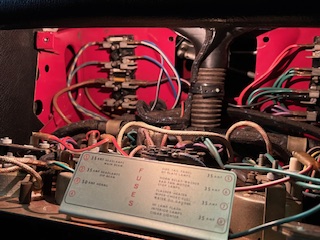

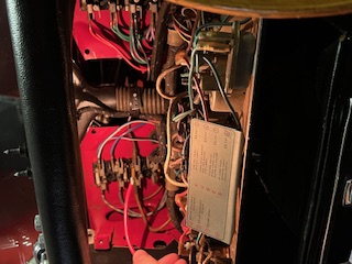

If I connect the positive cable directly to the 50amp terminal 3 (horn fuse) it ran for once (now will not run). See photo of the location I connected for the test.
It appears athat the pump needs a lot of amps to run - more than 50amps. Is this correct?

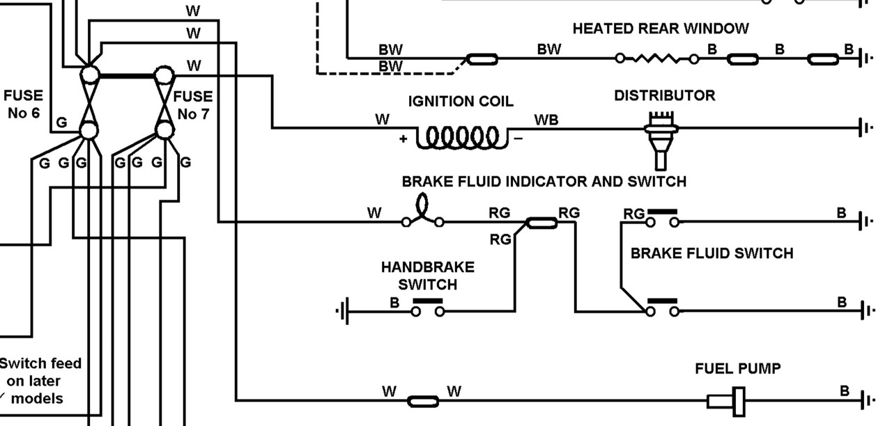

Looking at the wiring diagram for series1 4.2,i7 the fuel pump comes from the output side of fuse number 4 and should be white/ purple or am I losing the plot

Are you looking at the earlier 3.8 diagram....Steve
#10 Re: SU Fuel Pump Electrical Issues
I have the coventry auto components enlarged wiring diagram for the series 1 4.2 which shows the fuel pump fed from fuse no 4. I have looked at the green service manual and this shows it unfused as you said, I assume the coventry autos wiring booklet must be wrong, although if you look at the fuse data plate that SNG sell for the 4.2 it shows fuse 4 supplying the fuel pump. Very confusing

Having looked at 3 of the 4.2ltr wiring diagrams, within the technical section here, all indicate fuse no.6

You can say "fuse 6", but remember you are coming off of the unfused side of fuse 6. It's the green side which is fused, not the white side. The white side is just another connection link in the chain.
#13 Re: SU Fuel Pump Electrical Issues
Already mentioned at #7 above.

It would seem that the booklet I have is incorrect,
https://www.autosparks.co.uk/jaguar-e-t ... on-booklet
But regardless the problem is still the same, a corroded joint on the cable from the fusebox to the fuel pump causing a drop in the voltage
