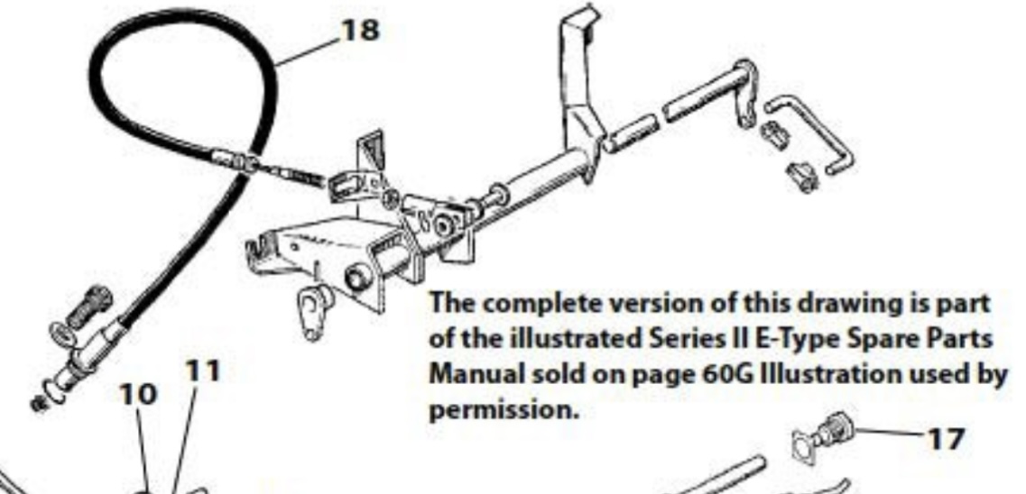

Dale,
There’s some information and photographs here, if it helps?
https://forums.jag-lovers.com/t/kickdow ... g/367236/2

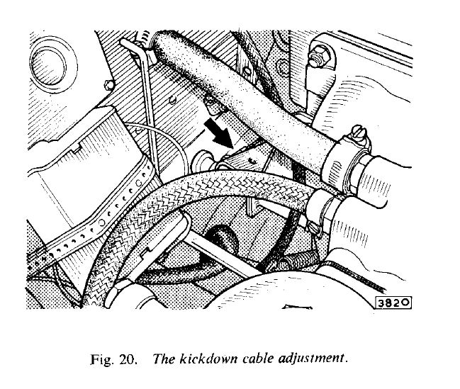

#5 Re: Automatic kickdown shaft
This is the picture from the Service manual dealing with adjustment of the kickdown cable.
It might give you some idea of how it's mounted.
At a guess, it looks like it might mount on the rearmost lower inlet manifold stud...

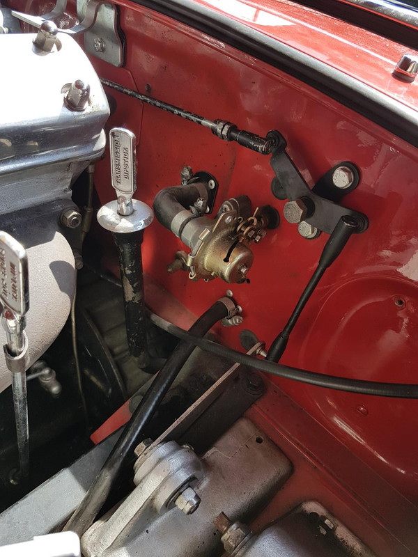

My car has the Fed setup and the shaft mounts under the main inlet manifold and uses 2 of the lower studs of the secondary manifold that pass through the main manifold as one of the mounting points the other being the bracket at the bulkhead end which slips over the lower manifold stud. I just took my secondary manifold off to try to get a photo but not much help.
This shows the shaft in place and one of the stud holes in the main manifold.
This shows the upright bracket mounted on the lower manifold stud.
If you slip your shaft onto the lower left manifold stud as above it should become obvious where the other attachment point is. You might want to train a mouse to use a spanner as space is very tight.

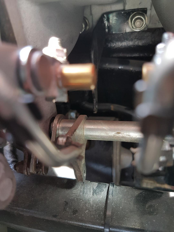

Thanks for the advice everyone, I managed to figure it out. The captive it’s I referred to are infact captive spacers so the kick down shaft does bolt onto the inlet manifold studs .

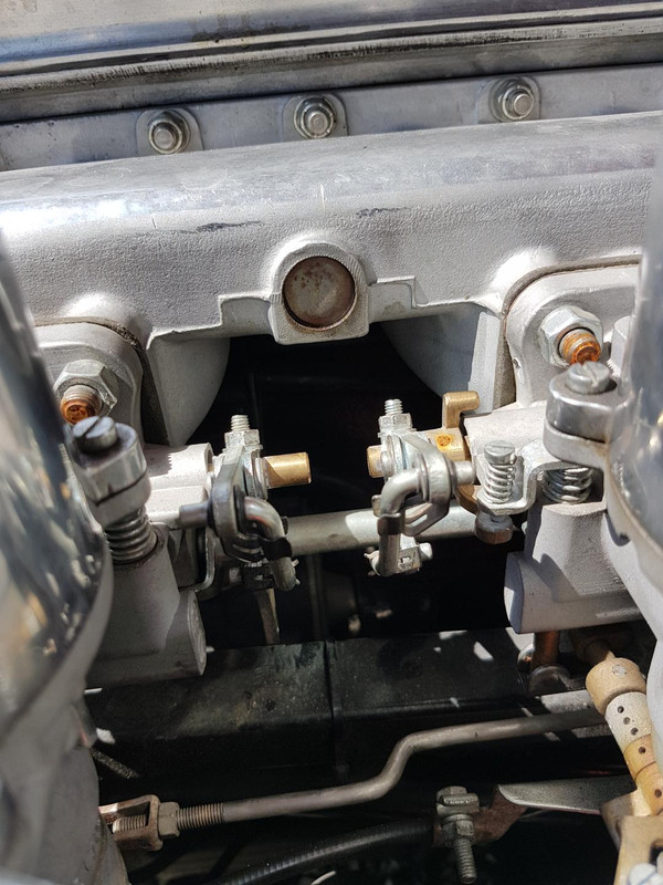

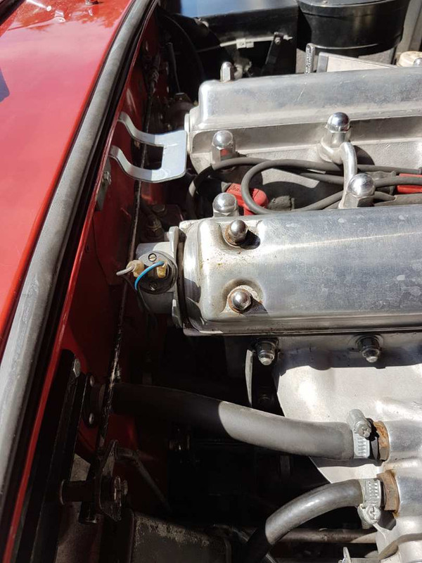

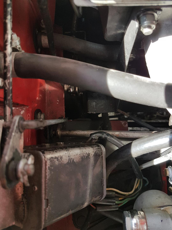

#10 Re: Automatic kickdown shaft
Sorry to jump in late - I have made these mchanisms before. Here are the phtos of the mounts on a 3 carb S1 2+2.
