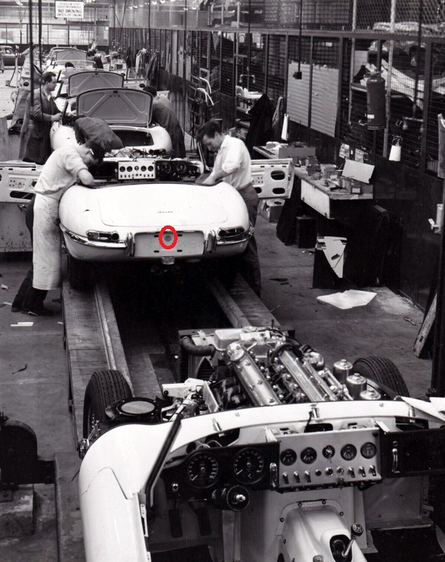

Does anyone know how the rear number plate C18921 looked like?
It's listed as standard equipment for 3.8, later as an optional extra for 4.2
There is a puzzling hole in the middle of the rear license plate place:
What is the purpose of this hole??
I think it's usually covered by a grommet, but I cannot find the PN for this grommet.

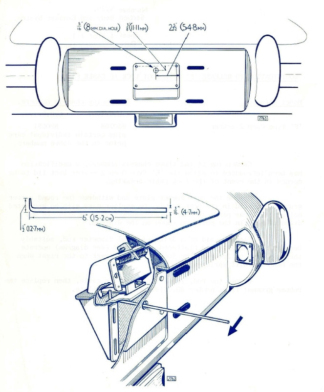

I think you’ll find its to gain access to the boot lock mechanism for when the cable snaps …….

rfs1957 wrote:
Thu Apr 11, 2024 8:05 am
The central rubber plug is C5648 3/4". It's not listed (for that purpose) in the SPC.
The 4 rectangular rubbers Tim pointed out are BD6581.

Posts: 15193
#6 Re: 3.8 / 4.2 Rear License plate & grommet
Post by Heuer » Thu Apr 11, 2024 1:16 pm
The oblong rubber plug is for the bonnet valance, to cover the slot where the US tilting number plate mechanism fits. All cars where fitted with a rubber plug BD20989 sealing the aperture in the bonnet under-panel which was removed and replaced by grommet C4548 when the tilting number plate assembly was fitted.

#7 Re: 3.8 / 4.2 Rear License plate & grommet
Post by ysmalkie » Thu Apr 11, 2024 2:28 pm
Thanks David,
I am taking about the hole circled red, rear of the car of course.
This may not be present on early cars though.
BTW, for the front bonnet oblong hole, plug BD20989 & grommet C4548 were too short for me.
The C4548 was good though for the handbrake cable grommet in the tunnel. :-)

Posts: 15193
#8 Re: 3.8 / 4.2 Rear License plate & grommet
Post by Heuer » Thu Apr 11, 2024 2:52 pm
The presence of the round hole depends on the production date:

#10 Re: 3.8 / 4.2 Rear License plate & grommet
Post by ysmalkie » Thu Apr 11, 2024 7:35 pm
Well,
My car (889348) is a FHC and the hole there is 3/4", not 5/16" - but I guess it's not that big of a difference :-)
