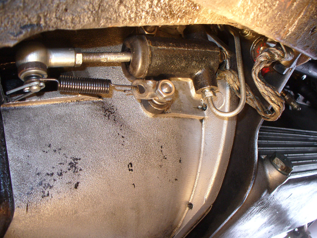

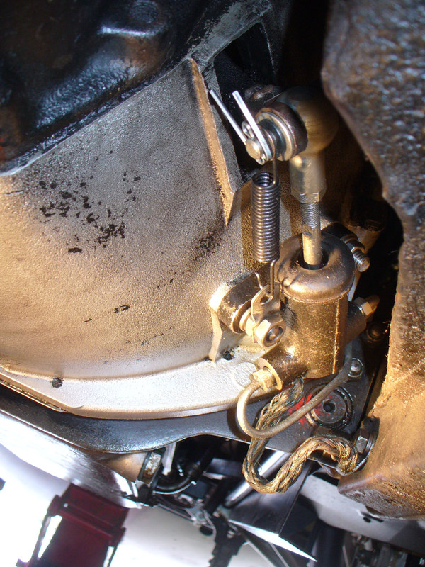

I had my son press the clutch pedal while I was under the car. No problem with it fully extending but when he takes his foot off the pedal it is taking a few seconds to release fully.
Clutch master cylinder and slave are new. I have the spacer between the master cylinder and the pedal box.
Does the slave cylinder and spring look correct?
Should I swap out the original old clutch hose in case it is restricting the return flow?
Worth re-bleeding- although no issues with clutch disengaging.
Bigger return spring?
I swapped the feed to below the cylinder so I could bleed it from the top- hopefully not caused any other issues.
All suggestions welcome and apologies as I got a bit lost with the clutch slave cylinder versions.

The return spring does not appear to have any tension on it when at rest with the slave piston fully retracted. You want a bit of tension present when everything is static, as evidenced by a small amount of visible separation of the spring coils. You can pivot the plate under the slave lower bolt to about a 45 degree angle to accomplish this.
Also, while you are 'here', ensure you have just a bit of freeplay (1/16" or so) when everything is at rest before the throwout bearing contacts the pressure plate. You can do this by feel (best done with the spring disconnected) or by looking up into the bell housing through the lower inspection hole.

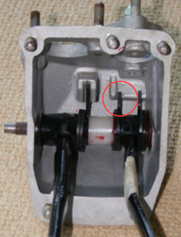

RE: Return spring in the pedal box.
Image from strip down....May have missed this. Looks like part of the return spring is broken?
Eddie

Posts: 1595
#5 Re: Clutch slave cylinder- delay in retracting
Post by chrisfell » Sun Apr 21, 2024 6:05 pm
That doesn't look broken. Easy to check, if the clutch pedal is floppy, the spring is fecked. If the pedal remains hard against the pedal box, the spring is doing its job.

You also need to trim the excess length from the split pin. That is just waiting to jam up on the casting.

Post by caveman » Sun Apr 21, 2024 7:31 pm
Eddie,
Looks like you do have a spring issue:
