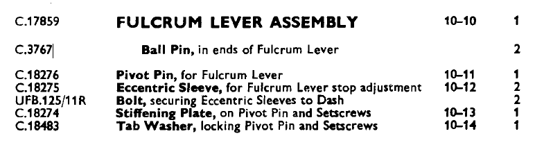

Post by ysmalkie » Tue May 07, 2024 7:49 pm
Many thanks - you mean this one - no 11 on the drawing?

Hi Tadec, the only one I can think of is on the throttle linkage pivot pin, it stops the link rattling.

Post by dxke38 » Fri May 10, 2024 9:06 am
Sorry for delay Tadec, yes thats the one. It goes on the spindle first then the fulcram then flat washer and splitpin.
