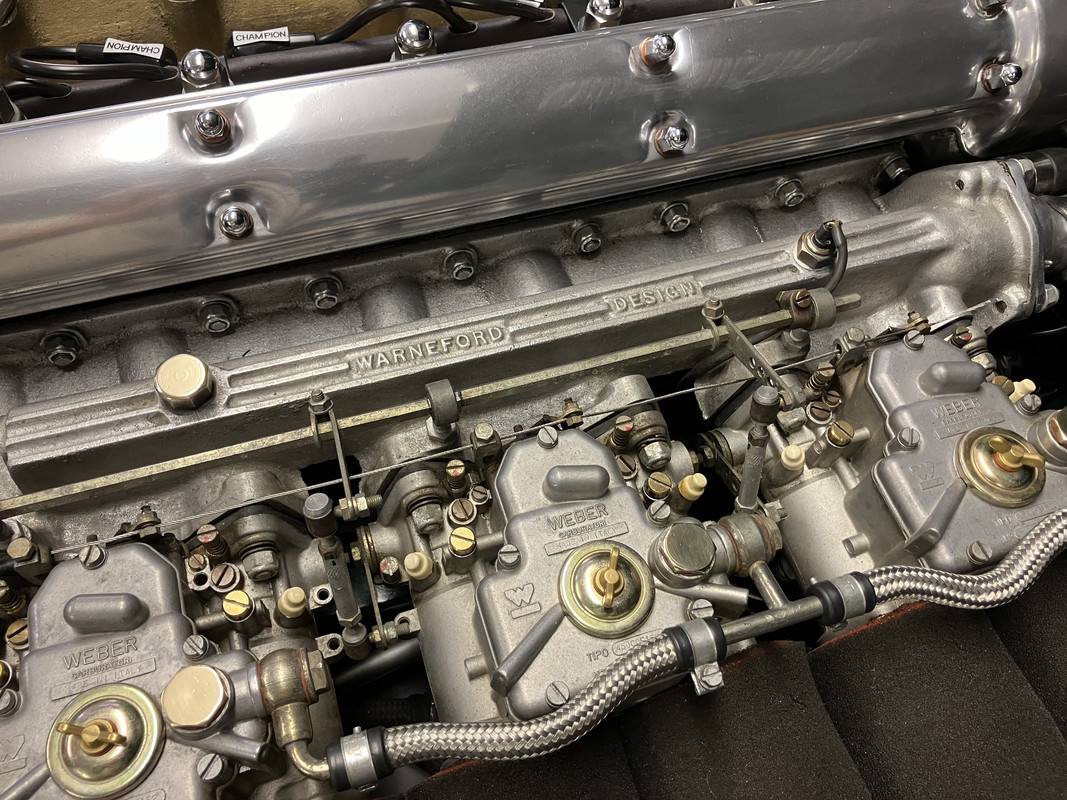

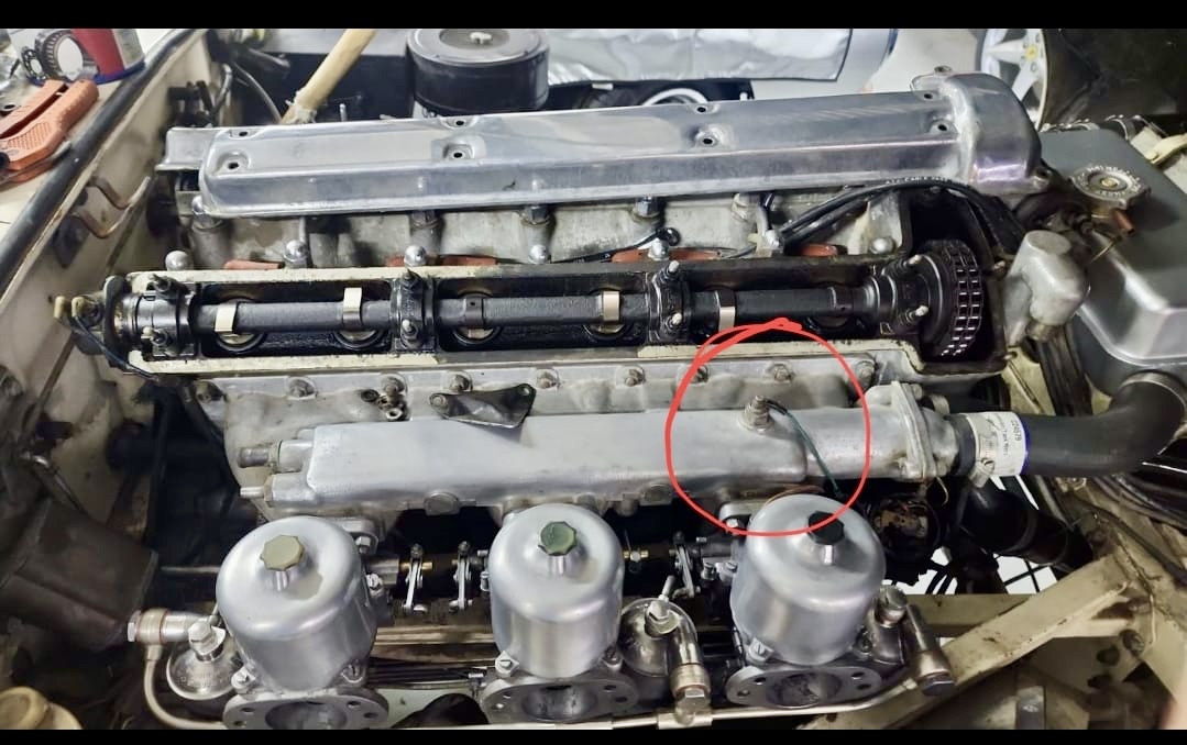

Thank you very much.! I think I got it. I just re threaded the small hole and the original sender fit right in. I think I’ll keep the original and just make a bronze cap for the larger hole. It looks much cleaner this way and I don’t mess with the cables.
First picture are the webers and the second one the SU with the original place,ent of the sender that I’ll try to keep in the webers. I really like the way the webers look….hope I can make them perform as they look !
Thanks. ,!!

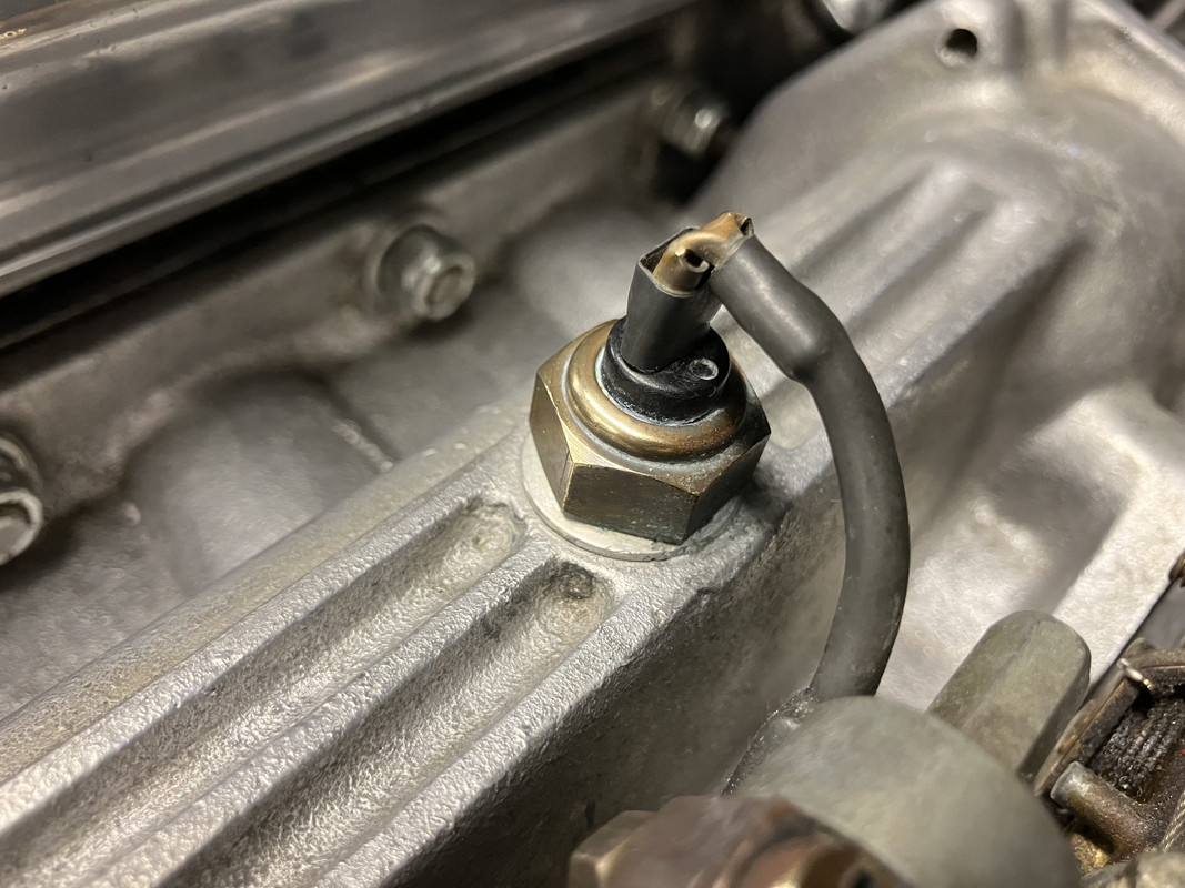

Pablo,
This is where my water temperature sensor is fitted.
Originally the wiring loom went to a sensor with a threaded stud on the top, but I changed the wiring to a “spade” fitting to suit the later sensors. I do remember that I had a lot of trouble to get a sensor that worked accurately as there were a lot of incorrect sensors being sold at the time.
