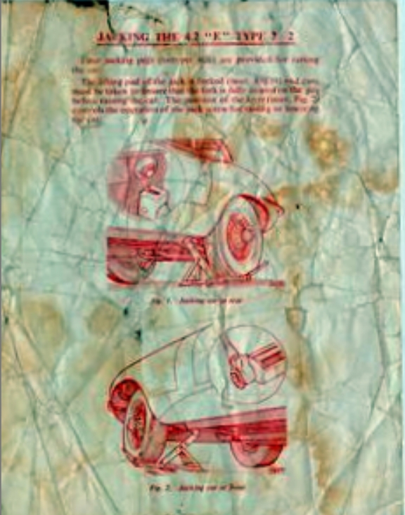

In my kit of bits I have 4 jacking cups BD28654 which I assume are welded to the floor. Does anyone have a diagram showing where these parts fit to the underfloor.
Alun

Interesting, my collection of bits seems peppered with xj6 items!
Are there specific jacking points on a series 1, 2+2 that need to be welded to the floor and are these just the wrong parts.

The part number you show is suitable for e types ( 2+2) and xk6/xjs according to the sngb site....have a look here for fitting https://forums.jag-lovers.com/t/e-type- ... ack/401379

Here's something I found in my folder for the car, so scrunched I thought it was a sweet wrapper.
