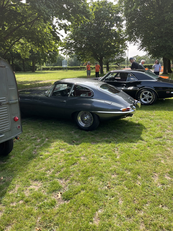

Hi all not had my car to long and thought I would just take the rear wheels off for a little clean copper slip the splines and to my shock! I couldn’t get the rear wheel off without dropping the bottom shock bolt to get more droop. The car would appear to be a little lower the standard and is running 6 inch rims with blockley 205/70/15’s. Took the shock off today and assembled its 13 inches eye to eye, when the spring is removed, the spring length is 27cm with a coil thickness of 11mm. I want to return the car to its correct ride height and also be able to get the wheels off without removing the shock bolt as that’s not a good thing if you get a puncture road side. So can anyone share with me what the standard shock length is and spring detail so I can get the wheels off and achieve the standard ride height.

Thanks guys for your replies, I believe shock length is the answer Martin Roby, told me 13.5 inches, the spring it’s self controls the ride height and as you can see in the image the car sits low, rims in line with arch, so really it’s two issues. Both MR and SNG sell a standard shock /spring assembly giving”standard” ride height but will that give the droop required from the shock length, what I need is someone who’s had the same issue, other than that it’s purchase one to see if I get the droop required, just the extra 1/2 inch doesn’t seem enough

Rear ride height with standard shocks is a function of spring strength.
All shock length affects is the maximum droop on your suspension with the car in the air. So yes, they may affect your ability to remove larger tyre/rim combinations. But it doesn't affect rear height at rest.
To get your rear ride height correct you need a stronger spring or to fit packing pieces (sold by the usuals) between the shock absorber spring land and the spring.
