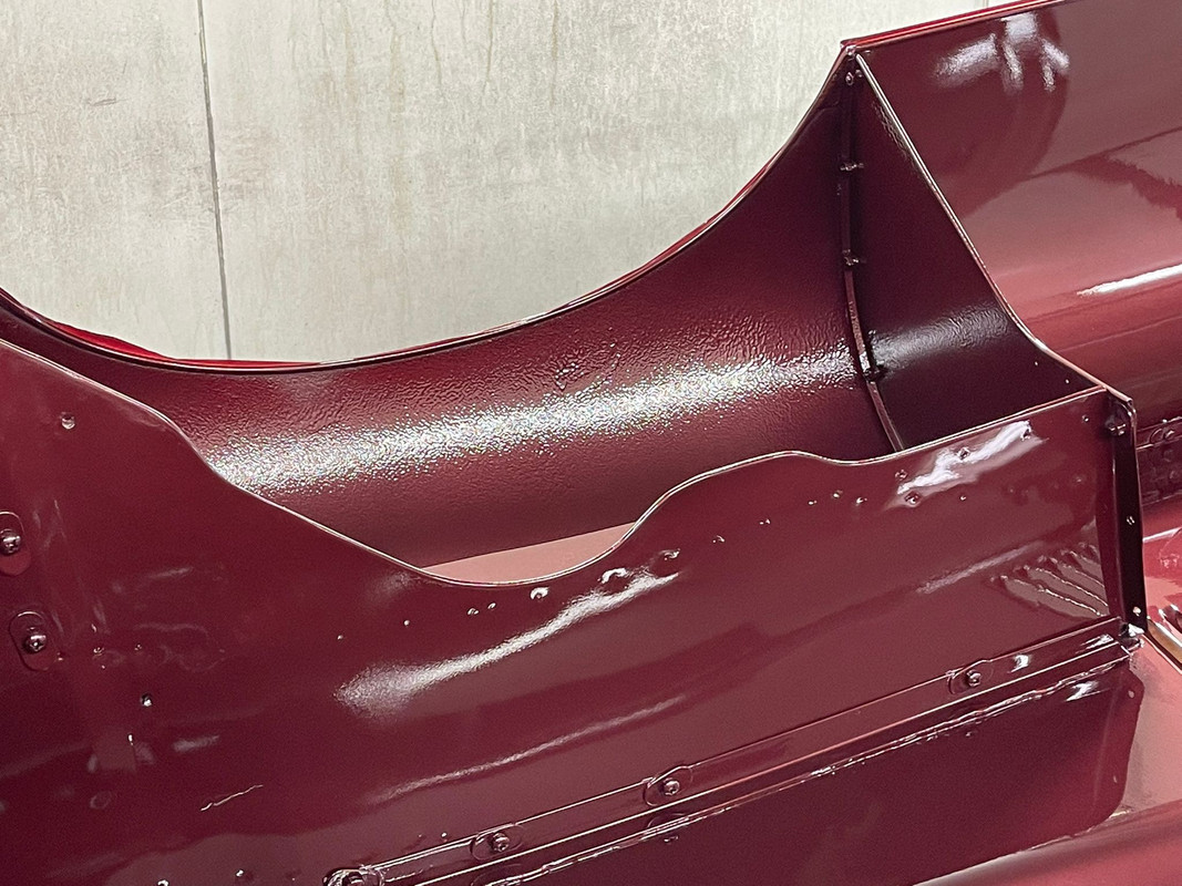

This was mine when I had a repaint. I think it looks right

I think it’s just basic stone chip - nothing special. Applied on the inner arches only.
Was originally coated in thick underseal - scraped off by myself with aid of a heat gun and gauntlets and then taken to bare metal.
I also removed the wheelarch panel to get all of the old mess out of the way.
Hope this helps
Tim

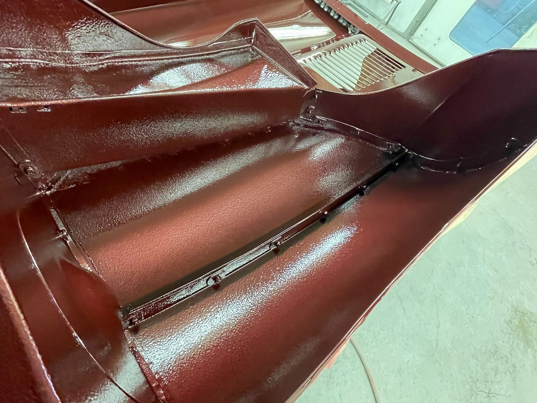

My coupe has a stone chip (body colour over) in wheel arches, floor and kinda “blended” as the sills curve under the car..really good
My OTS has a smooth tough coat with body colour over which seems good …I’ll find the name of the product this week and let you know
