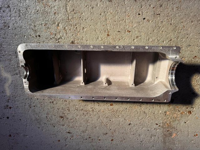

I have just received a new 3.8 smooth sump from SC Parts.
Ordered and delivered in 2 weeks so very happy.

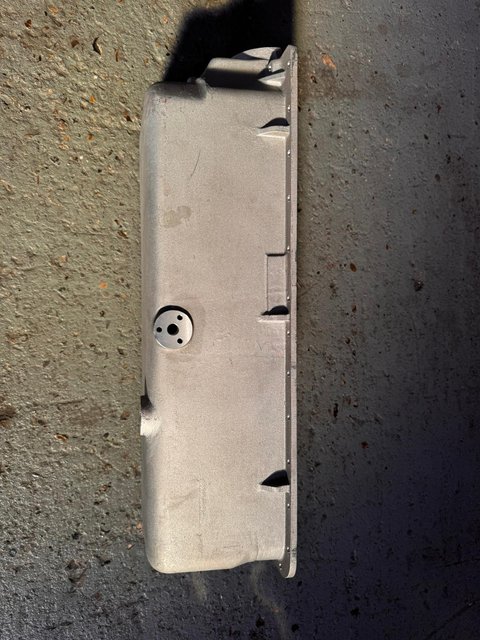

It looks to me like you have bought one with the bottom drain which you mentioned earlier was very vulnerable due to the low clearance on our cars. Will it fit your car as I cannot see any clearance for the torque reaction plate at the rear. Was it at a bargain price, I guess not?

That sump is for a J60 military engine, the rear half of it is slightly angled to allow the drain point to work. If you weld up the current drain hole and weld in a threaded boss at the rear to mimic an original 3.8 sump it won’t drain all the engine oil.
The E type baffle will need modifying as it fouls the bottom of the sump at the rear

The rear seal area looks different to what I would expect. The 3.8 seal was a single smooth area - unlike the later different diameter 4.2 sump with has the seal set into a groove.
The sump supplied appears in the photo to have an additional “step” machined in towards the inside of the sump. Either way, the sealing of the rear sump will need to match the crank bearing housing diameter to which the sump seals against.
The photo below in this previous post shows the difference between the 3.8 and 4.2 sumps in my post #4, but more importantly, the single rear seal area. The post #3 may be of interest where Andrew states he had been sent a military sump, but it had been machined to mimic a 3.8 sump, plus the consequential issues he was trying to resolve. This would explain the machined profiles in that area on your sump.
viewtopic.php?f=3&t=10102&p=80139#p80139
As the item would certainly not be cheap, it needs confirmation of these seal areas match your particular crank bearing housing as my photos in post #4 show the differences in the longer 4.2 sump seal area on the bearing housing, compared to the shorter length of the 3.8 sump. Military sumps used to be fairly commonly available from engine builders or online and were distinctive as they tend to be painted military light green.

There are some good photos of a 1962 smooth sided sump - and especially rear machined seal area on an original 3.8 sump in post #10 - in Rory’s recent post regarding the issues around getting an effective seal on that area at the rear of the sump.

I wouldn't believe a single word of anything that SC Parts said to me.
Especially "made to order in 6 weeks".
Made to order, but with drain plug in the wrong position, and rear-seal machining that is not like a 3.8 ?

Still, that smooth sump is not a look alike original 3.8 smooth sump...

My car is A 62 with late October mfg date with orig engine. Drain is on pass side, side of pan, toward rear of pan, rough finish, smooth rear seal surface.
