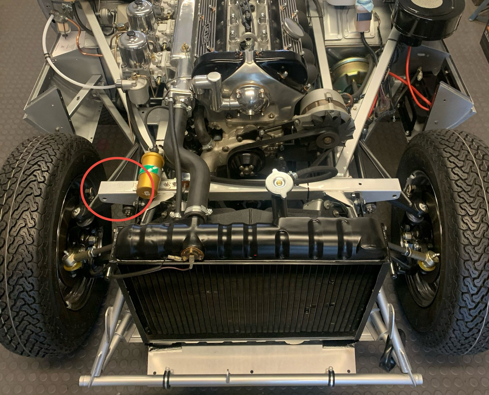

Hi Johnathan,
Whereabouts are you looking? The VIN, or Car Number is only stamped in one location and that is on the top RHS of the Picture Frame. I’ve circled the area in red, below:
The number should read something like 1E18XXX, where the XXX are unique numbers to your car.

#3 Re: Locating the VIN/Chassis Number
Of course it is stamped in another place and that’s the ID Plate along with all the other numbers for your car, but I presume your plate is missing?
