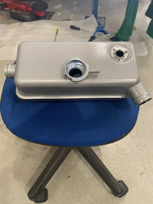

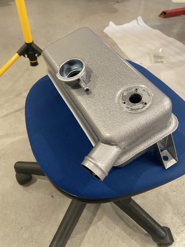

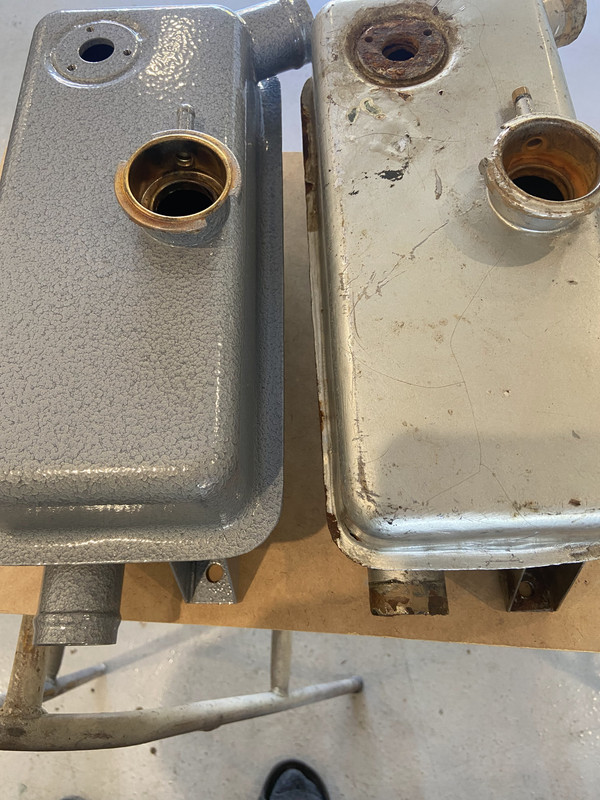

My car is Oct 27 build …..
I bought a repro header tank and removed most of the flange …re welded and pressure tested to 30psi

Interesting as a cheaper option than the nice Angus copper version (maybe but your personal manpower).
An interesting discussion on Jaglovers wrt the corrosion of the metal parts in the cooling circuit.
Mainly related to aluminium rads and grounding, but it is worth reading (albeit sometimes repetitive) as we know that the issue of steel header tanks is the potential rapid corrosion:

I will ask Angus about his header tank, looks like the way to go if he still makes them.
I did think about cutting the flange, I’m sure thats been done before also it looks ok.
