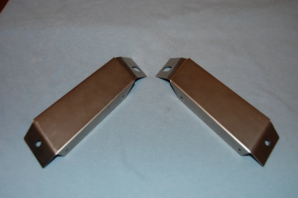

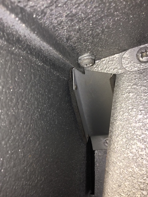

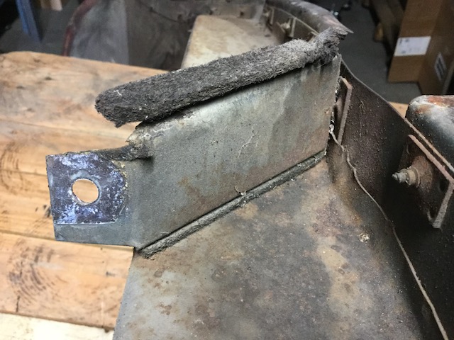

Mine half dismounted (photo #2)
and reassembled in position (photo #1).
Note the foam seam on top and bottom.
Philippe
