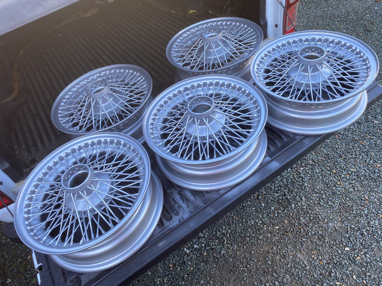

We can supply Borrani wheels, but do be aware they dont come cheap. There are however soem fantastin production wheels available from companies like MWS.
Don't be fooled by tubeless wire wheels. Just fit inner tubes. (you can fit a inner tube that has been made to be tubless, we strongly advise it. you can also fit an inner tube in any 185R15 tyre or 205/70VR15 tyre regardless of weather it is called a tubless tyre or not. in fact we strongly recomend it)
dont fit tyres below 70% profile.
if you have one slightly loose spoke the whole wheel needs rebuilding or replacing. (for an e-type we say repalce they are such good value.)
wide wheels and tuyres are a vanity thing, if you like the look that is one thing, but in truth the car makes a much better road car on a 185VR15 tyre. Norman Derwis said so. that is why they didnt fit them on the e-type untill the V12. Norman Dewis did the testing. I talked to him about it.
currently the best tyres are the 185VR15 Cinturato CA67 of Michelin XVS. we have these and Michelin inner tubes available at Longstone tyres.

#12 Re: Wire wheels, an idea. Your view?
Thanks Dougal, right now I'll try to save and use the originals
