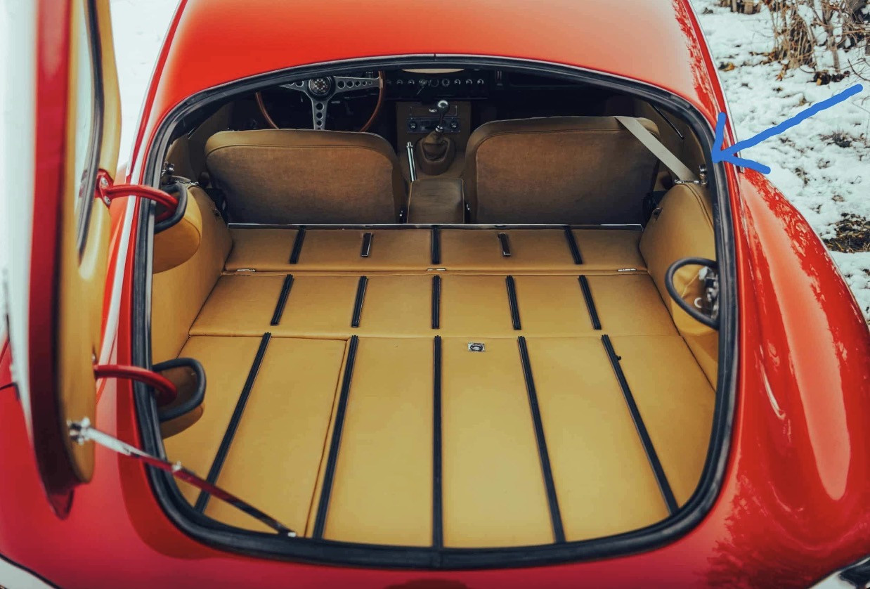

I’m the proud owner of a Series 1 4.2 FHC, which I’ve been restoring for the past five years. I’m finally nearing the finish line, and this forum has been an invaluable source of information and advice throughout the restoration.
However, I’ve been stuck for several weeks on one last detail. I simply cannot install the hatch seal that fits onto the body aperture. The PVC seal I purchased from SNG Barratt is far too stiff and is almost impossible to fit around the curved sections.
I’ve noticed that some cars appear to use a much softer seal, but I haven’t been able to find a supplier that sells this type.
Does anyone know of a supplier offering a softer hatch seal?
I’ve attached a photo to avoid any confusion about which seal I’m referring to.
Thank you in advance for any advice.

Have you spoken to COH Baines? They make lots of very good seals

Same issue here its not a seal its a trim piece.BD39105..you need to look for old stock..new after market is way too hard ..ps you could try soaking it in hot water? Or try the trimmers see what they use..Aldridge BAS etc viewtopic.php?f=3&t=22097&p=177929#p177929

Thank you for your feedback.
I contacted Baines, but unfortunately they do not supply this part.
I’m going to try Aldridge, as I actually bought the interior trim kit from them.

Odd. I've fitted any number of the seals from SNGB and they've always been fine. They're not PVC but soft rubber.
Have you reached out to them?
Alternatively try David Manners.

No, not directly. I simply ordered the part number online.
It can’t hurt to contact them, so I’ll give them a call.
